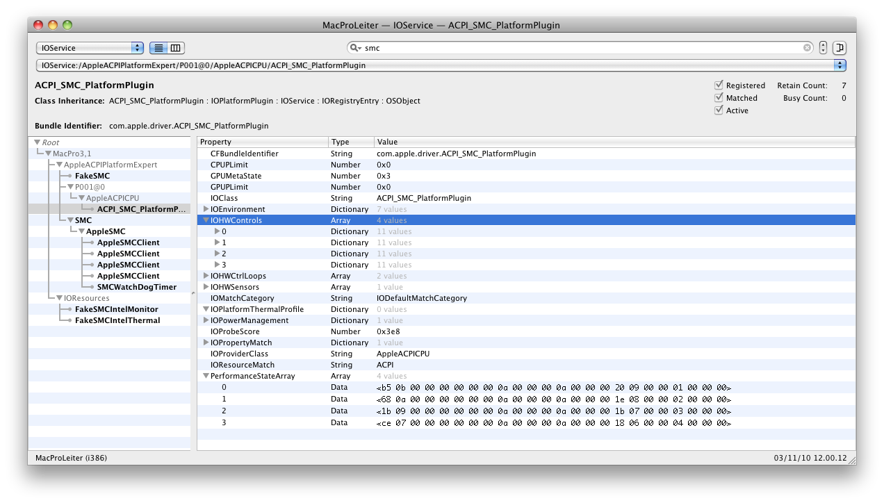

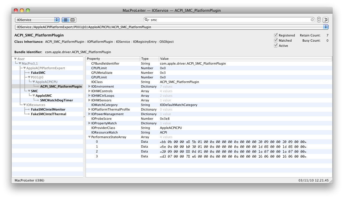

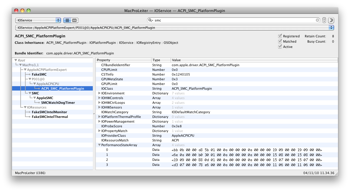

I'm running Cham RC5 r619 and I'm trying to make speedstep work togheter with an Intel C2D E8400.
I dumped ssdt from linux and attached SSDT-x.aml on root.
Now the real problem is about P-states definition and a correct speedstep for my CPU.
I'm trying to get things better, just because my real problem is that I have 5-6 degrees of temperature gap between W7 and the hotter SLeopard, so this means that I'm not running the right (or the best?) Vcores in my P-states.
In every cases I set my model identifier in /Extra/smbios.plist as a MacPro3,3 (or iMac9,1), if not I've got no speedstep, no matter if P-states are there even from Ioregdump or VoodooMonitor it doesn't step.
No dsdt pstate editing.
This is about my E8400 speedsteps:
1.
ChamRC5 C-states generate = No
ChamRC5 P-states generate = Yes
20 09
1e 08
1b 07
18 06
2.
ChamRC5 P-states generate = No
20 09
1d 08
1a 07
16 06
So my point is that Cham RC5 is generating higher cores voltage then those generated "vanilla", with no dsdt pstate editing.
And more, I need of vcores even lower of the vanilla settings. Following W7 vcores pstates instead, *should be*:
19 09  1112 mV
15 08  1075 mV
15 07  1037 mV
11 06  987 mV
Is there a way to customize pstates vcores on ChamRC5? If not, this should be a request.
Thanks for your precious work!

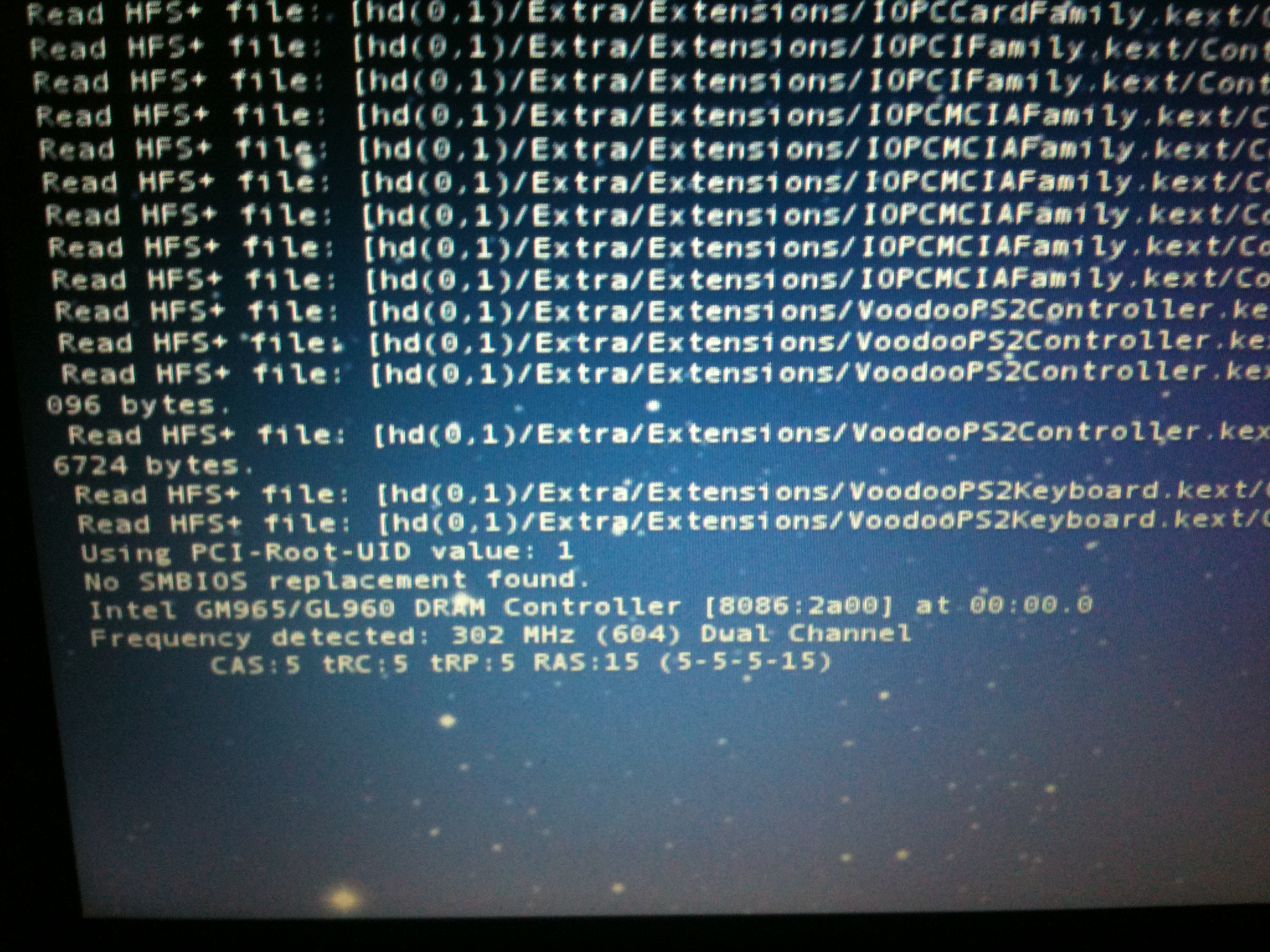

Well, amn't sure am on the right track but here we go:
* I have no HPET mods in DSDT.
* Added the two Generate states to my boot.plist file and DropSSDT just in case.
* Added ForceHPET=Yes in boot.plist since i don't have it in Bios.
* I can see that AppleLPC is loaded in About this Mac > More info > Extensions, and also inside of ioReg.
* In SMBios.plist i have it identified as MacBook2,1 as that's the most similar CPU inside of my laptop (T5670 1.8Ghz), yet i have to add MaximalClock=1800
because it's being identified as 1.6Ghz without it.
Now, it boots up with no problem but:
- Memory speed is identified as 600Mhz instead of 667Mhz.
- When i tried to remove NullCPUPowerManagement kext from E/E to get the native AppleIntelCPUPowerManagement to load up, i got a KP.
What am doing wrong?
Thanks in advance.

Hi Chaosaltar...
Did you made a complete install of the booter? boot0, boot1h and boot... Probably has nothing to do with this, just to be sure.
If you get the same result try to disable memory detection, UseMemDetect=n.
Also, do you get that hang with -f or..?
The hang i managed to reproduce on my system is at the "Using PCI-Root-UID value:..." message and combined with -f argument, like reported by others.

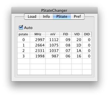

This is the app from marionez screenshot that you were inquiring about, PStateChanger. I replied to you because he did not.
Others that I'm aware of are VoodooMonitor and a paid app CoolBook.

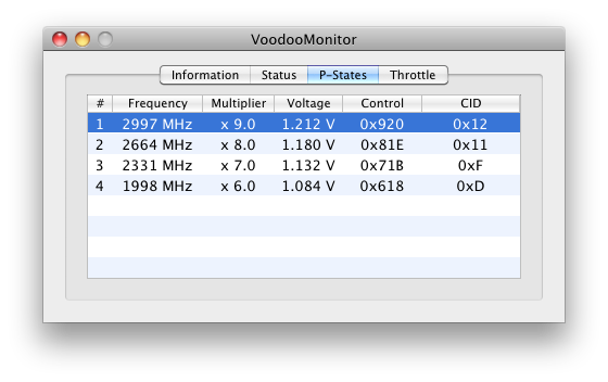

mark_i.zipIt shows very often the 3rd (2333) pstate instead of the 4th (1998).
Thanks mozodojo for your reply, I modded SSDT with those:
19 09 1112 mV
15 08 1075 mV
15 07 1037 mV
11 06 987 mV
Cstate generation = NO
Pstate generation = NO
Model Identifier = MacPro3,1
And now I've a strange situation:
IOReg take the SSDT modded values.
VoodooMonitor shows other values, they're not the vanilla one, but the same generated with the ChamRC5 Pstate generator with 0618 for the lowest pstate for example, instead of the cooler vanilla 0616 and again different from the SSDT modded value of 1116.

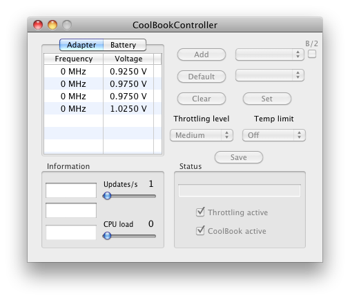

This at the end is from Coolbook! Thanks DarwinX, so here we have again new and different vcores values and no frequencies.
At the end, I'm a bit confused, all I can say is that I don't really know the real vcores values, but, with the modded ssdt I obtained a more W7-like stepping, because before this it was stepping too often on higher frequencies with the result of higher temperatures, now it's more often at 1998MHz and temperatures are significantly lower. I suppose vcores are quiet lower even if I don't have any reliable data about it.
mitch_de: do you have a more efficient software for vcore-pstates reading?
Maybe more IT: I think that a FID/VID manual tweaking should be an absolutely nice implementation for ChamRC5.

The real problem is even with 8 P-states generated, checking by CPU-i, the CPU only works at the lowest one of 'em! (537Mhz).
Here's the bdmesg log:
