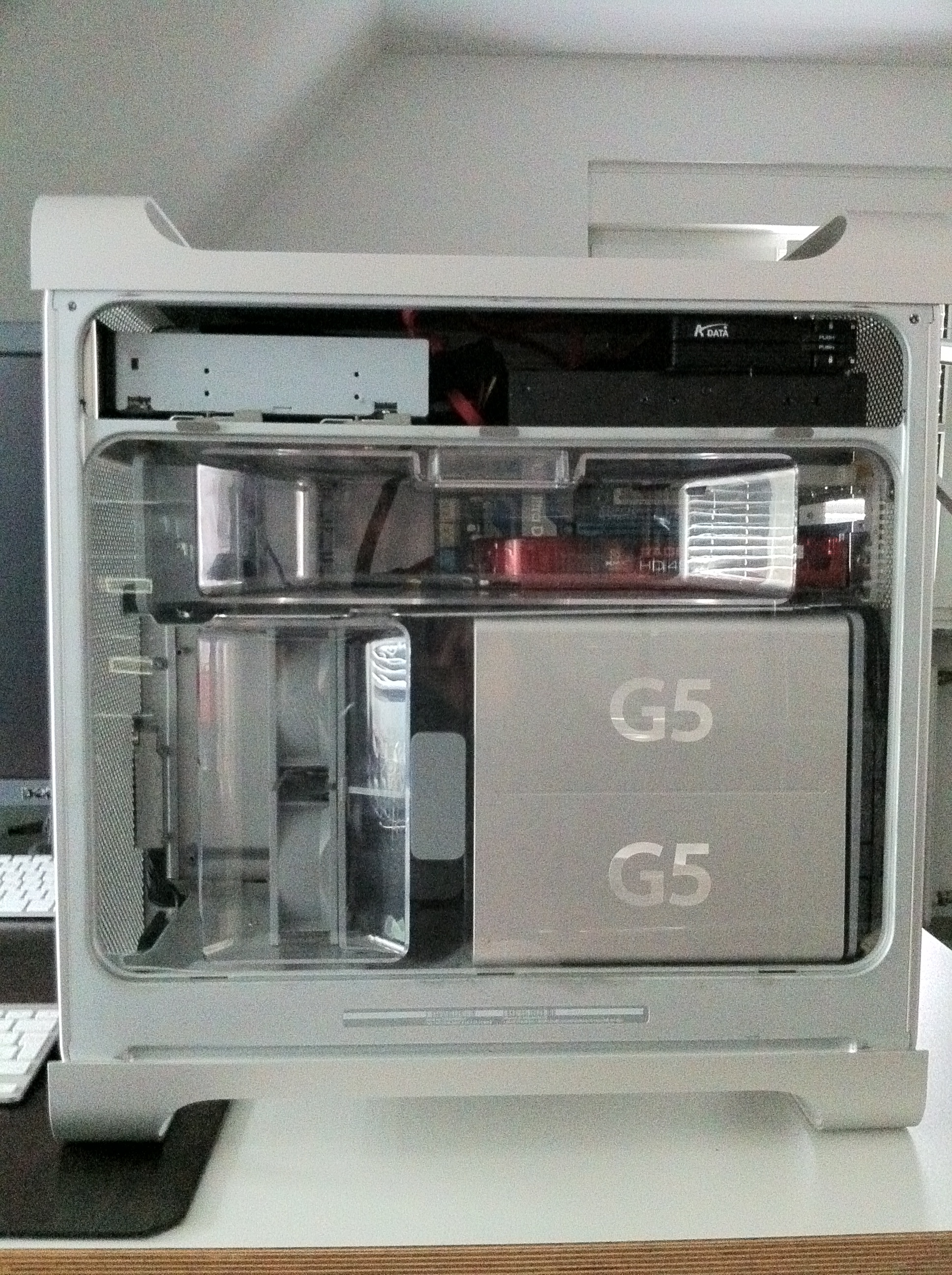

Very nice looking. Here is mine that I am still putting the finishing touches on.My specs:
G41M-ES2L
Q8400 Core2Quad
GeForce GT220 1024
4 gig ram @ 800 mhz
Genius Heatsink: works great for transcoding. My temp never gets above 103 F, with stock it was going up to 156 F
LG Disk Drive
600 Watt power supply
3 hard drives 1: Snow Leopard fully working
2: Lion fully working
3: For movies and tv shows and music to stream to my AppleTV2G with Plex

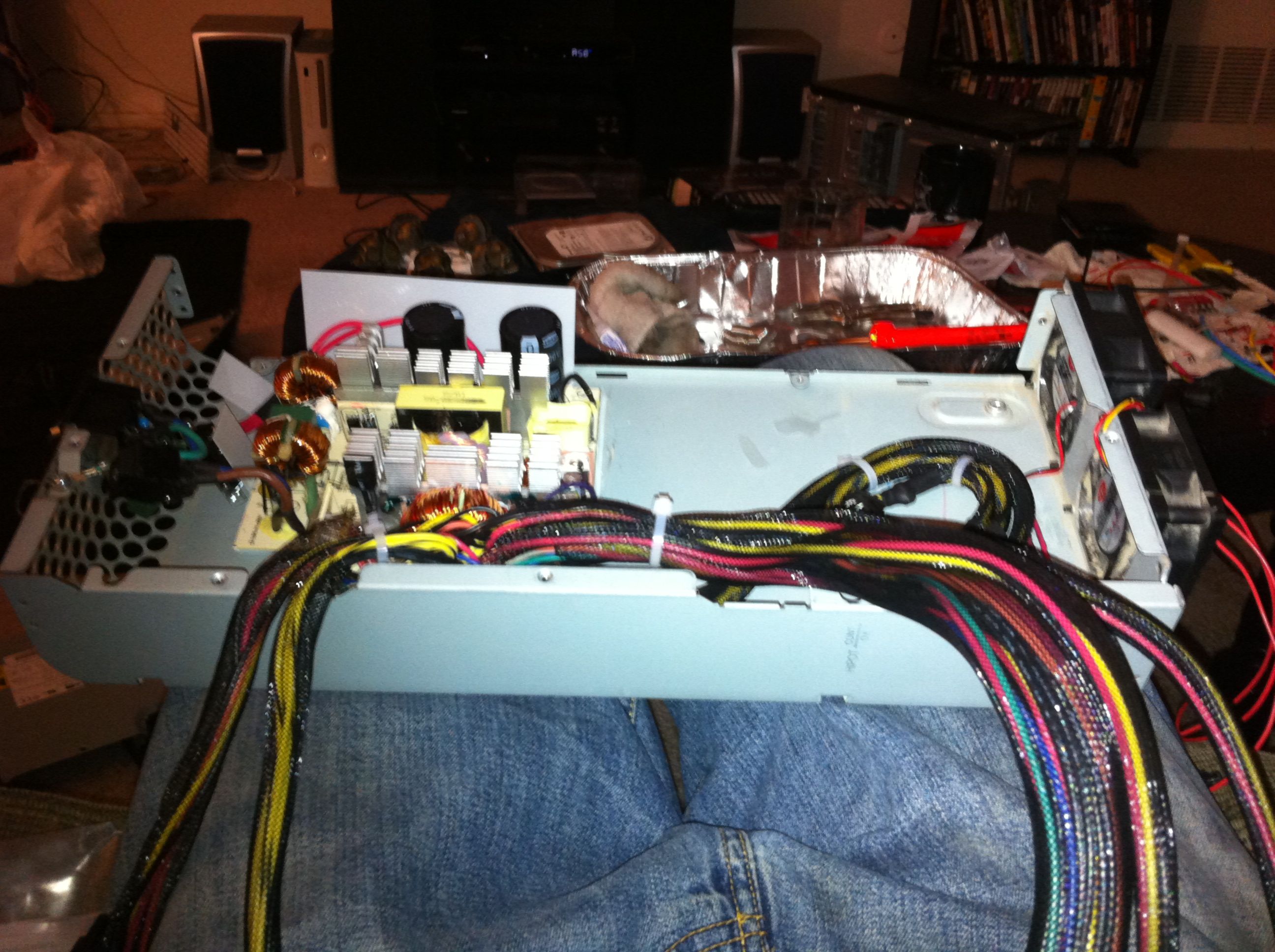

First thing I did was tear the enclosure off my new power supply and fit it nicely into the power supply box for G5

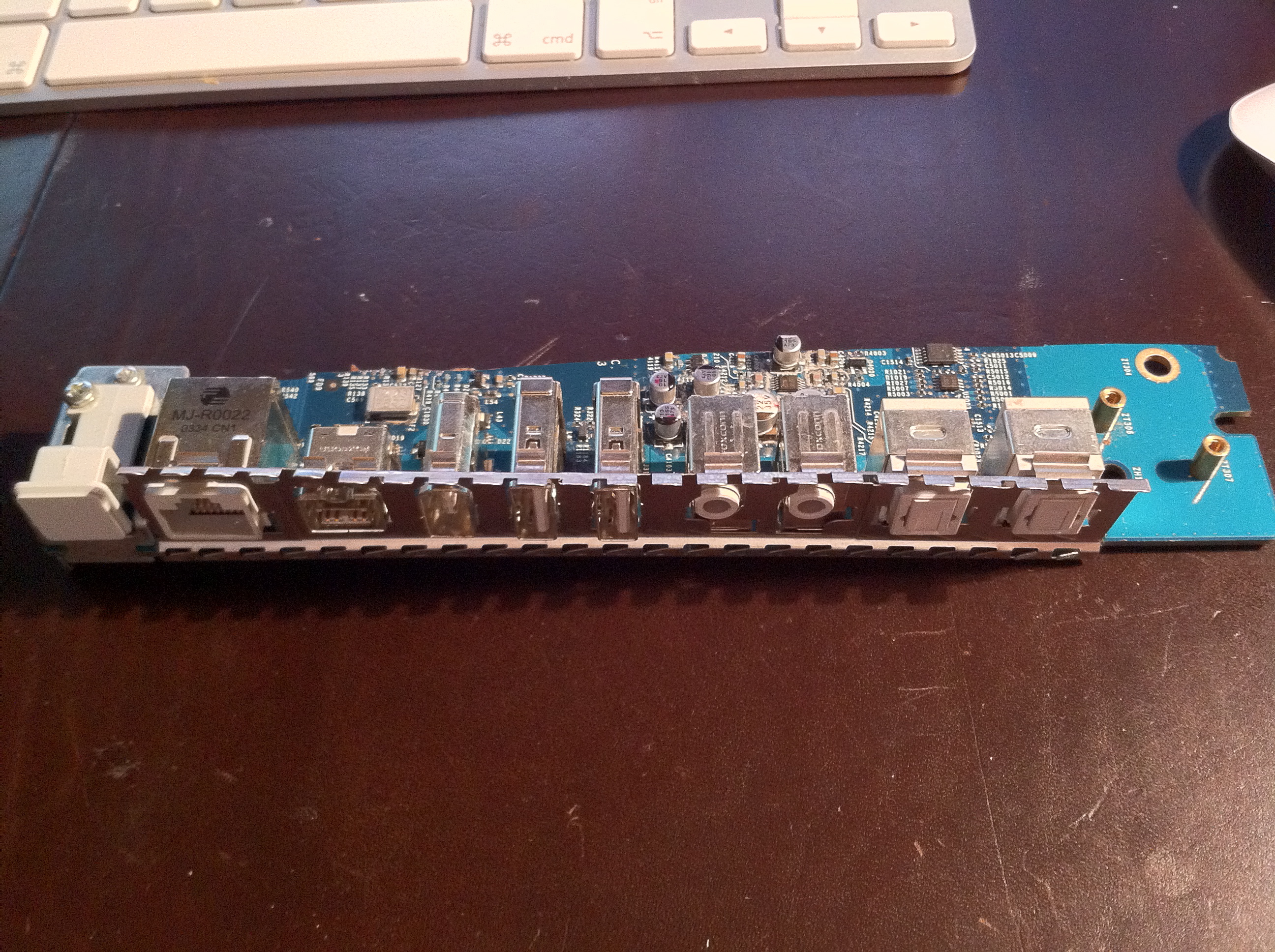

Then I used all the original ports in the back. They are all funtional except for the optical audio of coarse, and I changed the FireWire port to a 3rd usb. still got alittle work to do back there ;)
And this is the inside
I still have some wires to clean up around the disk drive, front I/O port and I need to shorten the audio wire thats sitting on the right side of the heatsink.
