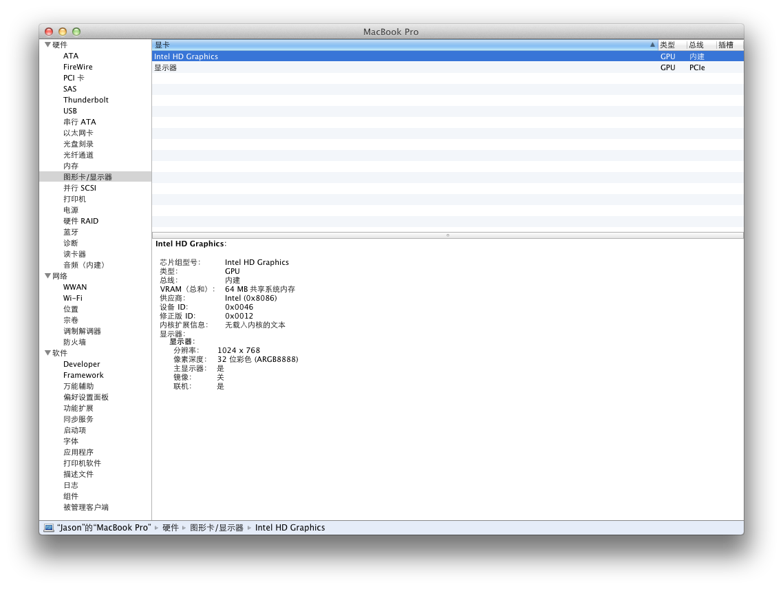

ok,this is what I have done
1. install lion DP4
2. with all other kext loaded and working perfectly
3. with chameleon installed by [url="http://www.insanelymac.com/forum/topic/279450-why-insanelymac-does-not-support-tonymacx86/"]#####[/url] 3.7.2,mac can't recognize intel hd
4. using windows chameleon with boot replaced by PCJ @ bbs.pcbeta.com (the patched boot works well with HD2000/HD3000,but not us ), mac do recognize intel hd
5. after adding these kexts, there will be distortions all over the screen (no matter which windows/mac version of chameleon, nor original boot / patched boot )。but the system do load the AppleIntelHDGraphics.kext\
AppleIntelCPUPowerManagement.kext\
AppleIntelCPUPowerManagementClient.kext\
AppleIntelHDGraphicsGLDriver.bundle\
6. if add AppleIntelHDGraphicsFB.kext\, it's not able to load the system
hope this can help

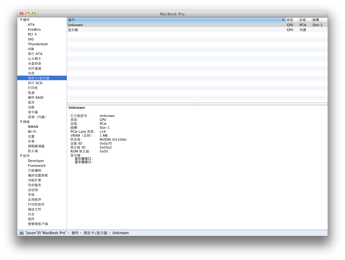

Jason Lin: i have nvidia optimus with Intel HD / Nvidia 310M
You have correct resolution, or only 1024x768? you can try to switch between videocard with gfxCardStatus?
You can get nvidia card to work?

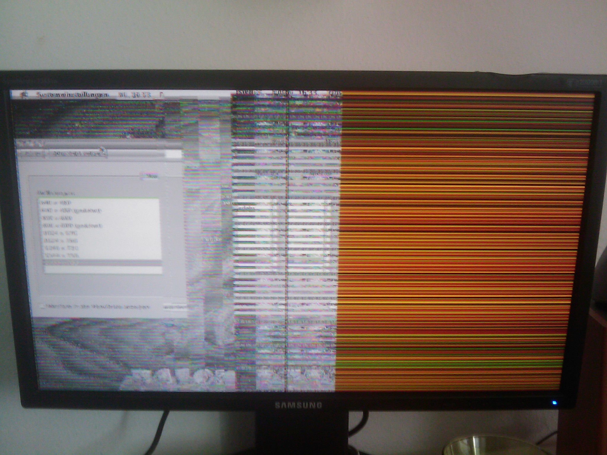

Hi,
if you can see in the attachment, i have a disturbing Desktop ... but i have Custom Resolution ... BUT only up to 1366*768.
I have installing my MacOS in this steps
1. [url="http://www.insanelymac.com/forum/topic/279450-why-insanelymac-does-not-support-tonymacx86/"]#####[/url] + MacOS Retail 10.6.3
2. Update to 10.6.7 (no reboot)
3. [url="http://www.insanelymac.com/forum/topic/279450-why-insanelymac-does-not-support-tonymacx86/"]#####[/url] (with System Definition MacBookPro6,1 !!! (I Think it's important, because in the AppleIntelHDGraphicsFB.Kext it's a function to check the OS-Info for one of MacBookPro 6,1/MacBookPro 6,2/Santa Rose Plattform)
4. Reboot and use the VGA-Port for the Monitor (i haven't buy a hdmi-cable ^^, yet)
At the boot it's strange ... the Laptop TFT is first off .. if it's start die MacOS UI the Backlight goes on. So I think, the Driver check all available Display-Port but send information on the wrong one. Like an Address-Problem. One more Sign of this is the Max Res. i get ... my Laptop (1366*768) my Monitor (2048*1152)
I hope i can get some new inspiration to solve this problem :P
My Laptop: Lenovo Ideapad U160 - Core i7-620UM

Yeah I explained this a while back. If you connect your laptop to an external monitor, meaning using the VGA port, you should be able to use custom resolution. The internal screen however is all black and can't be used.
The idea of editing the connector info that was introduced for the Intel HD Graphics 2000/3000 is interesting. Someone can maybe study that for us Intel HD Graphics (Arrandale)?

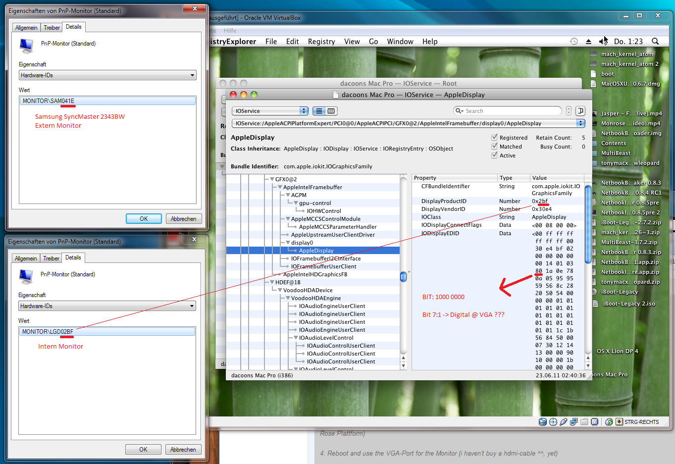

Hi,
i have check some data from IOReg with ProductID und EDID Information. At the attached Image you can see my Display is recognized as the Internal one, but the image came to the External. Also the data is sending as Digital to the VGA-Port :D
So I think is one more Sign for an Address-Problem :P

Hi,
i have check some data from IOReg with ProductID und EDID Information. At the attached Image you can see my Display is recognized as the Internal one, but the image came to the External. Also the data is sending as Digital to the VGA-Port :censored2:
So I think is one more Sign for an Address-Problem ;)
