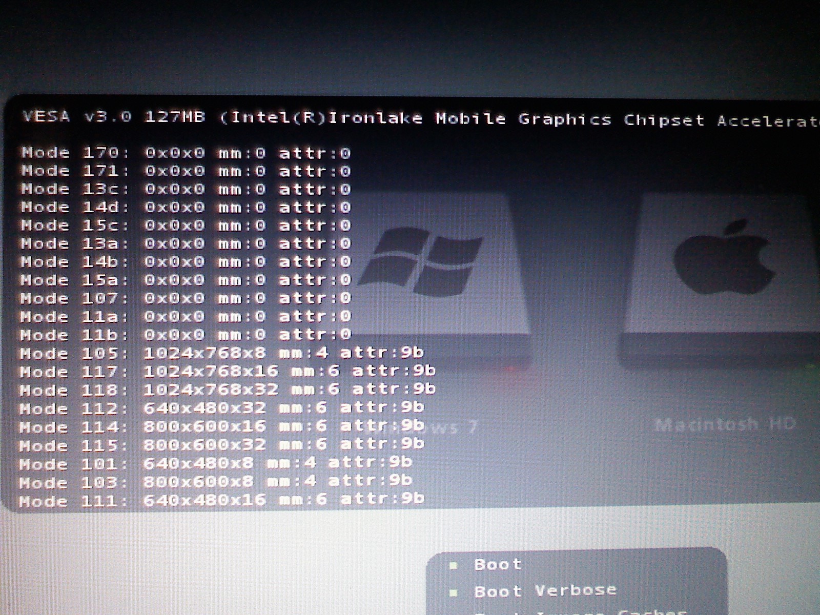

hi,
ive got a i5 system with Intel HD graphics (8086,0046) & ATI 5650m.
I'm trying to get ati kext loading for my system but the only thing i got is the intel hd graphic loading (without kext) but with the framebuffer of kabyl (boot chamelon 749 for ati & patch) i ve got the good 1366x768 resolution on OSX.
(you have to add lines Graphics Mode to 1366x768x32 in boot.plist)
It's a good news for resolution but i want to get my ati kext loaded (ati card posted in the bootloader)
See other post here:
http://www.insanelymac.com/forum/index.php?showtopic=252878

That's pretty interesting. Probably the reason why you have native resolution is because your ATI Graphics Card is loaded on Chameleon Bootloader, which allows it to read the EDID of the laptop screen and gives you 1366x768. From there, that info is carried over to OS X.
Has anyone ever tried to patch Chameleon Bootloader RC5 to detect our Intel HD Graphics (Arrandale)? :boxing:
The VESA driver that comes included in the bootloader does not support our integrated graphics. And if you noticed, the chameleon bootloader resolution can only use 1024x768 which is telling us that the EDID isn't being picked up. ;)
Patching Chameleon Bootloader to detect our native resolution can be a first step in order for OS X to get the EDID it needs. B) (If you try to override the EDID from within OS X, it won't work because the Chameleon Bootloader loads up a corrupt EDID info everytime we boot and then OS X ignores everything else.) :(
It shouldn't be that hard to make a patch to make Chameleon Bootloader detect our Intel HD Graphics. This is how the X4500 and X3100 guys managed to get native resolution, by patching Chameleon.
This guy helped X4500 GMA users to get native resolution. He did this by patching Chameleon. Take a look at what he did Deviato Wordpress

The VESA driver that comes included in the bootloader does not support our integrated graphics. And if you noticed, the chameleon bootloader resolution can only use 1024x768 which is telling us that the EDID isn't being picked up. :(
Patching Chameleon Bootloader to detect our native resolution can be a first step in order for OS X to get the EDID it needs. B) (If you try to override the EDID from within OS X, it won't work because the Chameleon Bootloader loads up a corrupt EDID info everytime we boot and then OS X ignores everything else.) ;)
