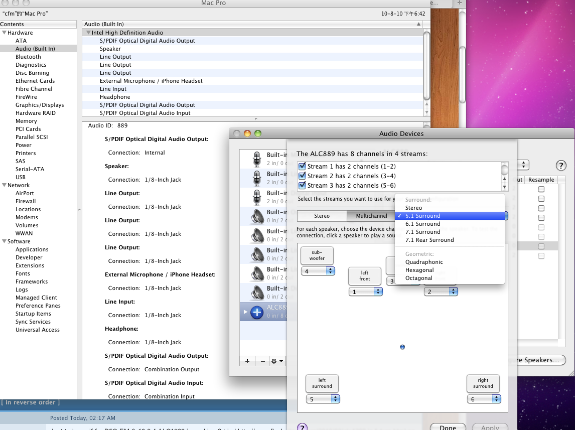

Try this ich10 motherboard should support the
GA-x58A-UD3R ALC889 to 5.1 and 7.1 good :(
I feel that I am so close! I am using the file you generously uploaded, and dropped it in root/Extra/Extensions but still no inputs! I did notice my AudioID changed to 888 instead of 12 or whatever It was before.
What of my other files could be funny, and what other files might I need, I wonder.

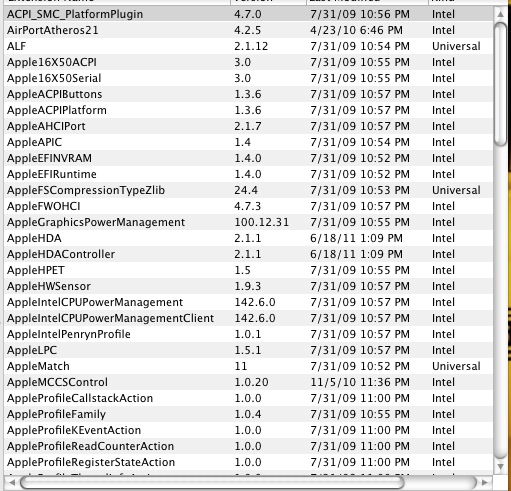

I am close to getting my GA-x58A-UD3R system sound to work, but not quite there.
Right now in my /System/Library/Extensions I have what I believe is a vanilla appleHDA
Right now in my Extra/Extensions I have fakesmc.kext, hdaEnabler.kext, JMicronATA.kext, and LegacyHDA.kext
Right now in my /Extra is the usual stuff, unchanged
What's in your /System/Library/Extensions?
What's in your /Extra?
What's in your /Extra/Extensions?
LegacyHDA?
HDAEnabler?
modified appleHDA?
vanilla appleHDA?
Any and all help is appreciated

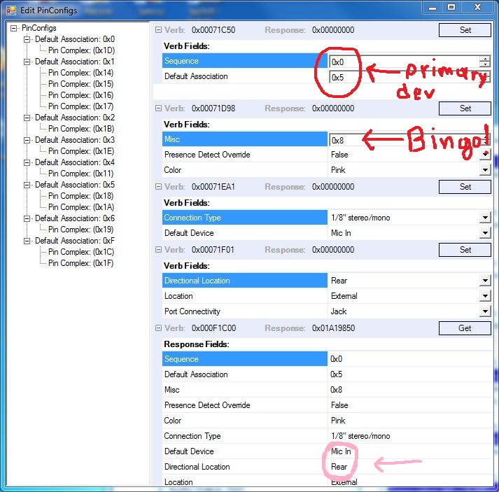

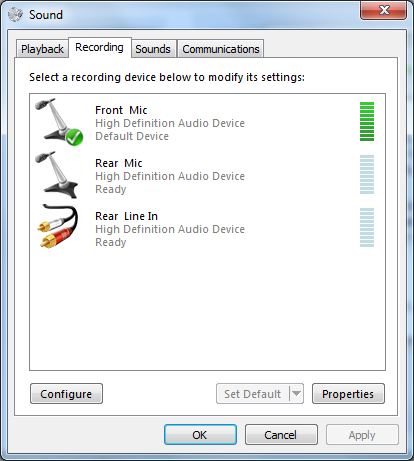

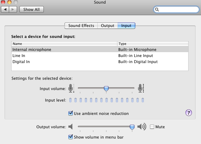

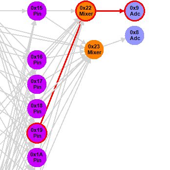

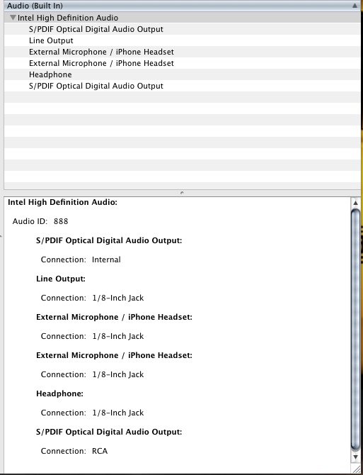

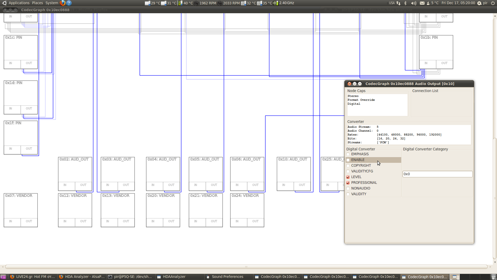

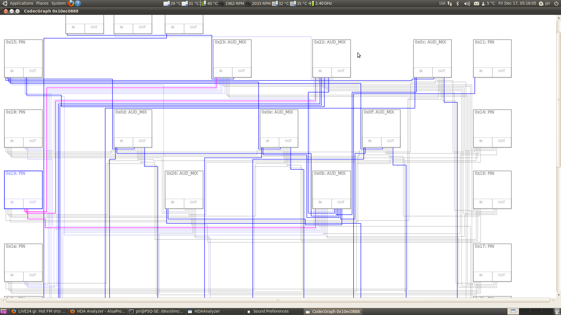

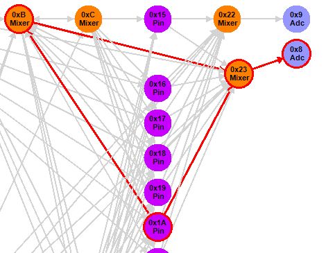

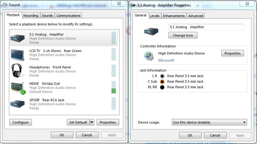

NEW findings...........!!
many people have stacked with Mics and LineIns , can't make them to work simultaneously...
and the reason is......
the Misc Verb
explained:

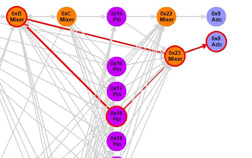

I reversed engineer from M$ and find out that there are limitations into sound.
1.Can't have sequence bigger than 7-8 for analog in-outs , 4LineOut + 2LineIn_Mic_Back + 3LineIn-Mic_HP_Front =9... arg!! ....so choose what to exclude always from front ...say front mic for example(depend on the Codec type)

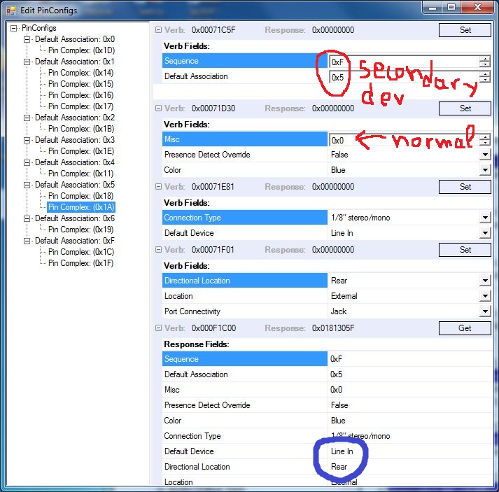

2. Rear LineIn Blue and Mic Pink are always grouped ....
LineIns have more amps than Mics generally ... , and mics have to have "sensitivity" configuration (LineIns are standard , Mics are many to buy... and they have deferment resistance to current , see V=I*R ...)
to "solve" this "non-universal-mic" problem 0x18(rear mic) and 0x1a(rear linein) in my case is passed to the same 0x23 mixer to pre-process ,then to the 0x0b the main-mixer . The 0x23 mixer produces a "gain" control over the mic.
So.... Mic REAR and Line In REAR to the very same mixer always (pre-amplifier) then to the main mixer, then "play" with pin-sence,sequence,association e.t.c.
3.0x19 front mic has an independent "oneway" rout to 0x22 mixer..so it is a standalone input
***take a break here*** and see the pics
here comes the MUTEGPIO...what the #$@%! is this?
MuteGpio is the reference to Voltage to cutoff-mute a mixer-pin
so the _HIZ 50 80 100 is 0% 50% 80% 100% of the Voltage dropout when a "device" is plugged...get it?... :angel:
(see impedance , V=I*R , I is in amps and the logic-circuit fix it to a standard number so when a "device" with "wrong" Resistance is plugged ..cutoff-mutes the mixer-nods by "looking" to the Voltage dropout . nice eee? :P )

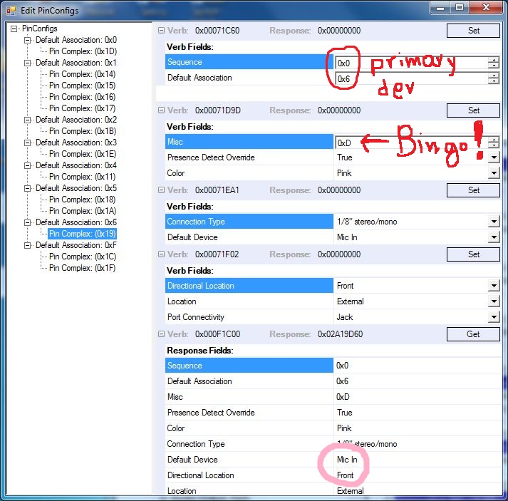

and to conclusion now:
why with all this got it wright ...can't get the front mic to work? !@#!@#$#@@!! :) arg-arg
the reason is Misc Verb.
It has something to do with the Default Device setup ... and more
well where do we find a workthrough for Misc?..it seems that there are many secrets there...and for sure A$ works different from M$ on that to brake our nerves...
p.s.

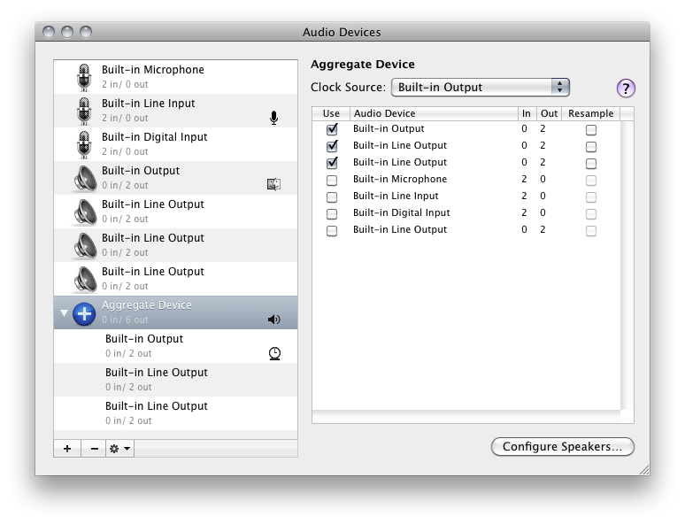

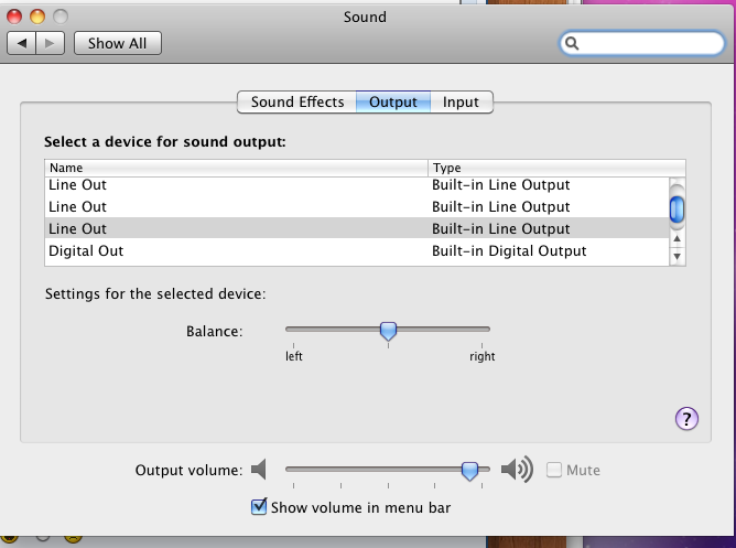

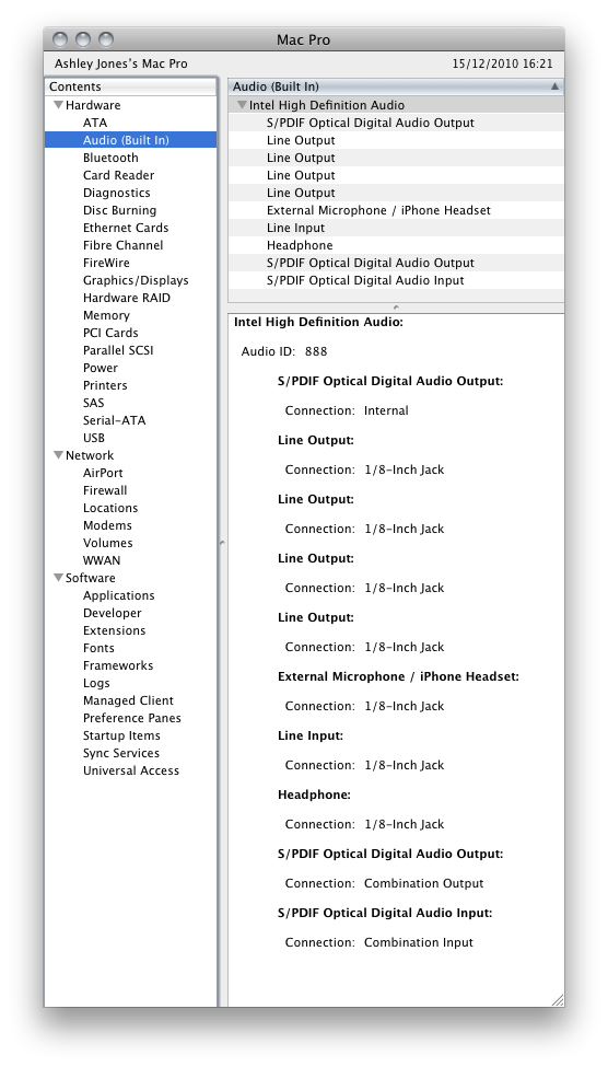

Snow 10.6.5 all working "retail" with original AppleHDA.kext and one legacy kext into Extra...except front mic
System Wide pinconfig is produced to a reg file with HDau form M$ fundamental>audio

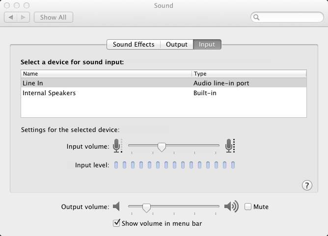

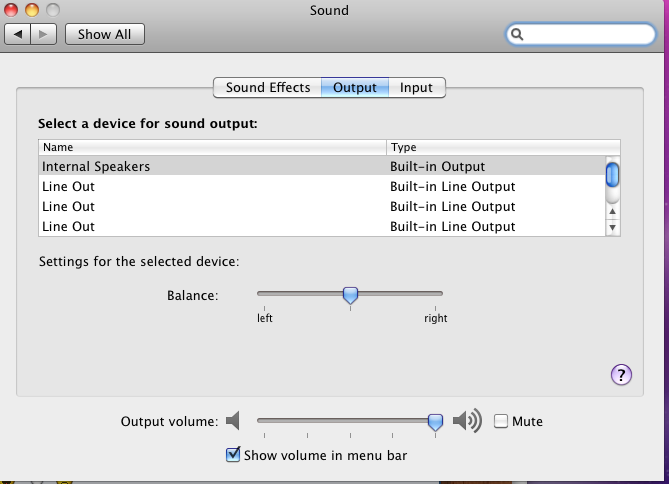

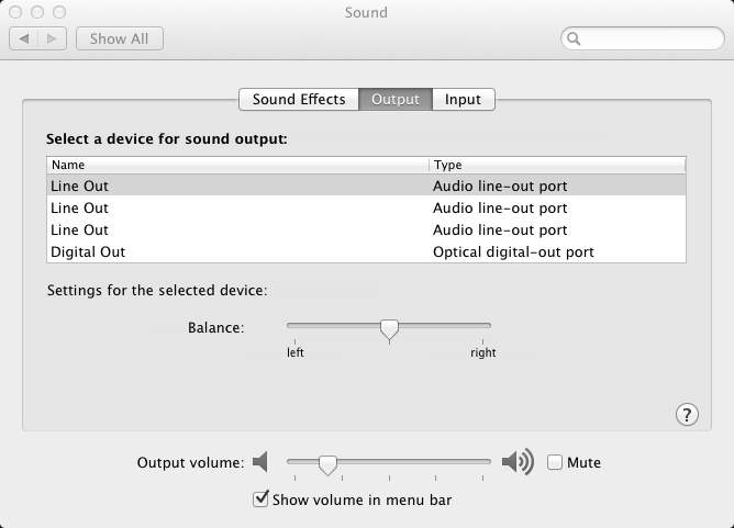

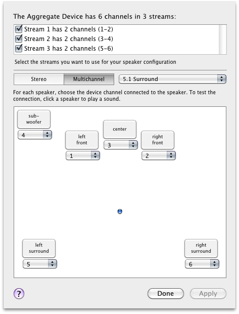

this method still working on my Lion GM install on my asus p5q pro with alc1200 after bin patching and adding 2 files from this thread, i used the patch applehda on my sl 10.68 from lion as well, thanks to gsam_fan, with my dsdt injection and the legacy alc1200 in my e/e all is still good even with lion gm.
almost forgot to thank blackosx for the files and info
sound panel in lion
