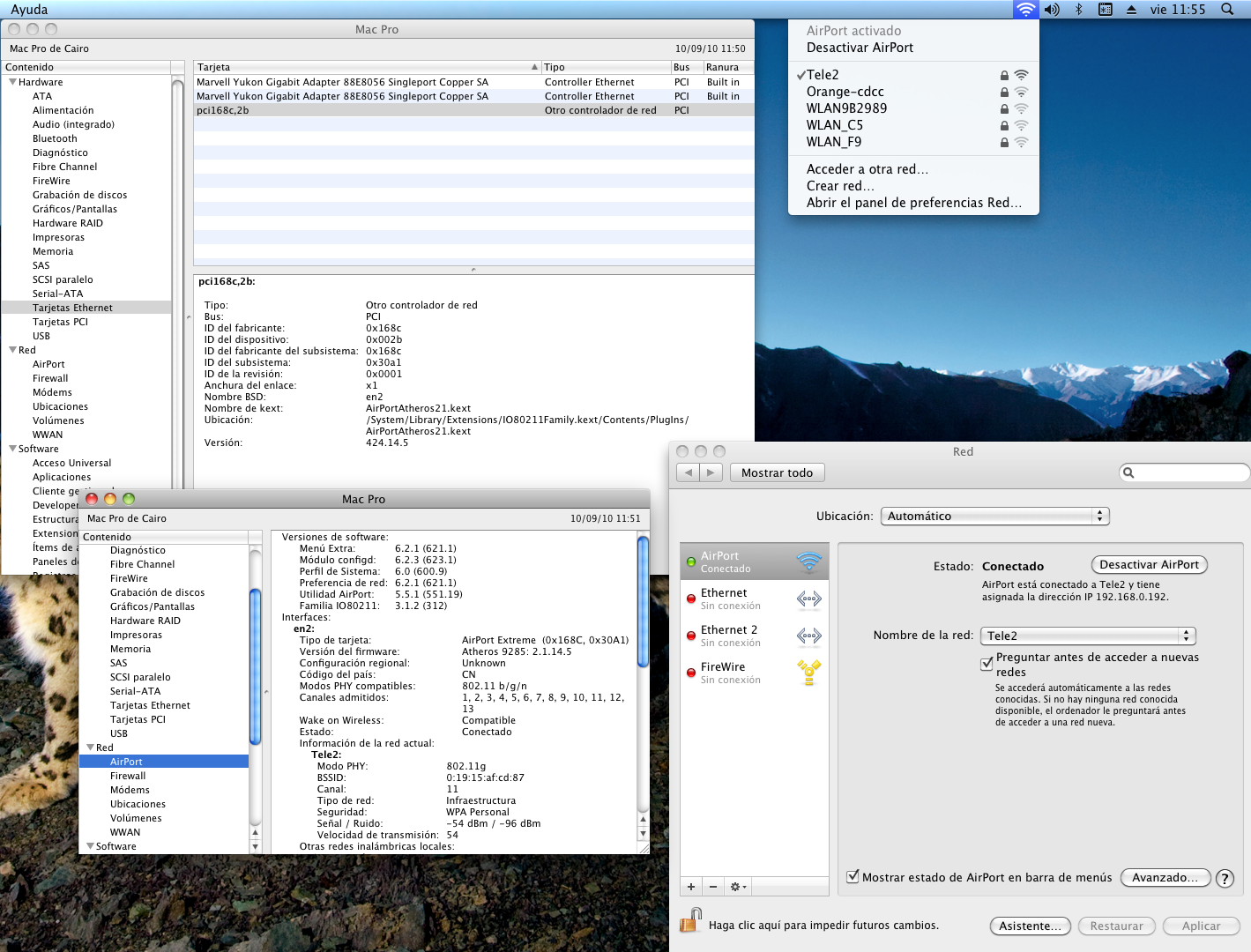

Dutchcoffee Posted August 30, 2010 Share Posted August 30, 2010 Will the AirPort icon be displayed in the menu bar? Link to comment Share on other sites More sharing options...

cairo_sc Posted September 10, 2010 Share Posted September 10, 2010 Will the AirPort icon be displayed in the menu bar? Yes it will, mine is =) take a look Link to comment Share on other sites More sharing options...
