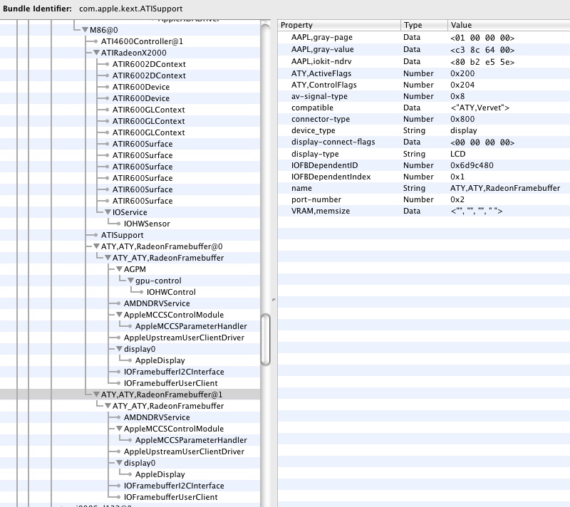

Good news!
I'm able to get HD4570 working with 10.6.6 but only external monitor working right now. QE/CI also enabled.
Result:-
Output only on external monitor with QE/CI supported. Internal monitor remain black.
Requirements:-

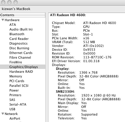

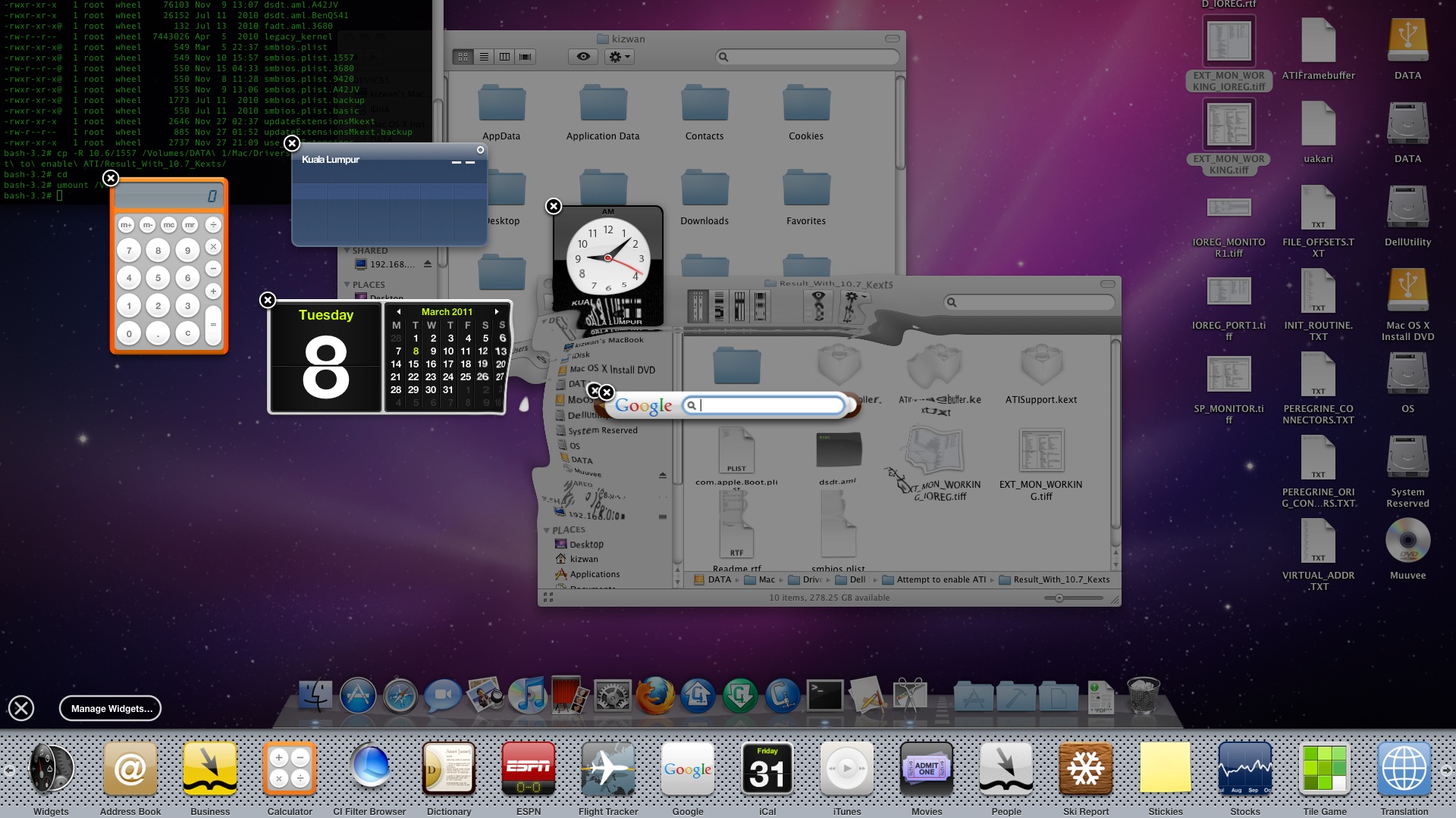

System Profiler & IOReg:-
Pictures show "water effect" which proved the QE/CI are enabled:-

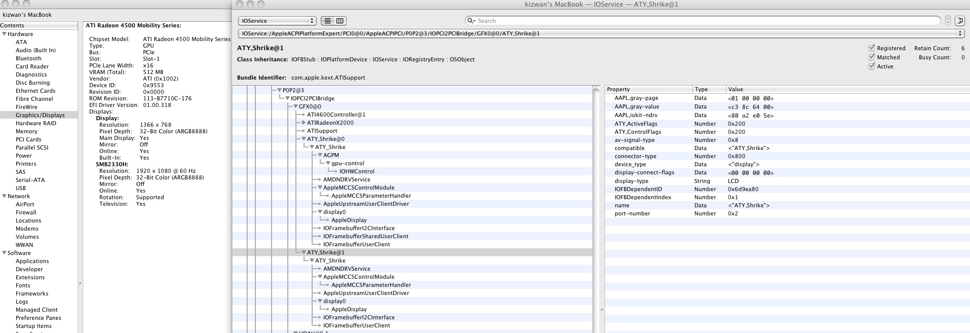

Another good news!
I'm able to get HD4570 working with 10.6.6. All connections; LVDS, VGA & HDMI; are working. QE/CI also enabled.
(Update 6 April 2011)

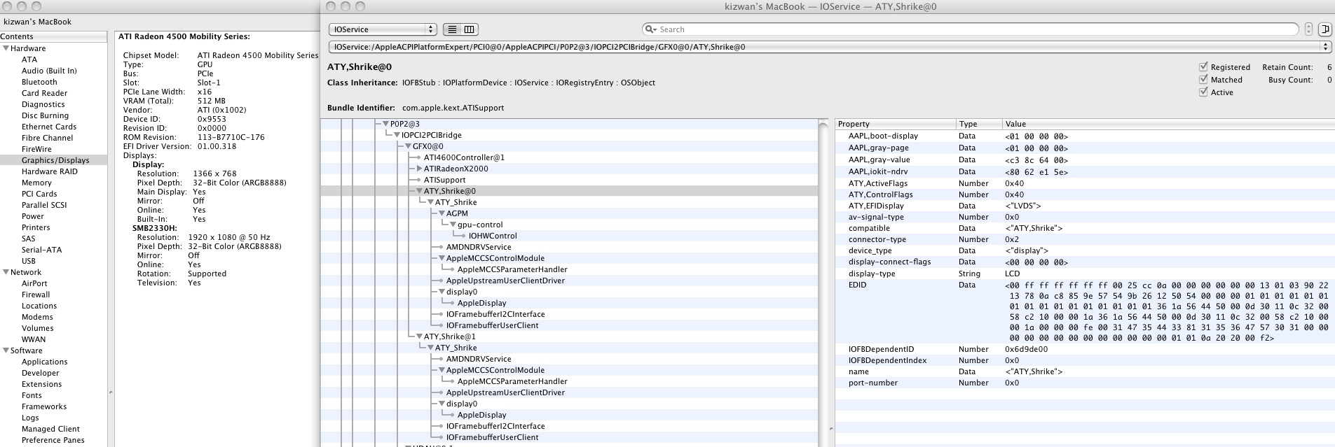

  02  00  00  00  40  00  00  00  09  01  00  00  12  00  00  01	 (LVDS)
 10  00  00  00  10  00  00  00  00  01  00  00  00  10  01  06	 (VGA)
 00  08  00  00  00  02  00  00  00  01  00  00  20  01  02  02	 (HDMI)
[*]The "
NEW ATIFramebuffer
" folder contain
ATIFramebuffer.kext
which already patched
with this connection table using Shrike framebuffer (transmitter & encoder are based on RadeonHD's log).
This is tested & proved to works only with standard LCD panel (1366x768)
dong's
log:-
Mapping DIG1 encoder to KLDSKP_UNIPHYB
Connector "DVI-D 1" uses Monitor "SMB2330H":
Mapping DIG2 encoder to KLDSKP_UNIPHYE
Crtc[1]: found native mode from Monitor[LVDS Panel]:
Modeline "1366x768"  67  1366 1383 1395 1434  768 771 773 781
Connector "PANEL" uses Monitor "LVDS Panel":
RHDValidateScaledToMode
rhdModeValidateCrtc
DxModeValid: ATOM CRTC 2
rhdAtomOutputModeValid
Listing modesetting layout:
ATOM CRTC 1: tied to Atom PLL 1 and LUT A:
Outputs: AtomOutputUniphyB (DVI-D 1)
ATOM CRTC 2: tied to Atom PLL 2 and LUT B:
Outputs: AtomOutputUniphyE (PANEL)
Unused Outputs: AtomOutputDACB
CRTC0 >
DIG1
UNIPHYB
> HDMI:
Encoder=0x00
Transmitter=0x20
CRTC1 >
DIG2
UNIPHYE
> LVDS:
Encoder=0x01
Transmitter=0x12
CRTC1 >
DAC
DACB
> VGA:
Encoder=0x10
Transmitter=0x10
  02  00  00  00  40  00  00  00  09  01  00  00  12  01  00  01	 (LVDS)
 10  00  00  00  10  00  00  00  00  01  00  00  10  10  01  06	 (VGA)
 00  08  00  00  00  02  00  00  00  01  00  00  20  00  02  02	 (HDMI)
Requirements:-
  1. Mac OS X 10.6.6
  2. 10.6.6 kexts:-
    • ATI4600Controller.kext
    • ATIFramebuffer.kext (included in the compressed file - already patched)
    • ATISupport.kext
[*]Modified Chameleon 2 boot file (included in the compressed file - Shrike is default framebuffer for HD4570)
[*]Boot with GraphicsEnabler=Yes
[*]Required files - Final_10.6.6_kexts.zip (Old package. Please download the Final_10.6.6_kexts_R2.zip package)
Notes:-
  1. Please use legacy kexts available in previous post.
  2. Use AppleHDA.kext (10.6.6) already patched with IDT device ID - available at previous post. (also included in the Final_10.6.6_kexts_R2.zip package)
  3. Tested on 32bit & 64bit mode.

Hi, i ve got also a dell 1557 i7 720qm, mobility radeon 4570 512mb, but wled 1920x1080.
Thanks for your topics about this notebook, i m able to run osx 10.6.6, but no qe/ci yet. I used your kexts and patched files.
After hours of reading, it seems to be a problem with the dual link dvi support. The injector dont recognize it properly , (if i m right). But i m noob with hexadecimal and compilation, can you help me to resolve this, i m ready to make test
Here is the output of radeon_bios_decode (i think it will be the same as you, but i would verified), and the dmesg in linux :
Correction, it's dual-link (a.k.a 2 channel) LVDS transmitter.
Yes the radeon BIOS dump is identical with mine.
This is connection table for our GPU:-
CRTC0 > DIG1 > UNIPHYB > HDMI: Encoder=0x00 Transmitter=0x20
CRTC1 > DIG2 > UNIPHYE > LVDS: Encoder=0x01 Transmitter=0x12
CRTC1 > DAC > DACB > VGA: Encoder=0x10 Transmitter=0x10
Patched connection table:-
--> 00000000: 02 00 00 00 40 00 00 00 09 01 00 00 12 01 00 01 (LVDS)
--> 00000010: 10 00 00 00 10 00 00 00 00 01 00 00 10 10 01 06 (VGA)
--> 00000020: 00 08 00 00 00 02 00 00 00 01 00 00 20 00 02 02 (HDMI)
These are what I want you to try (please test the boot file first):-
  1. Please try this modified boot file. It inject missing property from latest macbook pro. In this boot file, our GPU will use Shrike framebuffer. Rename it to boot & installed it.
    boot.mobility.0x9553.zip
    (This boot file is compiled from trunk which contain modified ati.c file. The modified ati.c file can be found here.)
  2. If with the above modified boot file, you still unable to get LVDS working properly, please change the LVDS's transmitter (please keep using the above modified boot file):-
    CRTC1 > DIG2 > UNIPHYEF > LVDS: Encoder=0x01 Transmitter=0x02
    --> 00000000: 02 00 00 00 40 00 00 00 09 01 00 00 02 01 00 01 (LVDS)
    Offset of Shrike connections table (3 connections):-
    • 32bit: 0x00037298
    • 64bit: 0x00010F80
Please let me know the results. Good luck. ;)
Hi,
Thanks to take time for that :P
Ive tried the two patched connection with your boot file, in 32 and 64 bit , and unfortunately it was not working.
But in the two cases, i am able to boot normaly with "graphic enabler=yes", and the screen appear in 1024x768, my graphic card is also detected, and apparently the monitor isnt detected
ATI Radeon 4500 Mobility Series :
Jeu de composants : ATI Radeon 4500 Mobility Series
Type : Processeur graphique (GPU)
Bus : PCIe
Logement : Slot-1
Longueur de la voie PCIe : x16
VRAM (totale) : 1024 Mo
Fournisseur : ATI (0x1002)
Identifiant du périphérique : 0x9553
Identifiant de révision : 0x0000
Révision de la ROM : 113-B7710C-176
Version du gestionnaire EFI : 01.00.318
Moniteurs :
Moniteur de type inconnu :
Résolution : 1024 x 768
Profondeur de pixels : Couleurs 32 bits (ARGB8888)
Moniteur principal : Oui
Miroir : Désactivé
Connecté : Oui
Connecteur pour le moniteur :
The strange thing is that it recognize 1024vram, and ive got 512...
I used your dsdt is it a good thing?
Ive got ioreg output, but i cannot upload them, i will retry later :)
Ive got ioreg output, but i cannot upload them, i will retry later ;)
Yes, you can use my DSDT.
Just zip it & upload here OR upload it at mediafire.com & post the link here.
The ATI4600Controller.kext is not loaded. Please execute this command in terminal to refresh the kexts cache & then reboot:-

Thanks for the update
Ive retried with refreshing kext cache, and ive got this time for the two patched connection with your updated bootloader, a garbage screen in the two cases. Test only with 32 bit.
I will tried to connect a monitor to vga and hdmi, and se what append, and tried to send you ioreg.
There are the ATIFramebuffer that ive patched, let me know if they are rightly patched:
Framebuffer_1.zip
Framebuffer_2.zip

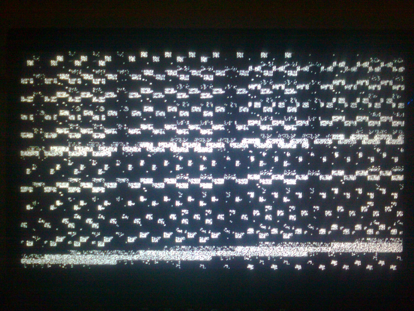

And ive got a garbage screen too
Ok, thanks to have verified my patched files :hysterical:
I have been able to enable 4600controller, and after boot , with the two patched conections, ive got a blank screen for 0,5 sec. and then black screen, the fan run much lower, and the boot sequence seems to be finish. I have retest with a vga monitor, and after with hdmi, the same thing's going, and ive got no output on the external screen.
for the moment i can't have a ioreg output
Ok, thanks to have verified my patched files :(
