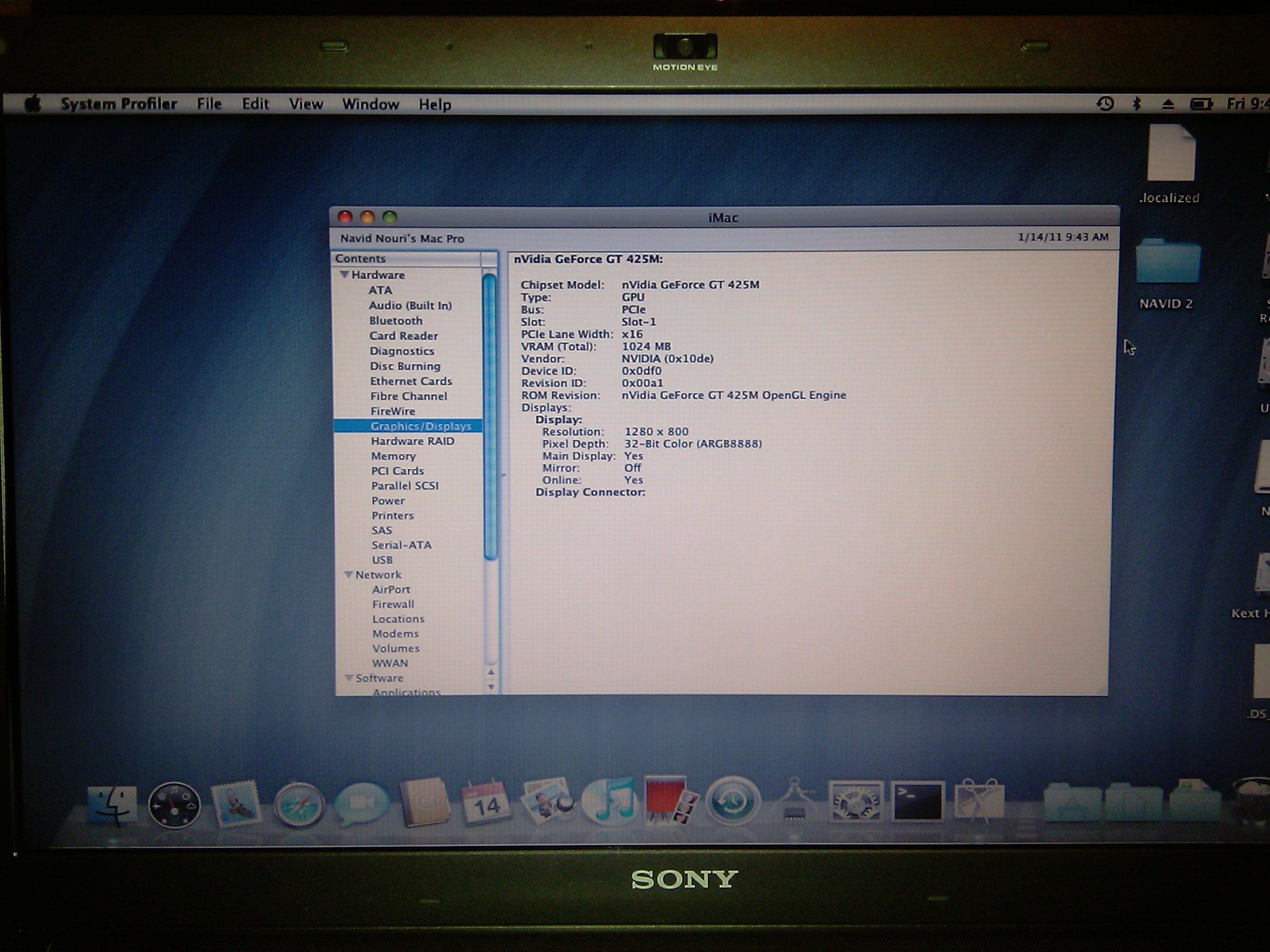

i got my Graphic working WITH internal LCD without any driver after a fresh install with chameleon 2 RC5 r700!!
Navid, is here the nvdahal50.kext active when you enter "sudo kextstat" in the terminal? Did you use the recent driver package from nvidia?
Navid: I patched the Info.plist of VoodooHDA for usage of ALC275 only. The most crashes of VoodooHDA are caused by the HDMI audio device it seems. If your VAIO also has a ALC275 device, this kext should work on your machine without modification, too.
I now trying to make the internal lan available. There is a kext the successfully detects the Marvel ethernet. But it floods the console with the message "MAC 2 not correctly initialized". So there is still lot of work to do. The device is shown in network list now and this driver can be used for some copy protections from VST/AU plugins that will fail without any ethernet kext when calculating a computer checksum.
Thank You and good luck for you!!
the kext which loads for my driver is NVDAHAL100.kext which i can see it is loaded and registered during verbose boot.
i had a fresh install of SL updated to 10.6.5, i opened the driver which NVidia sent out (avilable in kexts.com) and ONLY installed the driver and OpenGLDriver, i did not installed the Display driver ( i tried it once and my display did not came up so i did a time machine backup restore!) so there is a high amount of chance to edit that display driver (Or maybe produce new one) for the display!
i have a DSDT loaded which was patched for me in this forum:http://www.insanelymac.com/forum/index.php?showtopic=235523
and i add my Graphic information to it under PEGP and PEG3! and it worked without any problem so Graphic memory size changed from 512 to 1024

it work perfectly! I tried with osX 10.6.6 with 3 different kernels: 10.3.0, 10.4.0 and 10.6.0, it always works fine! :D
Still nothing for main lcd :(

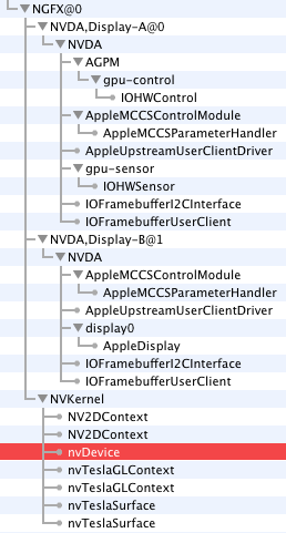

i found something:
download atmonitor (free)
after print iokit from this app it gives more thing than ioreg explorer i did it with vesa and with graphic enabler
after compare i saw a curious thing:
| +-o NVDA,Display-A@0 <class IORegistryEntry:IOService:IOPlatformDevice:IONDRVDevice, registered, matched, active, busy 0, retain 10>
| | | | | "width" = <00000000>
| | | | | "height" = <00000000>
as i can see it seems internal screen load but with no size("width" = <00000000>

kizwan and others, this seems to be quite interesting to me:
The f11 dsdt lcd device contains 6 edids. The fourth, EDI4 is the right one. If you search for EDI4 you will see it is compared with the variable "gpid". Searching for "gpid" you will see that inside the snc device, gpid will be compared with 0x4 a bunch of times. Maybe this is a place to apply a patch? What do you dsdt experts think about it?
If I add a the following line to the beginning of the _INI method of _SB-PCI0:
Store (0x04, GPID)
Could this help? Also _SB.PCI0.LPCB.SNC._INI and _SB.PCI0.LPCB.SNC.SNFA could be called. These SNC functions seem to be interesting.
EDIT: read post below, my experiments.
Here is a new dsdt
It is cleaned up in a way that all PEGP is deleted (because PEG3 is the right one) and all checks relating GPID == 0x04 are used, also EDI4 is always returned. So maybe it's a good base.
There is also proper EDID injection inside from kizwan inside NGFX._DSM, so you have to turn graphics enabler off, no enabler required anymore.
I also tried to move the SNC._INI code to _SB.PCI0._INI. Question: Is this a proper place to enable snc calls (maybe wakeup lcd or something)?
Also _DOS and _DOD added to NGFX... Swapped 0x110 (lcd) with 0x100 (tv), so lcd is the first device. Question: Could this have any effect?
This is the nvcap used:
/* 0000 */ 0x04, 0x00, 0x00, 0x00, 0x00, 0x00, 0x01, 0x00,
/* 0008 */ 0x7E, 0x00, 0x00, 0x00, 0x00, 0x00, 0x00, 0x0A,
/* 0010 */ 0x00, 0x00, 0x00, 0x00
Question: Is this the recent and decent nvcaps?
The internal screen does not appear at all. This is the ioreg of the display devices, looks good to me:
But no "displayX" appears within Display-A tree.
EDIT: There should be a AppleBacklightDisplay.
The display0 inside Display-B was matched by com.apple.iokit.IOGraphicsFamily. So maybe this kext has to be patched, not the nvidia kexts. If it's iographicsfamily that has to be patched, this would be good news, because it is happily opensource:
opensource.apple.com/source/IOGraphics/IOGraphics-48
These particular sources seem to be responsible for the device detection:
opensource.apple.com/source/IOGraphics/IOGraphics-48/IOGraphicsFamily/IODisplayWrangler.cpp
opensource.apple.com/source/IOGraphics/IOGraphics-48/IOGraphicsFamily/IODisplay.cpp
Here is the dsl + aml:
DSDT.aml.zipDSDT.dsl.zip
