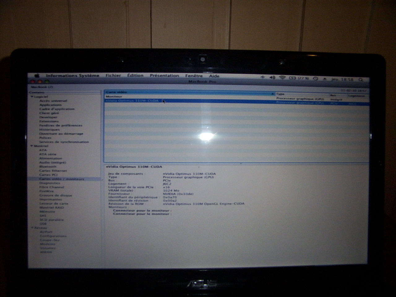

I find a DSDT for my asus k52jc reveals the nvidia 310 m in the system except that on this computer disables video adapter may not intel hd should find a way to disabled card intel that the nvidia can work for l screen
I am sorry, but you are wasting your time for the moment.
The Optimus problem is well known. Optimus switching of graphics works completely different to the way Mac OSX does graphics switching.
There is currently no way you can turn off the Intel HD graphics to let the Nvidia take over - optimus uses the frame buffer of the Intel HD graphics, Mac OSX switching does not use the frame buffer of the Intel HD. So the hardware is different and there are currently no OSX drivers that can cope with the hardware difference.
This is not a problem with the bootloader, but is a bigger different problem.
ok tank you :(

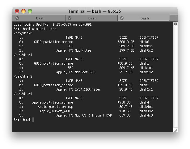

Obviously quite noob'ish but here goes:
When trying to follow the 'manual installation procedure' i'm stalled almost instantly :(
- Have hooked up my SSD HD via usb on my macbook
- Installed SL from dvd
- diskutil list gives
BM:~ bme$ sudo -s
Password:
bash-3.2# newfs_hfs -v EFI /dev/disk1s1
Initialized /dev/rdisk1s1 as a 200 MB HFS Plus volume
bash-3.2# fdisk -f boot0hfs -u -y /dev/rdisk1
fdisk: could not open MBR file boot0hfs: No such file or directory
Should I just continue with the following instructions or what am I doing wrong?

Have you changed into the right folder where the boot0 file is, because you have to do this before you enter the command?!
Greetz
Ah - I thougth I had ;)
After moving into the anval5 folder I can now continue until i am stalled again:
bash-3.2# pwd
/Users/bme
bash-3.2# cd anval5
bash-3.2# dd if=boot1h of=/dev/rdisk1s1
2+0 records in
2+0 records out
1024 bytes transferred in 0.001016 secs (1007972 bytes/sec)
bash-3.2# mkdir /Volumes/EFI
bash-3.2# mount_hfs /dev/disk1s1 /Volumes/EFI
bash-3.2# cp boot /Volumes/EFI
bash-3.2# fdisk -e /dev/rdisk1
fdisk: could not open MBR file /usr/standalone/i386/boot0: No such file or directory
Enter 'help' for information
fdisk: 1>
Onosan,
the message
can be safely ignored, just keep on with the rest of the commands ;)
