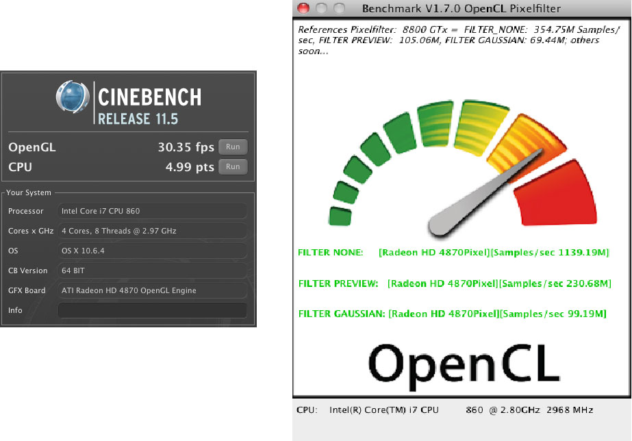

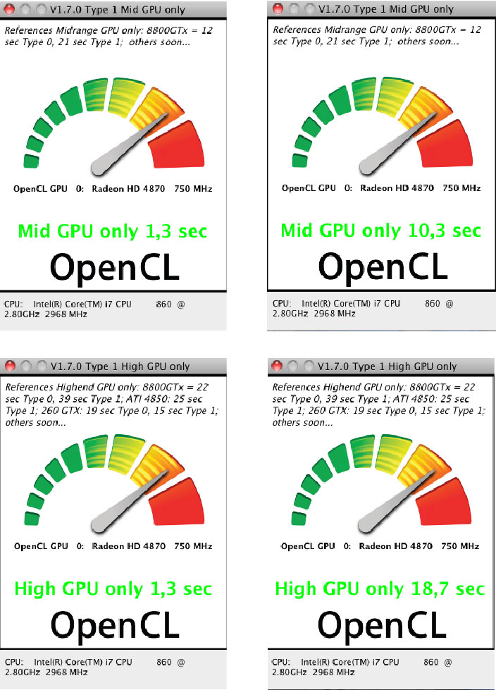

Anyways, I'll post the results of the all the tests over with this ATI Radeon HD 4870 1gb and the correctly clocked Core i5-750.
Label: New (+/- diff old)
FILTER NONE: 1150.53M Samples/sec (+274.53)
FILTER PREVIEW: 223.94M Samples/sec (-48.74)
FILTER GAUSSIAN: 107.56M Samples/sec (-34.86)
CPU Only
Mid: 27.1 sec (-14.2)
High: 52.9 sec (-30.5)
Ultra: 52.9 sec (-21.5)
Hybrid
Mid: 8.4 sec (+1.4)
High: 18.8 sec (+4.1)
Ultra: 29.8 sec (-10.6)
GPU Only
Mid: 12.3 sec (+1.1)
High: 21.6 sec (+5.2)
Ultra: 53.7 sec (+14)
This is NOT with the flashed ATI bios... I have to boot into Windows as well.
Thanks ! In this case you see that the power of the OpenCL driver (better: OpenCL > native gpu code runtime compiler) has big effect how fast OpenCl works - beside the GigaFlops Power the hardware (shader units) can do.
The ATI 48xx cards are on HW and OpenCL normal code (smallluxGPU raytracing for example) equal than GTX 280, much faster than GTX 260.
But impelented the OpenCL pixeldevice (working with pics = OpenCL pixelbench) code wore than Nvidia. ATI starts to implement OpenCL pixeldevice code very late (on Win/OS X) : 10.6.3 Nvidia impelented that already in 10.6.0 and maybe already optimized a lot .

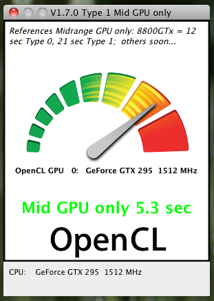

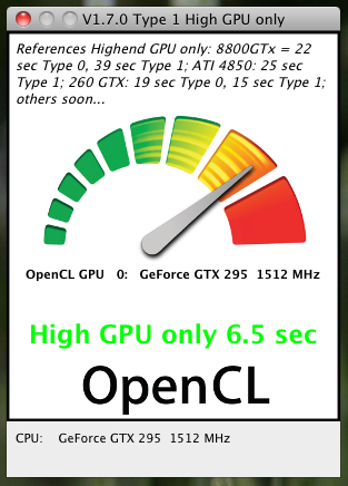

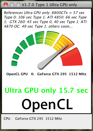

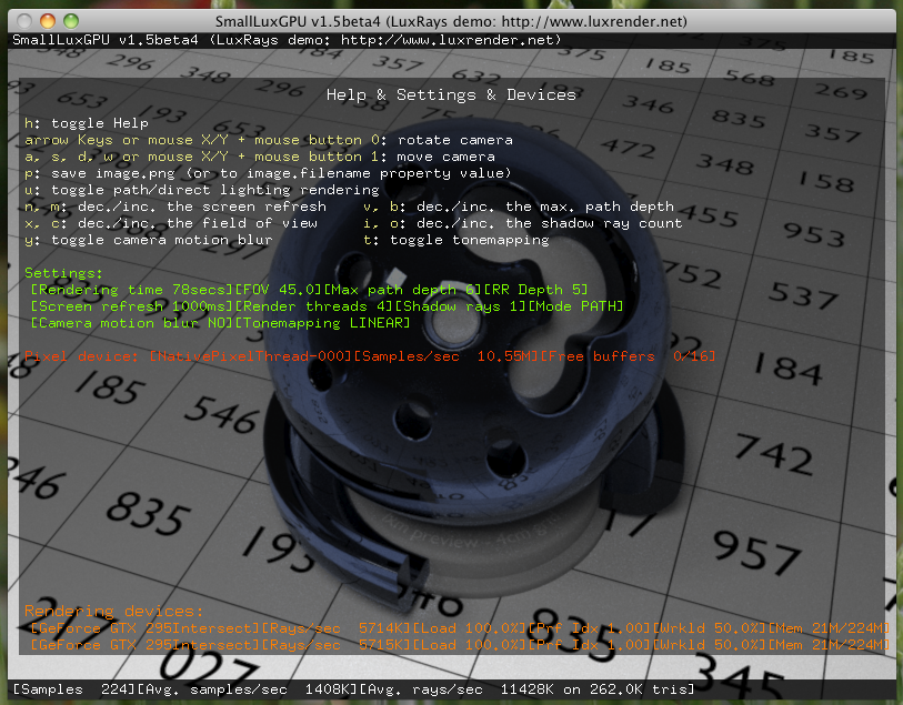

Core i7 870 @ 3.68Ghz + EVGA GTX 295 Co-op Edition (Single PCB) @ 684/1512/1180 MHz
-- Utilizing both GPUs
GPU Only Midrange: 5.3sec
GPU Only Highend: 6.5sec
GPU Only Ultra: 15.7sec

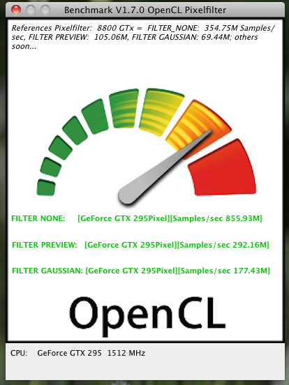

-- Only one GPU is used for the Pixelfilter test
FILTER NONE: 855.93M
FILTER PREVIEW: 292.16M
FILTER GAUSSIAN: 177.43M

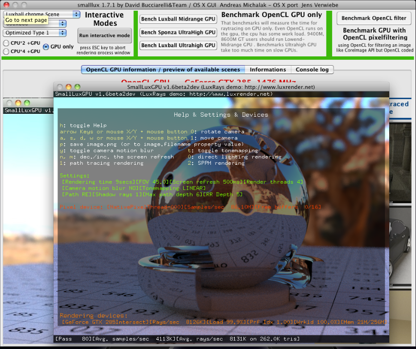

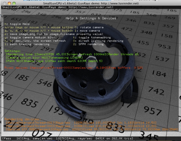

-- Utilizing both GPUs (Luxball glass Scene)
GPU1: Rays/sec 5714K
GPU2: Rays/sec 5715K
Avg. Rays/sec 11428K
WOW - extreme FAST with 2 GPUs !
Single ATI 48xx cant follow :D

Now 1.7.1 PreFinal: http://rapidshare.com/files/409202831/smal...PU_171Final.zip
- removed OpenCL Code Type selector (0/1) from Benchmark. Always use now Type 1.
- added SPPM Method Type - special raytracing method in OpenCL. Glass / lights look mostly better, but more cpu usage
- added intances 130 Mill Scene (fixed res / special OpenCL Code = no res+no Type selector for that scene)
Instances 130 Million (triangles) may NOT work on ATI OS X GPUs.
At least on Windows the ATI OpenCL drivers fail, Nvidia drivers can run that scene on Win/OS X
Also huge RAM usage, therefore 3GB RAM needed to perform fast. I would NOT run that GPU only on lowend GPUs.

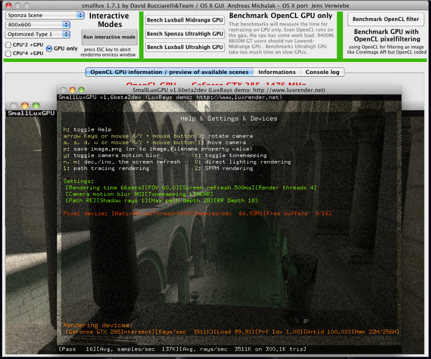

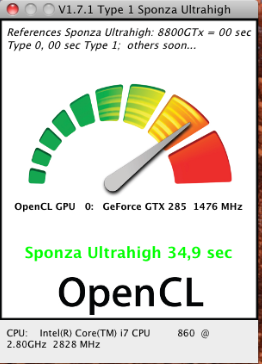

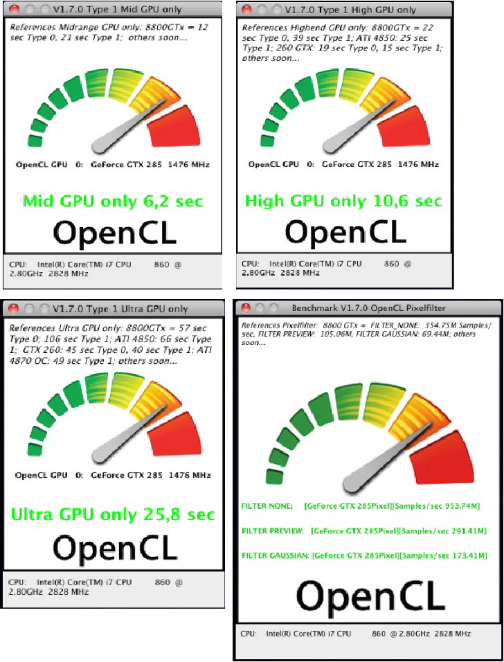

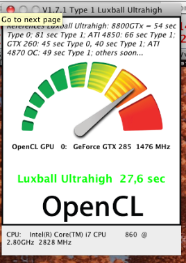

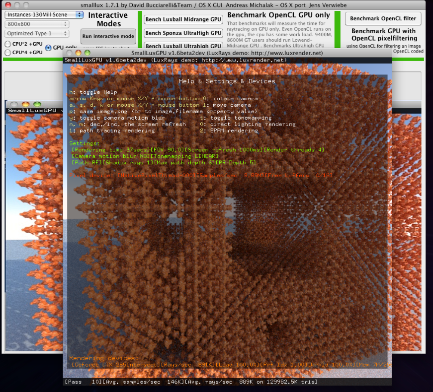

Test Part II:
GALAXIES 32K_V2
NVIDIA INNO3D GeForce GTX 285 1GB
_________SIM:___________________ GIGAFLOPS:
Vector Single Core CPU:_________________12
Vector Multi Core CPU:__________________46
GeForce GTX 285:_____________________ 329
Hybrid Multi Core CPU+GPU:______________80
OpenGL 3.1:
For comparison:
ATI Sapphire Radeon HD4870 1GB
OpenGL:
OpenCL:

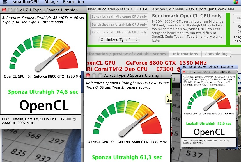

Please try the more new V171(V2). Sponza Ultrahigh and Luxball Ultrahigh - but should perform near same as with that older V170 version.
Also some GUI cleaning (removed OpenCL Type setting 0/1 - now alwys uses Type 1 which run normally faster)

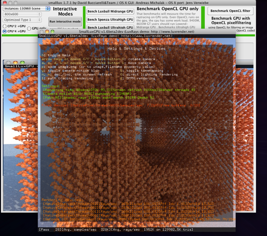

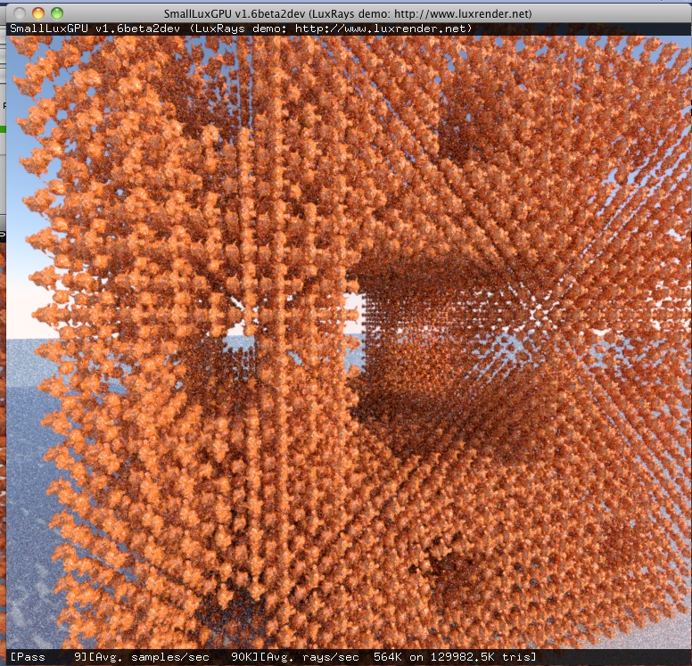

Even more interesting is how fast the GTX 285 perform the extreme huge scene instances. 130 million triangles !!
I get around 27 kSamples/sec (gpu only, 8800GTX ). instances scene can be selected (only) in the interactive mode and shows the informations (CPU/GPU performance) in the bottom line as kSamples/sec.
DL :
http://rapidshare.com/files/409790525/smallluxGPU_V171_2.zip

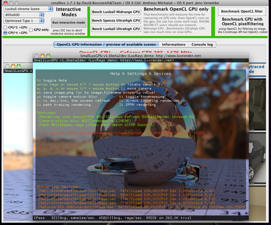

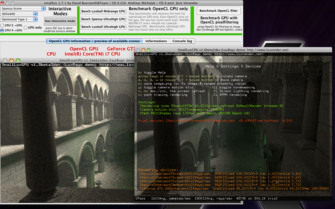

Sponza Hybride 4cpu + gpu-------------Sponza GPU
Luxball Chrome Hybride--------------Luxball Chrome GPU
130 Mille Hybride----------------------130 Mile GPU
Have a nice day! :(
____QuattroFX____
Great ! You get much more speed in instances : 146 vs 27 k Samples/sec - me, 8800 GTX !
Diff to 8800GTX is much bigger than in Sponza or Luxball benchmark (30 vs 80 sec) . I will add that instances also as benchmark (until ATI OpenCL bug fixed with ATI information that it may fail).
Also the other Benchspeeds (Sponza, Luxball) are very good - at least ATI 5770 cant bet them.

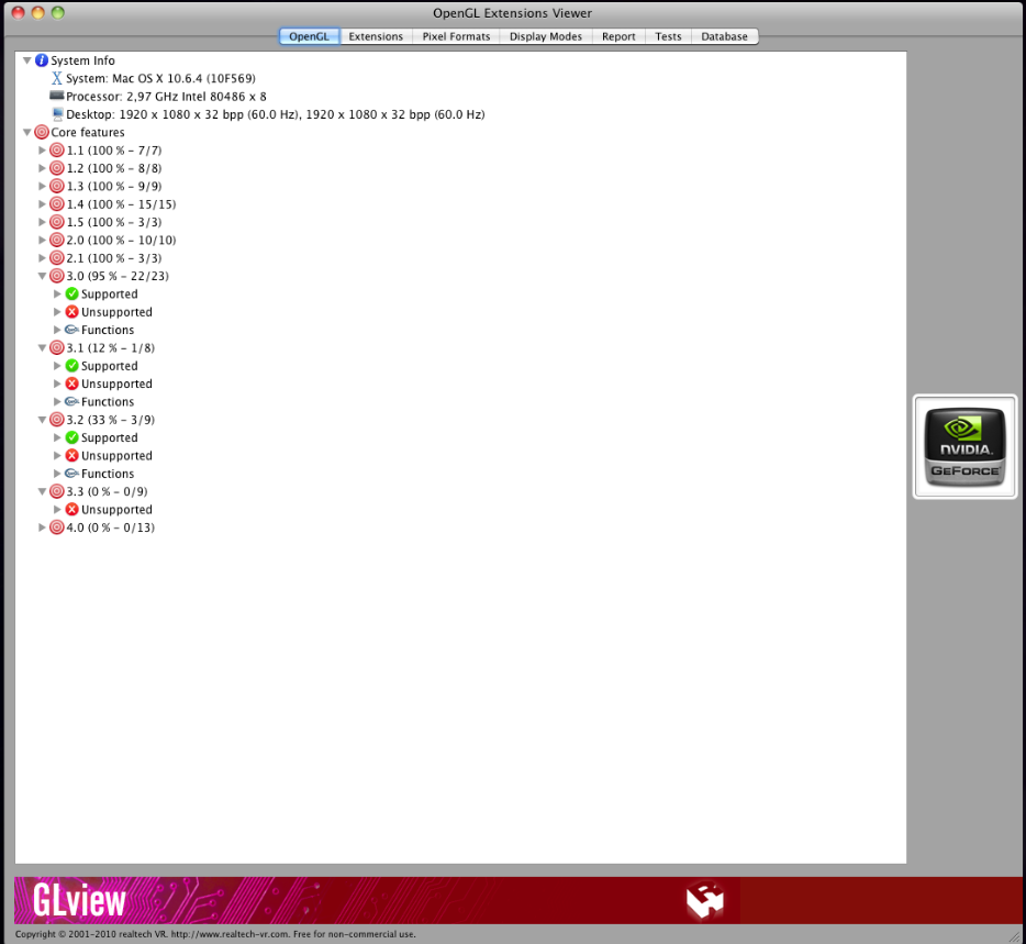

10.6.0 <---> 10.6.4
10.6.0 <---> 10.6.4
10.6.0 <---> 10.6.4

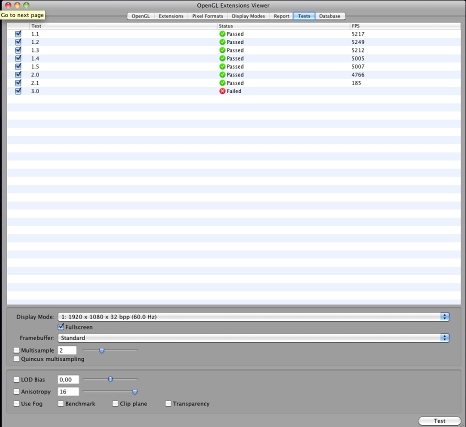

"I am interested in to see some GTX 470 - 480 tests for comparison to 285, because they still use drivers from 200,
if they can come to similar results? Do you know something about it? Do they support OpenCL at the moment? "
No, Fermi GPUs fail in OpenCL - missing Apple Support. Only Opengl works but not as fast as they could do.
ATI 5xxx - OpenCL works , but instances scene fails - maybe the new iMac update will help / 10.6.5 will help.

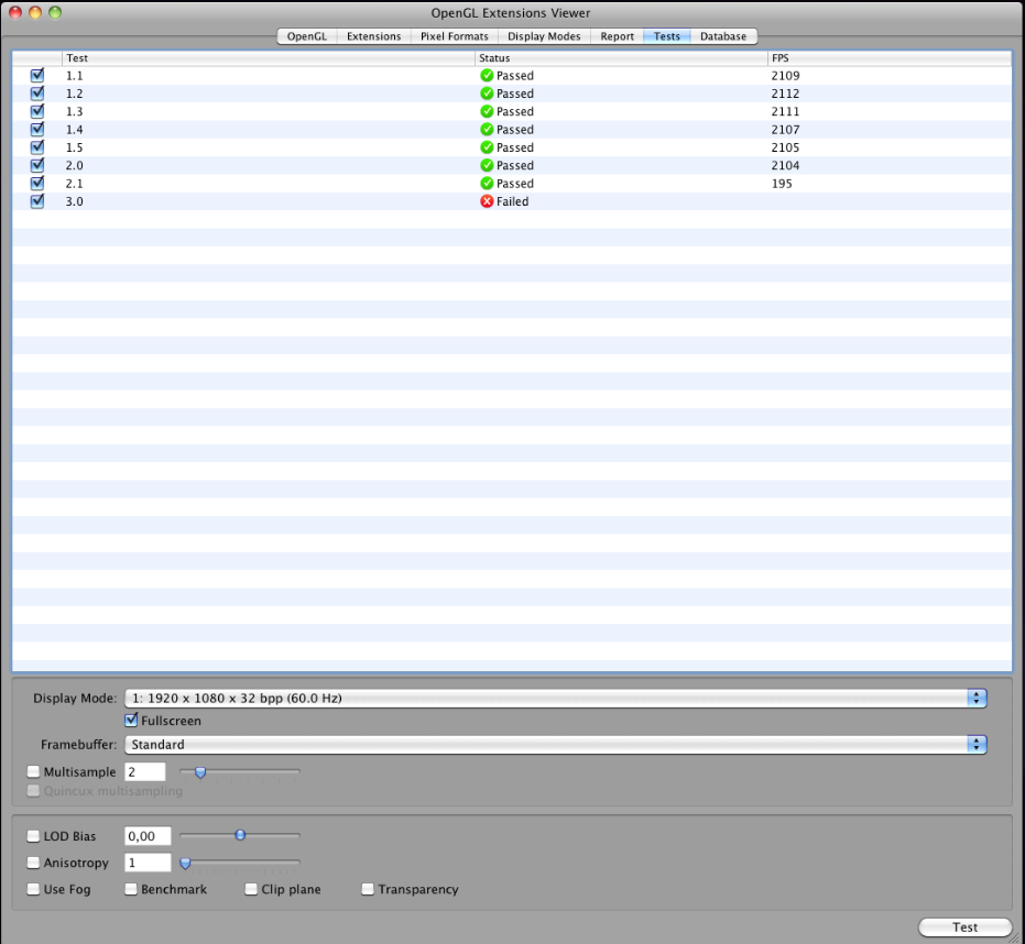

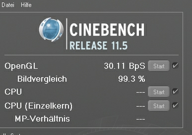

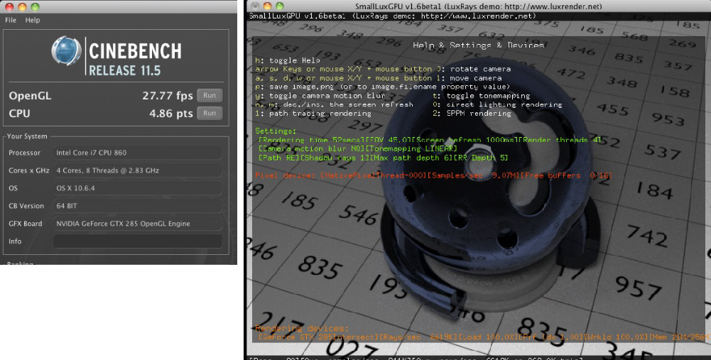

OpenGl implementation in win 7 is much better
this is a stock ati 5770
with a 2,6 downclocked old Q 9550
same config in 10.6.4 with newest drivers available (graphicsupdate 1.0) = 27, 1 fr.
people with GTx 285 and i7 usually get > 60 fr . in 11.5 (win7)
