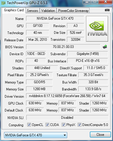

Does this work for GTX 470 fermi? I have black borders at boot/os install.. is annoying.. i would like 1920x1080 thanks :)
That makes 2 of us with the same problem. Are you using a DVI cable?

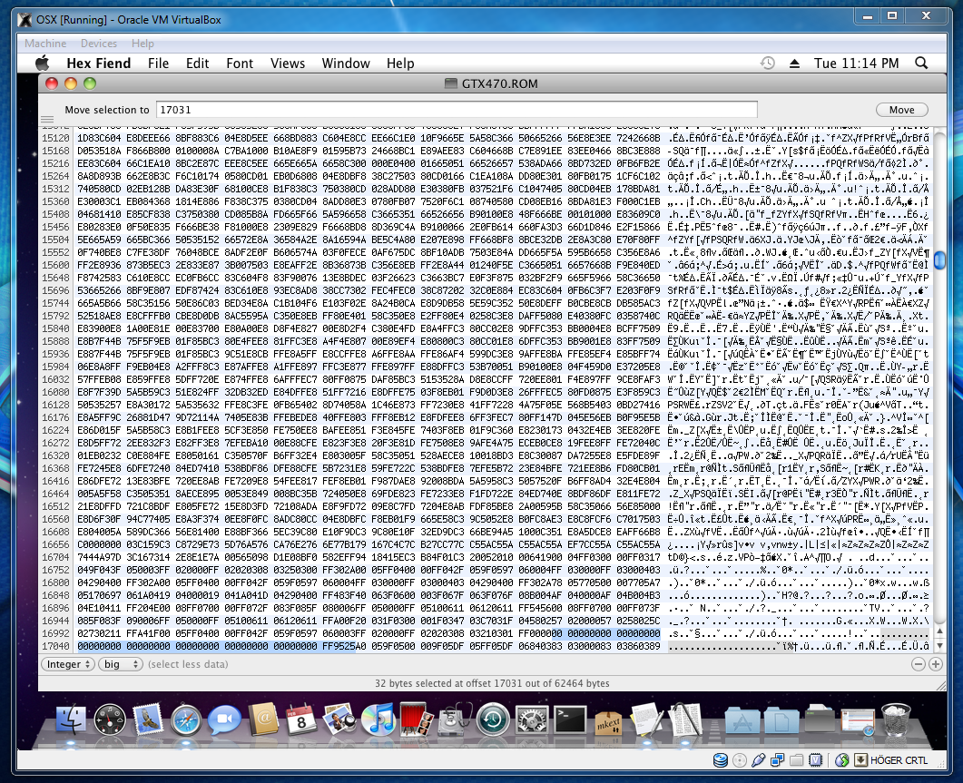

I ran the tool with my bios rom:
Length:62464
Found 1. possible NVIDIA Mode at 0x4167(Decimal:16743)
Empty Table at 0x4287(Decimal:17031)
Empty Table at 0x4307(Decimal:17159)
Empty Table at 0x4347(Decimal:17223)
Correct number of finds
Mod should be working
So i open Hex Fiend - > Ctrl + L > Move Selection to: 17031 > Move.

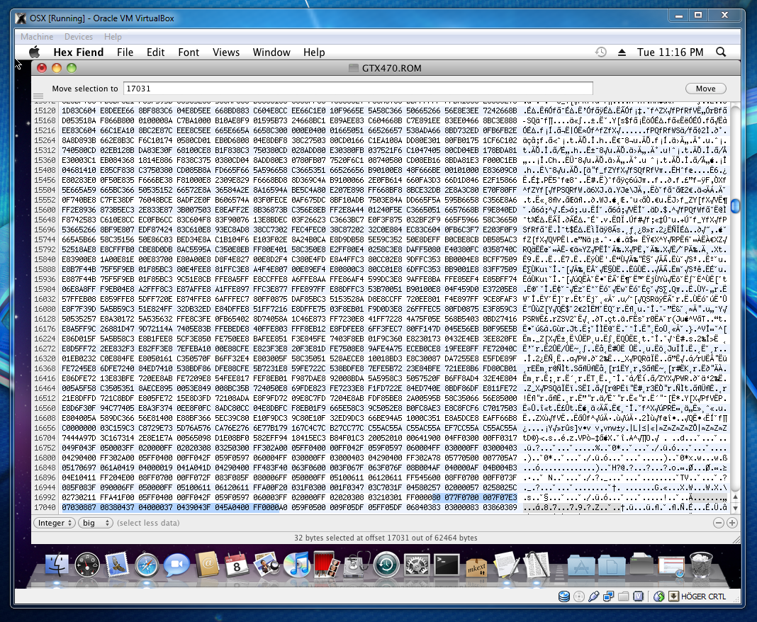

Then it shows this and i select 32 bytes: post-34410-1297203442_thumb.png
and exchange with: post-34410-1297203450_thumb.png
Is this right?

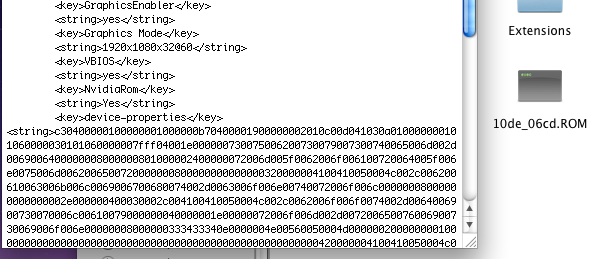

Seems it is not working.. i saved the rom file and wanted to test it with chameleon rc5 699.
So i edited my boot.plist and put the rom file on /USB/Extra/10de_06cd.ROM
But at chameleon i don't have native res and when i press video info i see the old low resolutions in the list.
I am doing something wrong or is there no hope for me :thumbsup_anim:?
