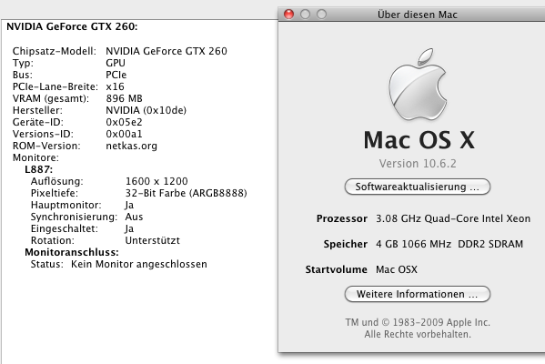

Here is a copy of my com.apple.Boot.Plist with the string that enables my Asus Geforce GTX 260
I just use Chameleon 2 or PC EFI 10.5/6 and GraphicsEnabler=Yes .. as a boot argument.
If that doesn't work for you then try with GraphicsEnabler=Yes and PciRoot=1 for chameleon
or if using PC EFI GraphicsEnabler=Yes and -pci1
D

Hi
For Solve black Screen Issue =
From Other OS (Like Windows(with MacDrive Application) or Leopard) Move All Files That Starts With NV*.kext in below address
SnowLeopard HD:\System\Library\Extensions
to Another Folder, Just Disappear Them From Extension Folder, But Do Backup Of Them!
They Are 4 files , as:
NVDANV40Hal.kext
NVDANV50Hal.kext
NVDAResman.kext
NVSMU.kext
this act will be starts your snow without any black screen issu, but the VGA isnt installed now
For Installing!!!
And Knowing your Card By System Profiler
Download this Package [Mirror - Mediafire]and extract to your desktop, Like this
open terminal and type:
~/Desktop/GFXstrings/gfxutil -f display
you will be get texts like this
DevicePath = PciRoot(0x0)/Pci(0xc,0x0)/Pci(0x0,0x0)
copy just
PciRoot(0x0)/Pci(0xc,0x0)/Pci(0x0,0x0),
now go to Desktop -> GFX String -> GTX 260 and open GTX260 with text editor.
find
<key>PciRoot(0x1)/Pci(0x3,0x0)/Pci(0x0,0x0)</key>
and replace with ours.
now save this file with text editor as " gtx260.plist " in GTX260 Folder.
back to terminal and type
cd ~/Desktop/GFXstrings/GTX260
~/Desktop/GFXstrings/gfxutil -i xml -o hex ./gtx260.plist ./output.hex
now we have a "output.hex" file in GTX260 Folder.
open "output.hex" and copy all text from it, this texts called STRING.
back to terminal and type:
cp /Library/Preferences/SystemConfiguration/com.apple.Boot.plist ~/Desktop/
this command will be copy com.apple.boot.plist into desktop.
open it by text editor
add this string:
<key>device-properties</key>
<string>Paste STRING Here!</string>
Save com.apple.boot.plist file.and exit Text editor.
For Example, After This Job, Will Be Have Like This:
<plist version="1.0">
<dict>
				<string>6c0200000100000001000000600200000d00000002010c00d041030a00000000010106000003
0101060000007fff04001e00000072006f006d002d007200650076006900730069006f006e0000002
e0000006e5669646961204765466f7263652047545820323630204f70656e474c20456e67696e6520
5b4546495d22000000400030002c006400650076006900630065005f00740079007000650000000b0
00000646973706c6179100000004e00560043004100500000001800000004000000000003000c0000
0000000007000000000e0000006e0061006d00650000000b000000646973706c61791400000040003
0002c006e0061006d0065000000120000004e5644412c446973706c61792d41100000006d006f0064
0065006c0000001a0000006e5669646961204765466f72636520475458203236300e0000004e00560
050004d00000020000000010000000000000000000000000000000000000000000000000000001400
0000400031002c006e0061006d0065000000120000004e5644412c446973706c61792d42200000004
00031002c0063006f006d00700061007400690062006c00650000000e0000004e5644412c4e564d61
63220000005600520041004d002c0074006f00740061006c00730069007a006500000008000000000
0003820000000400030002c0063006f006d00700061007400690062006c00650000000e0000004e56
44412c4e564d616322000000400031002c006400650076006900630065005f0074007900700065000
0000b000000646973706c61791c0000006400650076006900630065005f0074007900700065000000
0f0000004e5644412c506172656e74</string>
<key>Kernel</key>
<string>mach_kernel</string>
<key>Kernel Flags</key>
<string>-v  Boot-UUID=53696A2D-5CB0-3DC0-8689-3584CEC8050B</string>
</dict>
back to terminal and type this commands:
sudo -s
[enter password]
rm -rf /Library/Preferences/SystemConfiguration/com.apple.Boot.plist
mv ~/Desktop/com.apple.Boot.plist /Library/Preferences/SystemConfiguration
chmod 644 /Library/Preferences/SystemConfiguration/com.apple.Boot.plist
chown root:admin /Library/Preferences/SystemConfiguration/com.apple.Boot.plist
now with kextHelper B7 program, install 4 files that we move them to backup folder for solving black screen issu, at first step.
Sorry For My English Language.
refrence:
http://www.kelvan.ir/showthread.php?t=6138...ull=1#post12321
copy just
find
add this string:
<dict>
<key>Kernel</key>
</dict>
sudo -s
[enter password]
