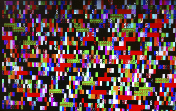

Then I am followed with a screen full of random multi-coloured blocks where I guess the video is trying to be initialised?

Then the screen shows the multicoloured blocks as I've seen previously.

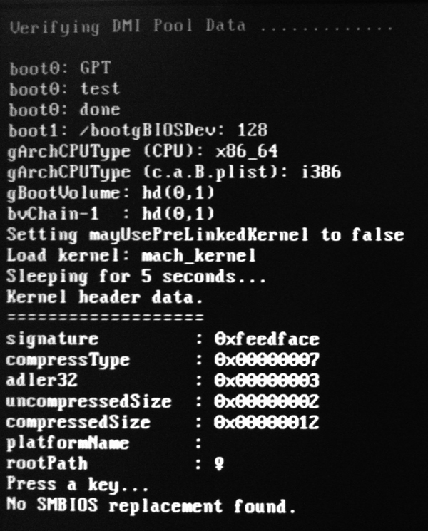

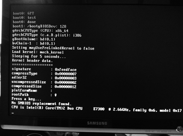

patch applied and I now see more info.. To save typing I have attached a photo.
(Note: this was from using my previous settings.)
EDIT: This is with #define DYNAMIC_SMBIOS_DATA_GATHERING 1
and #define DYNAMIC_CPU_DATA_GATHERING 1
And at least it finds the mach kernel and config file now. Which is a step forward. What if you set the second line to 1?

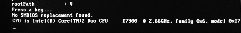

It appears to be stuck in SMBIOS patcher. Have you replaced my data with yours?
All I've changed is my private_data.h but as I'm now using dynamic then this doesn't get used?
Please check function sm_get_cputype and sm_get_bus_speed in dynamic_data.h because there you will need to change the #if CHAMELEON into #if 1 // CHAMELEON or it won't do anything.

another step forward.. I now have CPU identification.
But then I get to the coloured blocks...

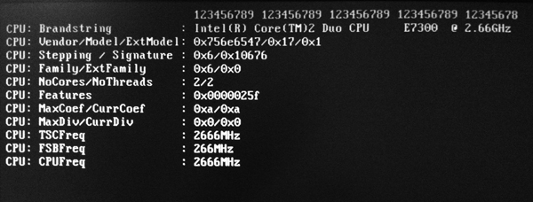

You are almost there. Open cpu/dynamic_data.h and make it dump the CPU info.
Okay - adding #define DEBUG_CPU 1.
will rebuild and reboot. - back shortly.
EDIT:
using DEBUG_CPU 1

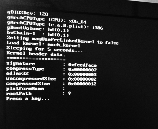

after I see Verifying DMI Data Pool, the screen is cleared and then the debug info is drawn. But after 'Press a key' appears, nothing happens.. The keyboard lights for Caps Lock, scroll lock etc. still work but there's nothing else I can do here.
Where as without DEBUG_CPU 1
The debug info follows the Verifying DMI Data Pool without the screen being cleared, and I see more output (but obviously no CPU data).
Then the screen shows the multicoloured blocks before crashing.

Make sure you set DEBUG_CPU to 1 in libsaio/cpu.c I just checked it here and it works, so if you don't get to see it, something is not right. Not to mention that this function is called ahead of almost everything, meaning that it has to work. Otherwise you won't get this far. The only problem I'm having, without the actual CPU info, is what the frequency is set to.
Doh!... thanks DHP - I had it in cpu/dynamic_data.h ?? That's why you're the coder and I'm the tester.. Lol.
Here's the feedback:

gBootVolume			 : hd (0,1)
byChain -1				: hd (0,1)
rootVolume			   : hd (1,2)
byChain					: hd (0,1)
Setting mayUsePreLinkedKernel to false
Load Kernel	: mach_kernel
Sleeping for 5 seconds
Kernel header data
Signature				  : 0xfeedface
CompressType		  : 0x00000007
adler32					 : 0x00000003
uncompressed size	 : 0x00000002
compressed size		: 0x00000012
platformName			:
rootpath					: ♀
Press a key
then
No SMBIOS replacement table found
LoadingACPITable (DSDT)
then to grey screen with apple and no throbber
Thats enough for today, getting ready to party. Happy New Year all.
You did well DB1 - and I see you managed to get the LoadingACPITable message to appear :)

I also have the LoadingACPITable message, it was due to the DEBUG_CPU 1 setting. Changing this back to 0 allows the CPU identification, No SMBIOS replacement and LoadingACPITable messages to appear.

Success at last! :wacko:
Finally booted to desktop with 634 by moving DSDT.aml from /Extra to /Extra/ACPI (Doh!) which fixed the KP and then commenting out the following lines in boot.c:

However, I already have my DSDT.aml in /Extra/ACPI and after making the above code changes, there's unfortunately no difference here.
What happens is I get the debug info from boot.c and drivers.c, press a key and get the dumped ACPI base address, the kernel loads and I immediately get the "Unable to find driver for this platform" KP and the 'You need to restart your computer' message appears. So we know the kernel has been found but there is a failure in the provision of the SMBIOS table..
And I don't get as far as you had been as I don't get to see the "Unable to find driver for this platform" KP. I get to the same place as DB1 where the last message seen is "LoadingACPITable (DSDT)".
EDIT:
I just tried using #define DUMP_ADDRESS 1 as I saw in your list above. This now shows me the following on a freshly cleared black screen, after the LoadingACPITable (DSDT) message:
baseAddress: 0xf7150
I then get a different looking garbled screen to the multicoloured blocks I had been seeing before, though unfortunately not a booted system.
