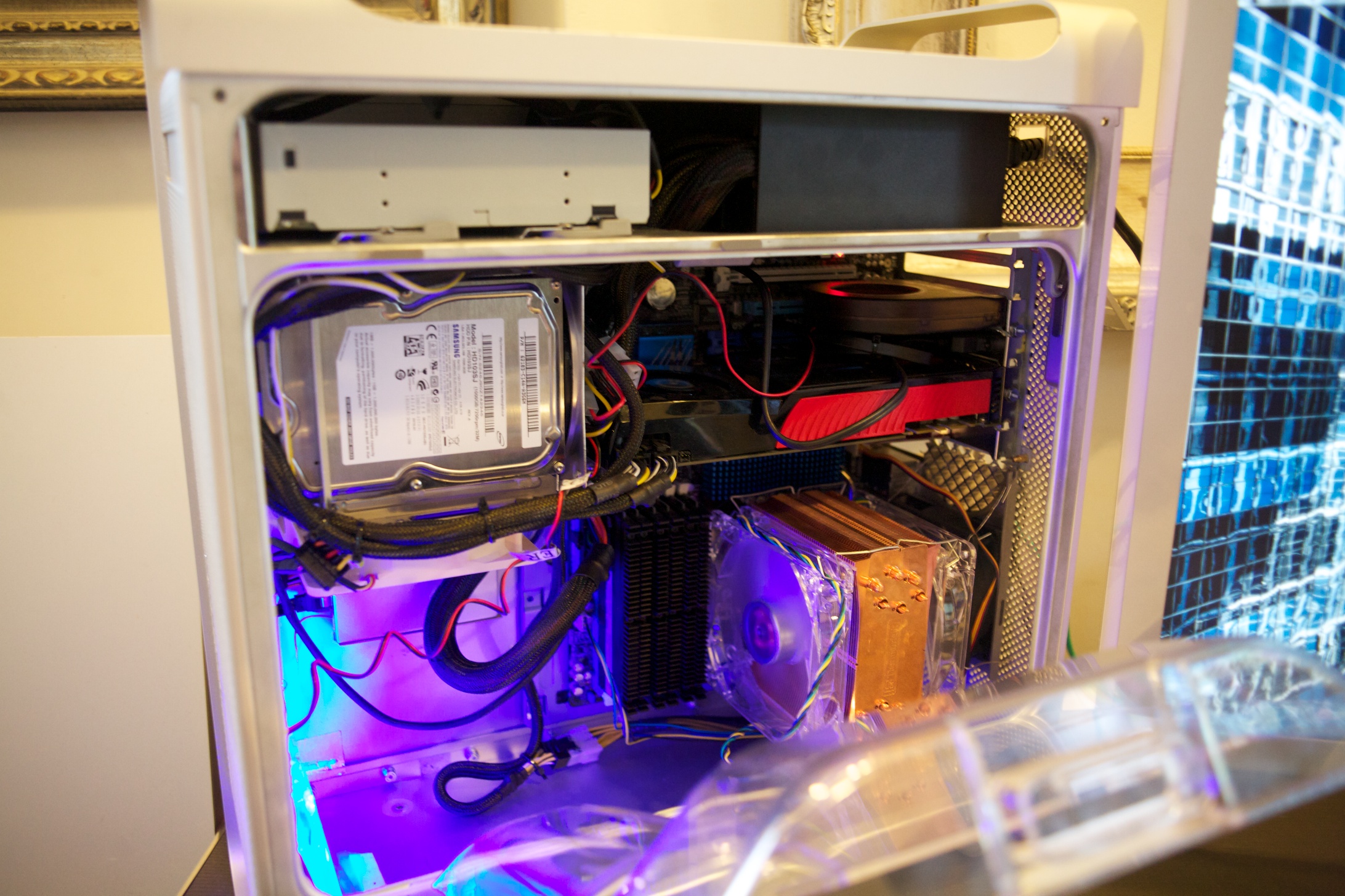

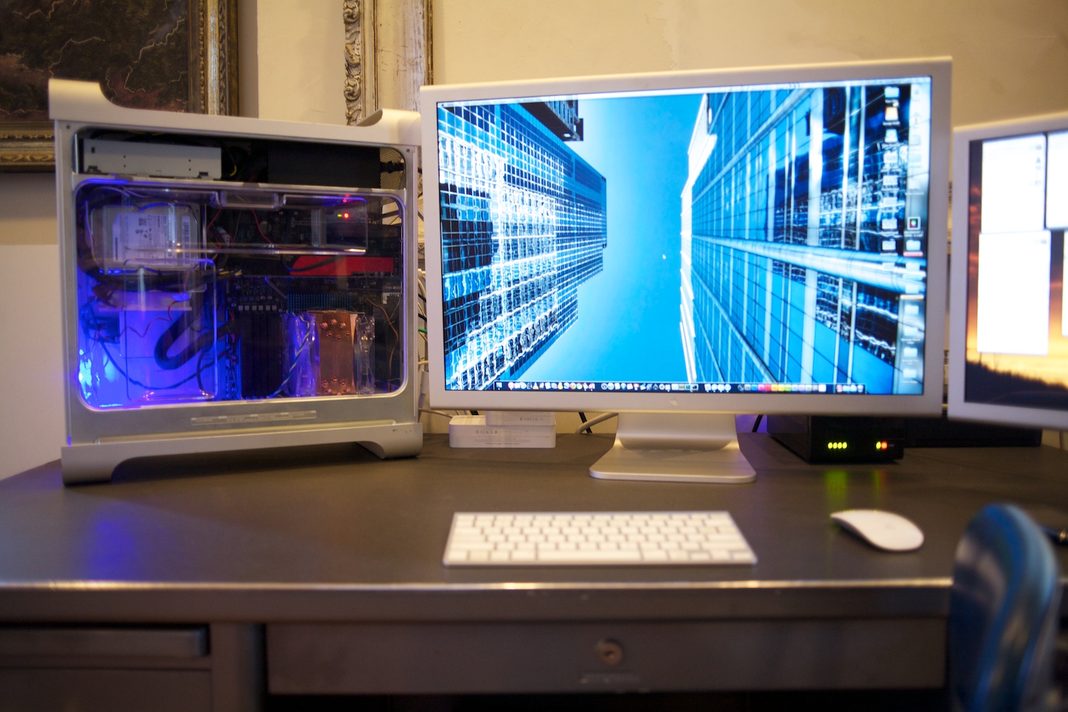

smeared Posted March 13, 2010 Author Share Posted March 13, 2010 Just a quick update: seasonic 850w PSU installed and this time no coil whine I hooked up the front panel power button and led, but didn't get tot he usb, or headphones yet. ignore the blue fan, that's being replaced when my enermax fan gets RMAd. I don't really like lights inside computers. I need to clean up my cable management sometime in the near future, but it's pretty packed in there, so not sure how much better it's going to get. My temps are great, even with the side on, my motherboard is right at 31°C and my processor overclocked to 4ghz I am stable at 37°C Idle, and 66°C full load after an hour. all three hd temps are at 28, 29, and 28 thanks to the noctua fan mounted underneath them. All in all.. Pretty much done. Waiting on a new external esata RAID enclosure for backups, and then I'll call it quits. Link to comment Share on other sites More sharing options...
