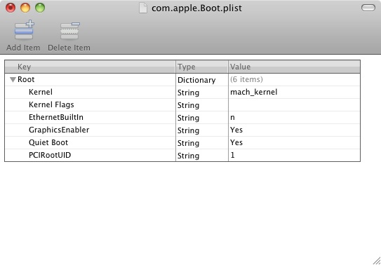

Using GraphicsEnabler=Yes in com.apple.Boot.plist
***If you are using Gigabyte mother board and installing AsereBLN's boot and not using DSDT.aml, you need to add PCIRootUID=1 in com.apple.Boot.plist.
Example of com.apple.Boot.plist
<plist version="1.0">
<dict>
<key>Kernel</key>
<string>mach_kernel</string>
<key>Kernel Flags</key>
<string></string>
<key>EthernetBuiltIn</key>
<string>n</string>
<key>GraphicsEnabler</key>
<string>Yes</string>
<key>Quiet Boot</key>
<key>PCIRootUID</key>
<string>1</string>
</dict>
</plist>

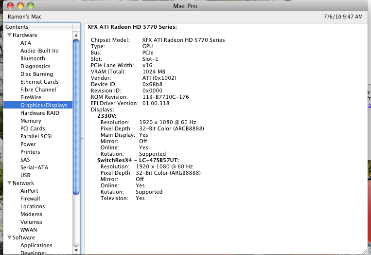

Device_ID of HD5770 is 0x100268B8.
Device_ID of HD5750 is 0x100268BE.
Please use GPU-Z to check it and post it. Thanks.
GPU-Z shows 68B8 too.
since i'm at work ,so i will upload the screen shot after i get back home.
ps: The hardware ID in Windows Device Manager also shows as VEN_1002 & DEV_68B8
maybe the saler give me a 5770 ? ;)
So, go ahead to try my edited boot.
Don't forget remove ATY_Init.kext.
Add GraphicsEnabler=Yes in com.apple.Boot.plist

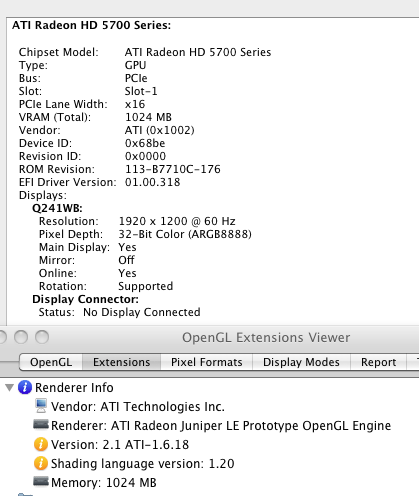

Yeah, My 5750 Shows
Vendor: ATI (0x1002)
Device ID: 0x68be
You probably got lucky and got a 5770. I'm using netkas ATY_init.kext 5750 working good with QE/CI, for odd reason OpenGL Extensions show ATI Radeon Juniper LE Prototype OpenGL Engine? Anyway to get back into 64bit would be great, but I'm pretty sure i'll end up with KP with tmongkol's solution?
