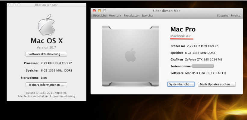

quattrofx Posted July 13, 2011 Author Share Posted July 13, 2011 Further Tests: Yesterday I´ve played with Model identifier changing smbios.plist for MacPro4.1 instead of iMac11.1 and all Tests showed similar results. I noticed only one cosmetics failure: About My Mac saying: MacBook Air! I don´t know is it coming from SN or elsewere? Successfully installed iState Pro as a Dashboard Widget. To be able to see Termal sensors and Fans, i needed to delete FakeSMC.kext (without Plug-ins) from Extra/Extensions and install new FakeSMC.kext with Plug-ins ins System/Library/Extensions directory. Repaired permissions on Lion, cleaned the Cash with Coctail 5.0 Public Beta, and rebooted. Instead of 7 spinning wheels with FakeSMC in Extra, now takes it 10 with new SMC in S/L/E! Presume, because of loading additional Plug-ins. Installed MacBlu-ray Player V1.0.0 and Plex Streaming Server without problems. I am installing Remote Buddy right now and wont to test my IrC infrared receiver OVU4003 with Apple Remote... let´s see... Link to comment Share on other sites More sharing options...
quattrofx Posted July 23, 2011 Author Share Posted July 23, 2011 Next: - Successfully enabled Trim for SSD with the new Trim tool V1.2: http://www.groths.org/?p=387 - About wrong Model name showing in "About my Mac" I can definitely tell that depends on your SMBoardProductID and SMSerial in your smbios.plist. I found appropriate Serial number for MacPro 5.1 Mid2010 and now it shows right. Try to Google for yours or create your own according to Prasys´ Blog: http://prasys.info/2009/11/understanding-mac-serial-number/ additional link to find appropriate SMBoardProductID for your System: http://www.insanelymac.com/forum/index.php...p;#entry1594721 - Installed Remote Buddy successfully and my IrC infrared receiver OVU4003 working perfect with Apple Remote now. Link to comment Share on other sites More sharing options...
