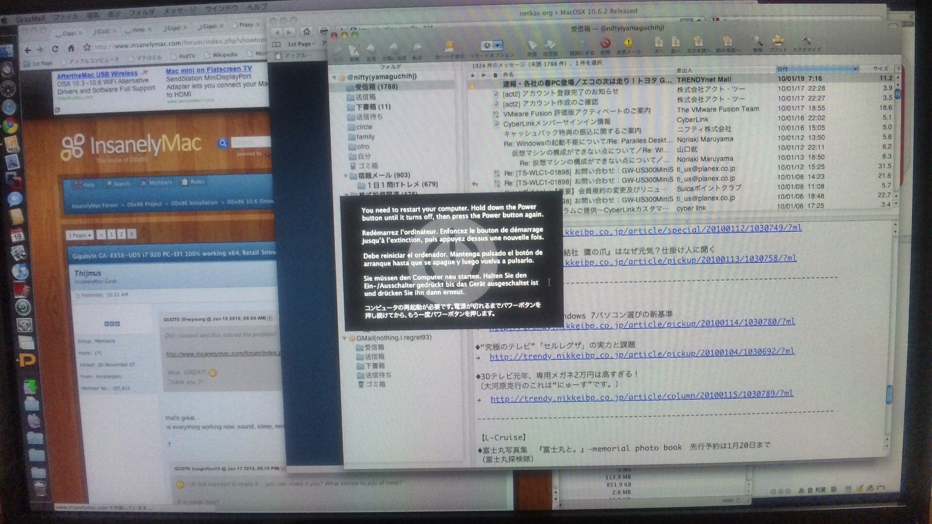

I tried your new installer V3.3.
But unfortunately result was the same.
I can't get diaplay any other res than 1024x768(my display can show 1920x1080).
Don't you have any suggestions?
Thank you anyway.
I'm so sorry for bothering you.
Fineyoung.

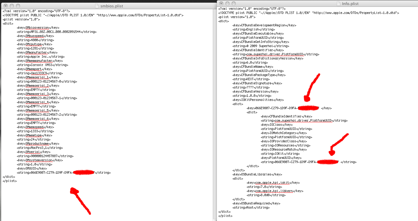

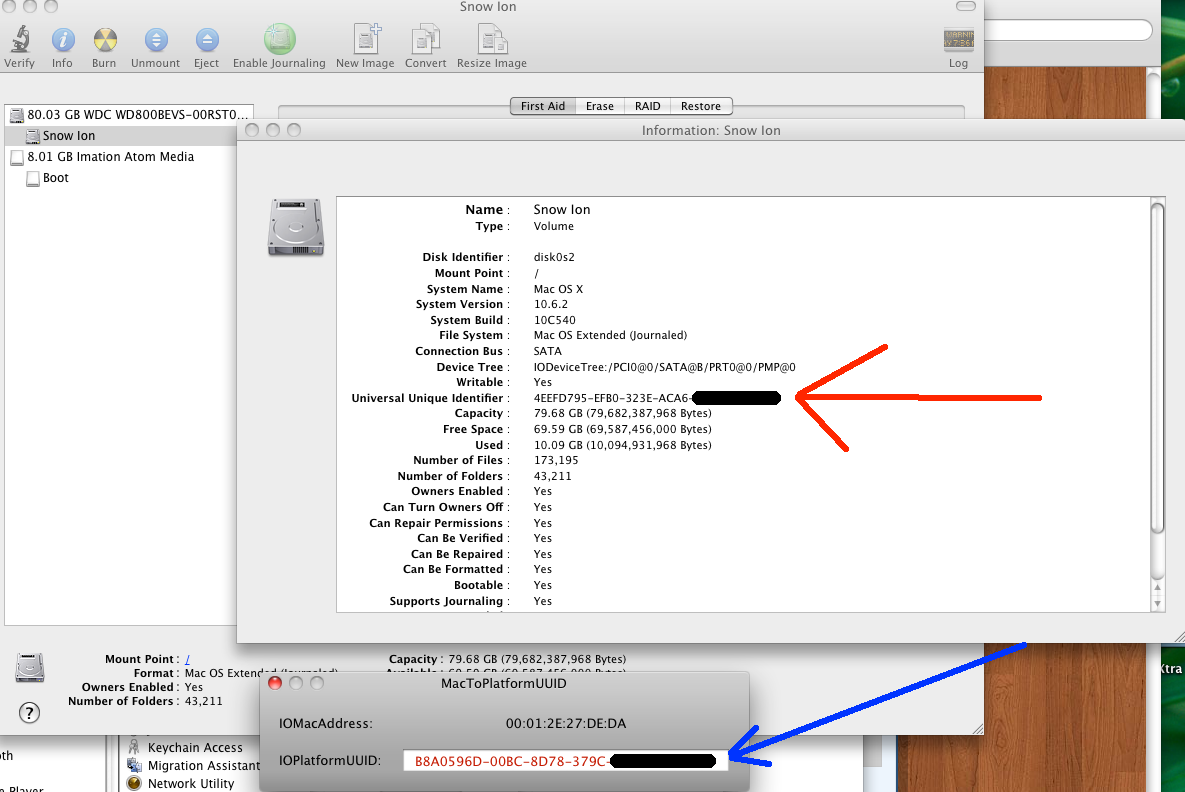

@ Thijmus ....Copy uuid info to Smbios and Platformuuid.kext (2 places).how it is made?
Thanks
use MacToPlatformUUID app. (locks on mac address) or get it from system hd (disk utility > click main partition > click info)
T
T

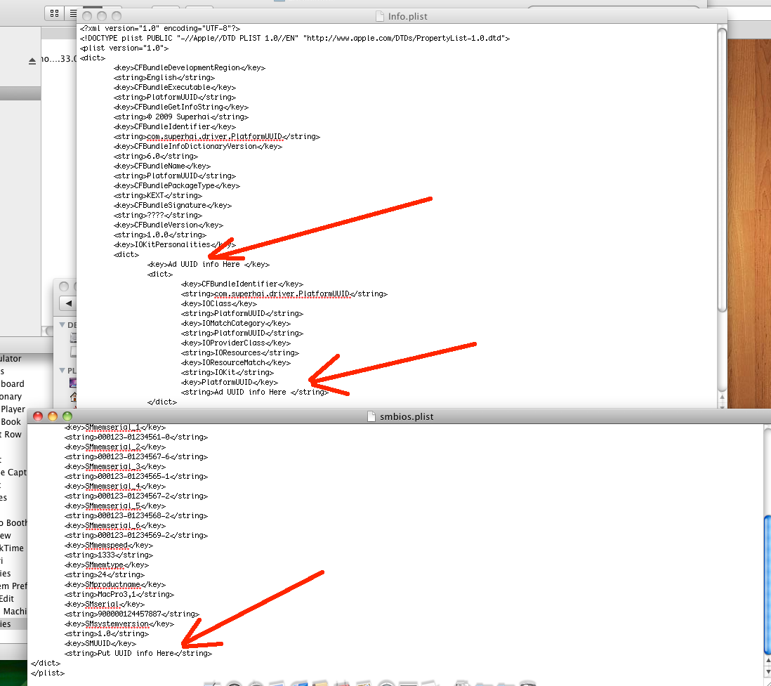

:D Sorry...you can make a screen?Please...thanks
Sorry, but I have not understood the 4 well passage.
PS:Sorry for my bad english ;)
:( Sorry...you can make a screen?Please...thanks
PS:Sorry for my bad english :rolleyes:
copy red or blue to red pic 2 (smbios.plist and info.plist > PlatformUUID.kext)
T

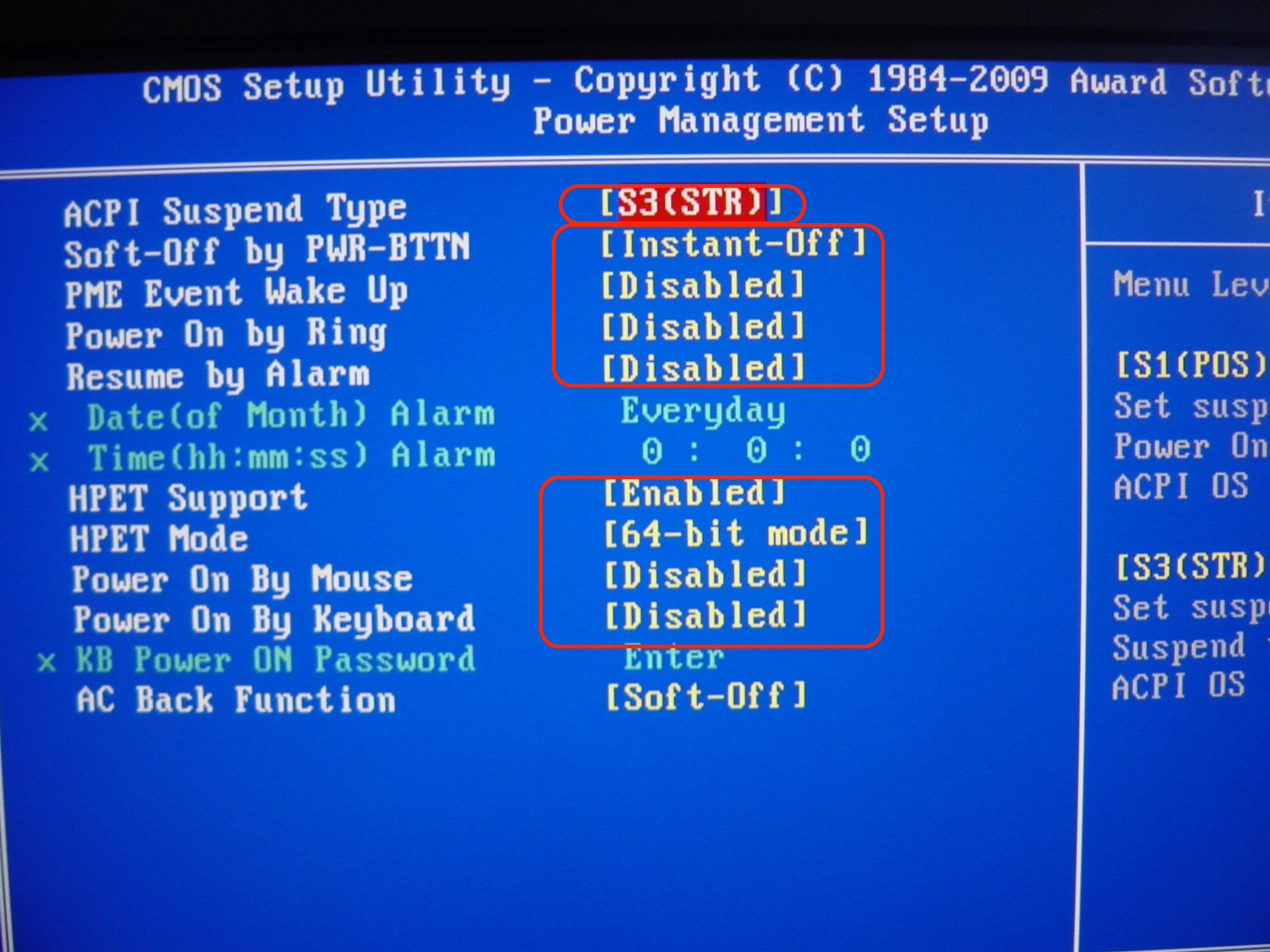

you don't need NullCPUPowerManagement.kext because you use my dsdt.
if sleep is failing check bios setting's and check options Energy saver (see picture)
T

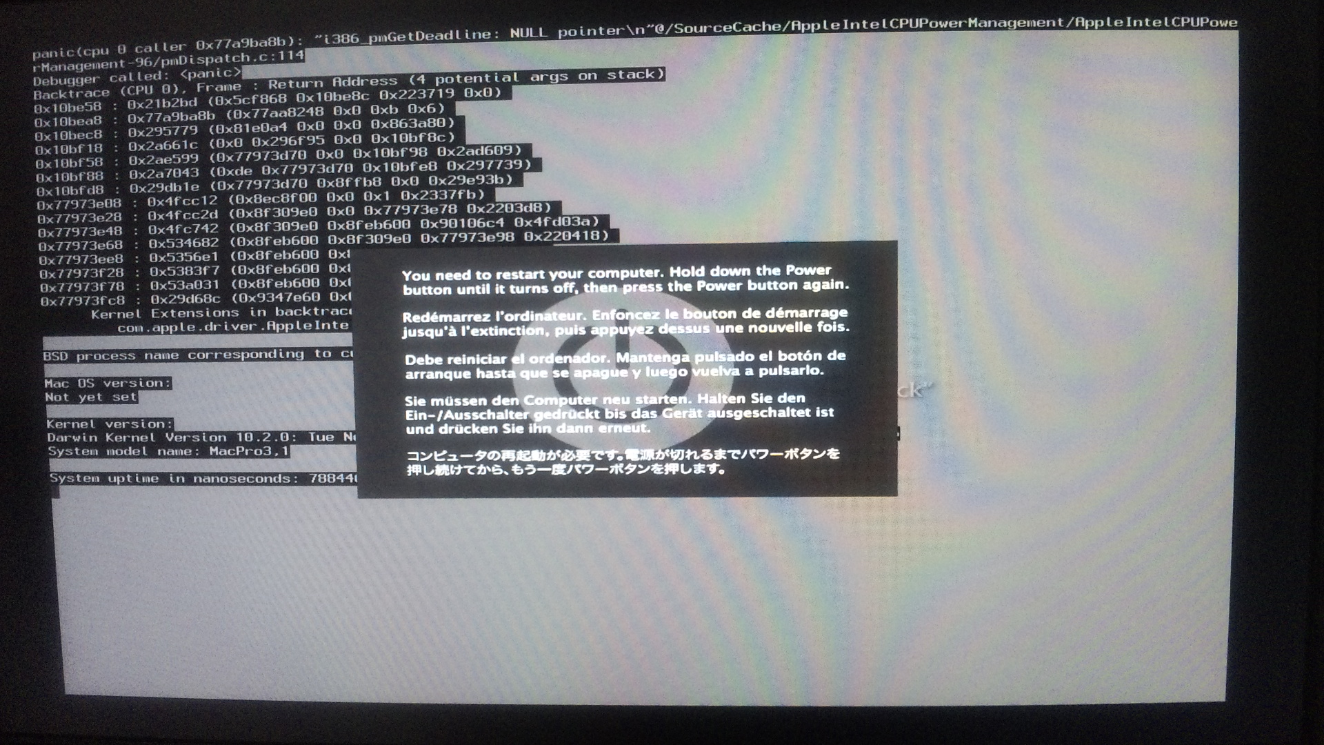

Unfortunately, without NullCPUPowerManagement.kext , KP occurs with AppleIntelCPUPowerManagement.kext when I start the system.
And, with NullCPUPowerManagement.kext, KP also occurs 30 sec. ~ 1min. after I wake the system.
FY

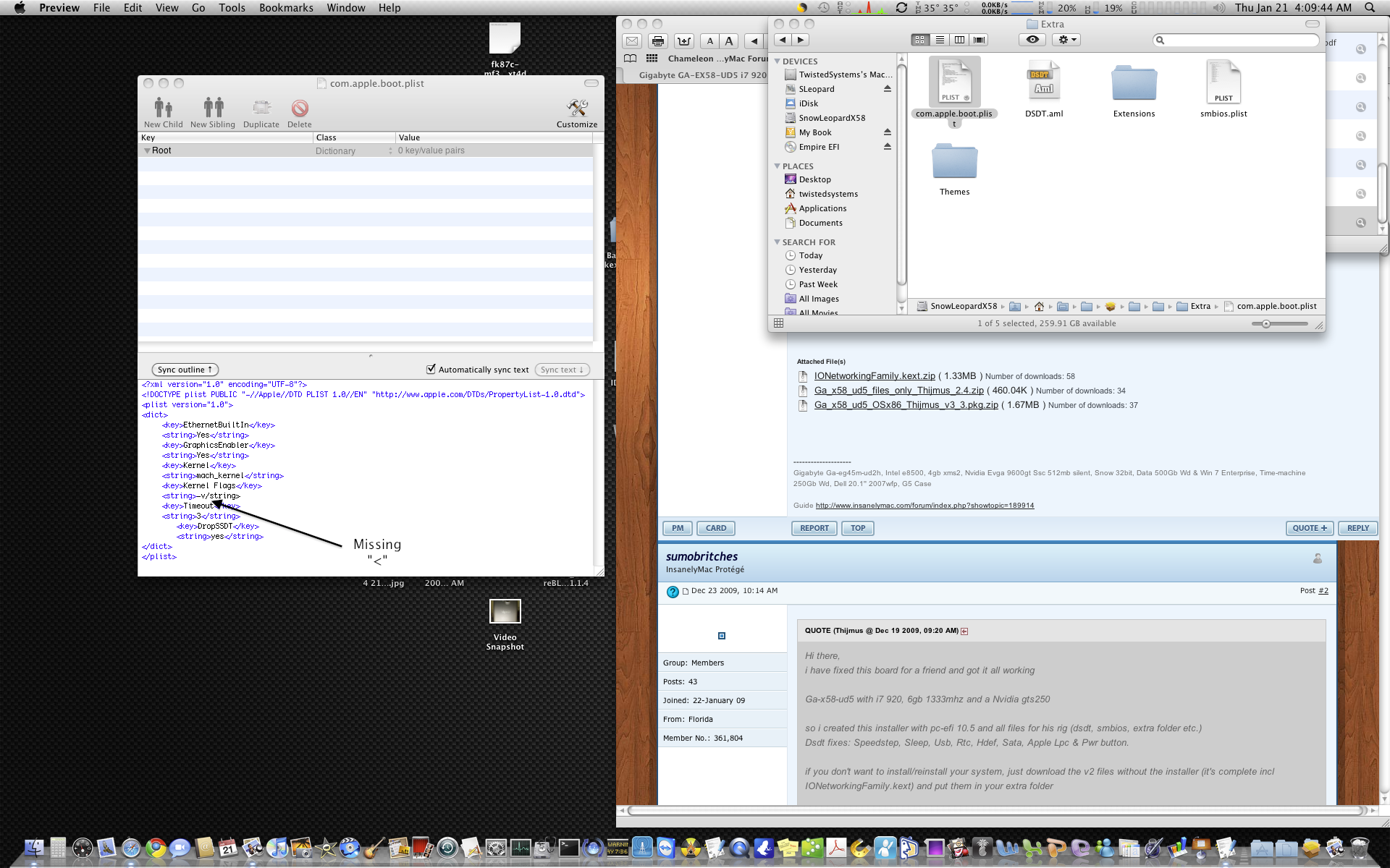

Thijmus,
I have found a issue regarding your installer, look at the boot.plist in the 3.2 and 3.2 installer. It's missing the bracket for <string>-v/string>, should be <string>-v</string> instead. Pic shows original plist. Just thought to let you know, looking out for you. Maybe this this can help with any problems that have been coming up lately. :(
Thijmus,
thnx. did not see that.
first post updated
