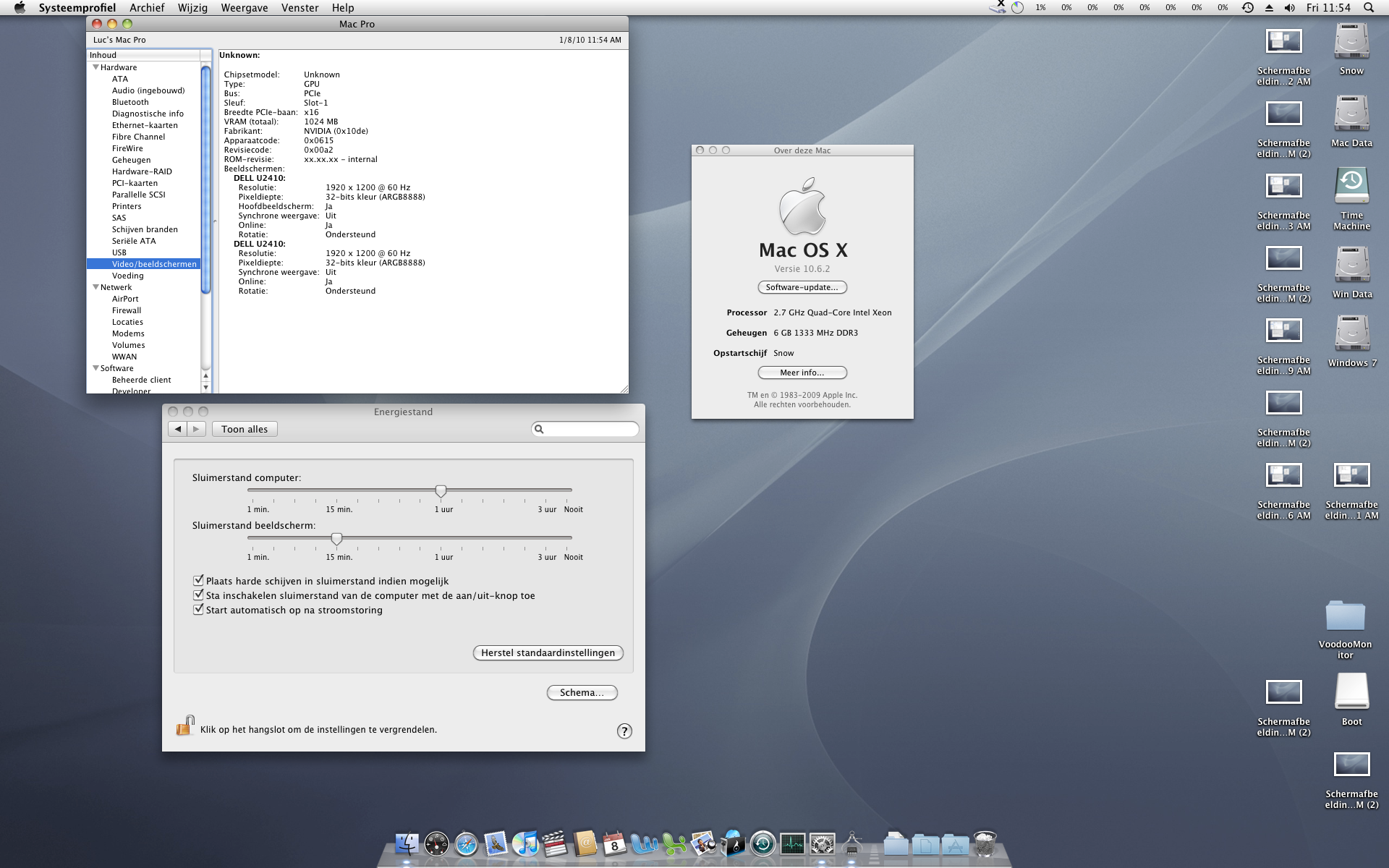

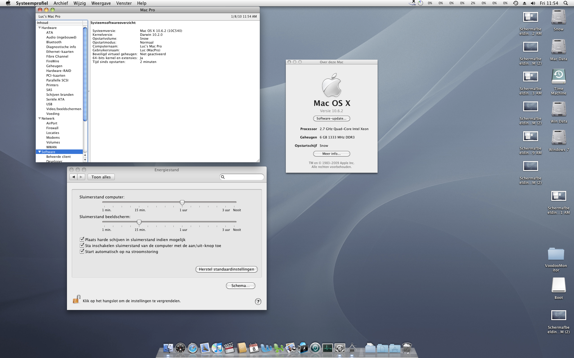

Hi there,
i have fixed this board for a friend and got it all working
Ga-x58-ud5 with i7 920, 6gb 1333mhz and a Nvidia gts250
so i edited an existing installer with pc-efi 10.5 with all files for his rig (dsdt, smbios, extra folder etc.)
Dsdt fixes: Speedstep, Sleep, Usb, Rtc, Hdef, Sata, Apple Lpc & Pwr button.

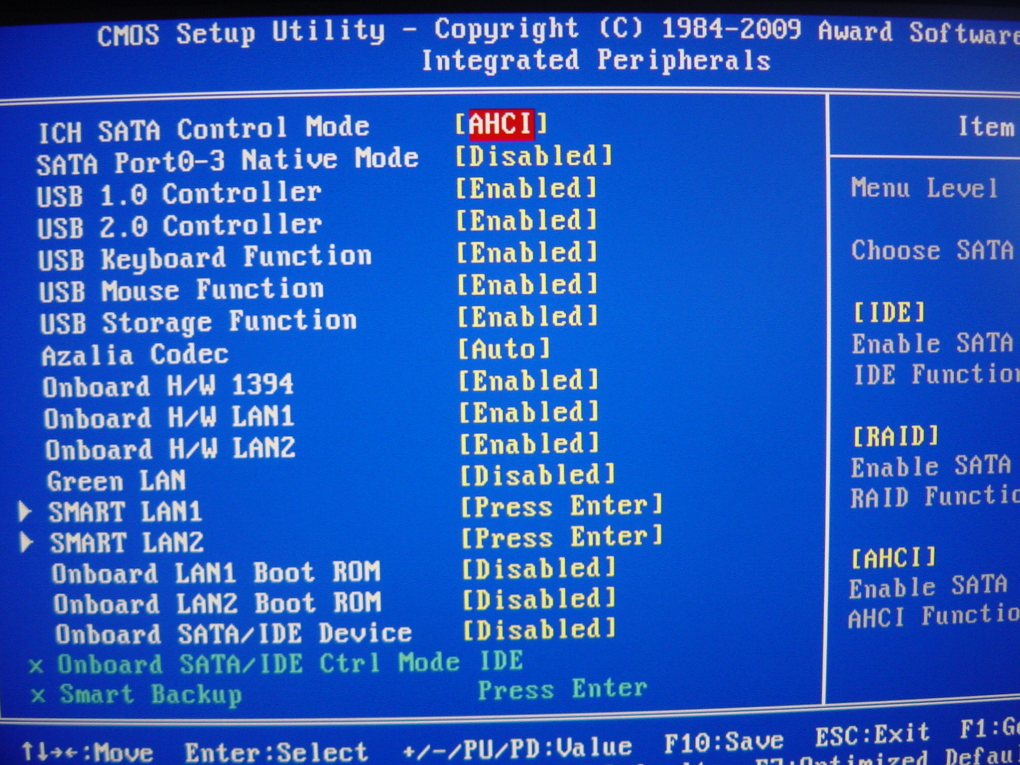

Bios setup (see pictures)

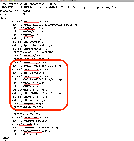

Edit the the Smbios.plist for diff. Memory and system info.
U can use MacToPlatformUUID.app to obtain the Uuid info

Wow, this is incredible stuff to read about. i just sent you a PM but let me know on how to do this for someone like me with not a ton of knowledge after months of attempting to get my system to work right. I do have a Mac Pro that i've used to install retail Snow Leopard on my main HD for my build, and got it working about 98%. Sleep doesn't wake from keyboard/mouse and graphics aren't 100% fluid.
Ok so I downloaded all the files you have attached, I notice there's not a EFI String in the apple.boot.plist....can you include that too? my video card is the same: Nvidia GTS 250 1gb.
How would I go about using these files? just replace them such as the DSDT and apple.boot.plist? where do i place the extensions at? and the x58 "installer" says its for the UD3 board, not the EX58, but i'm guessing they're compatible? do i just install this after having retail SL on my machine yes?
alot of dumb questions, but let me know thanks

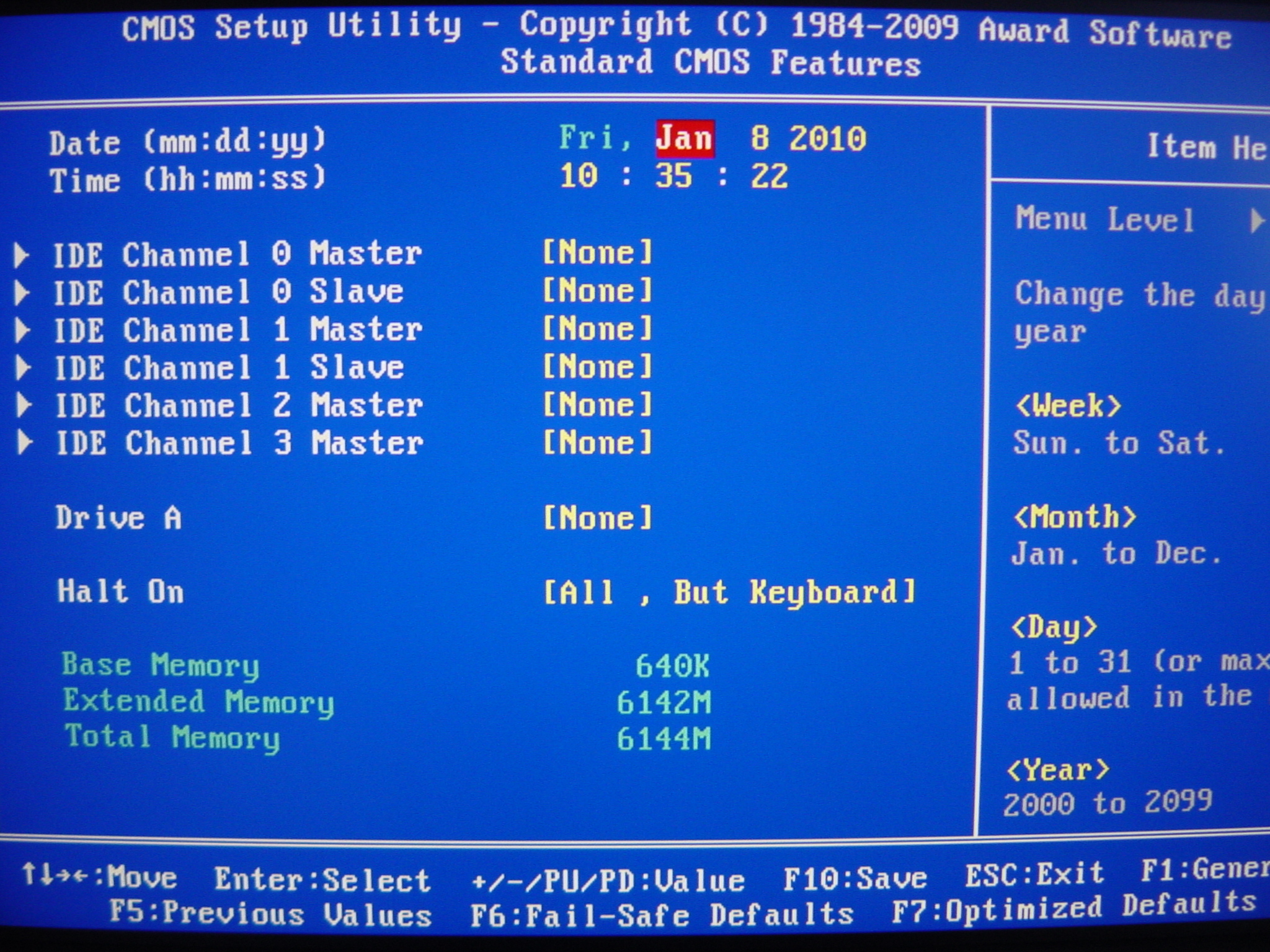

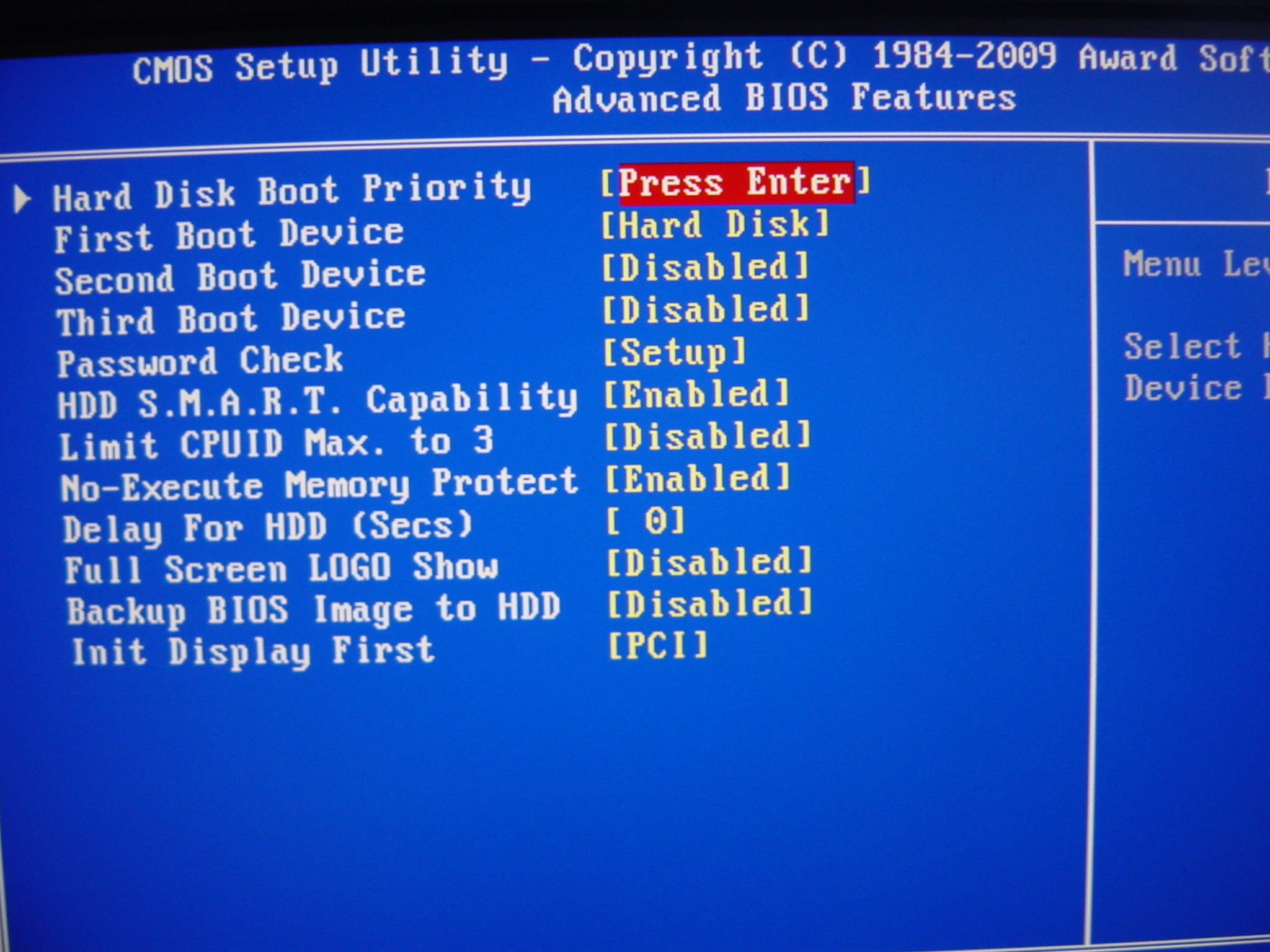

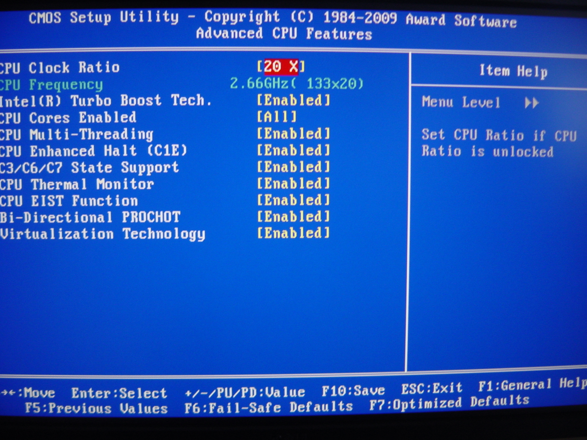

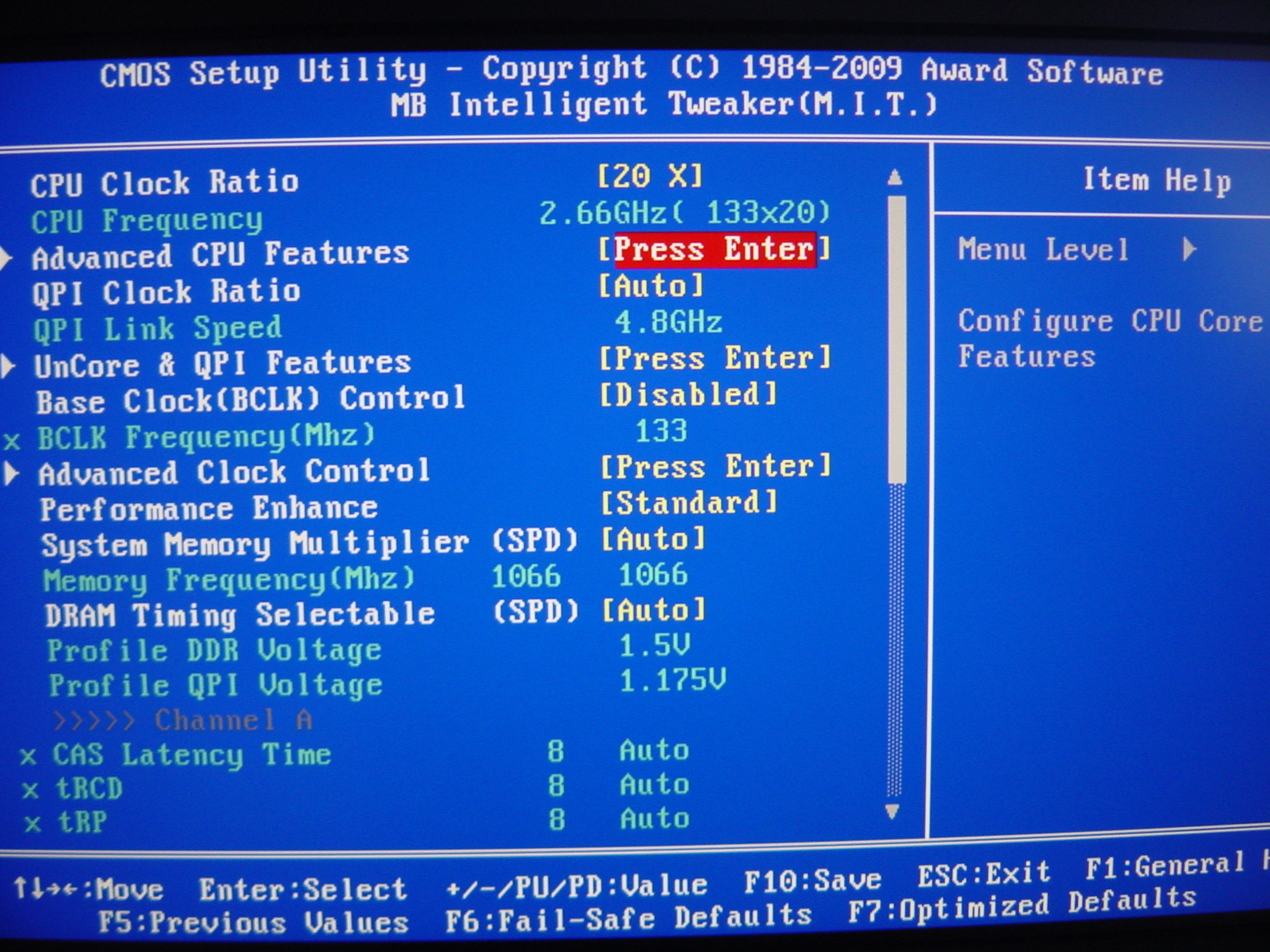

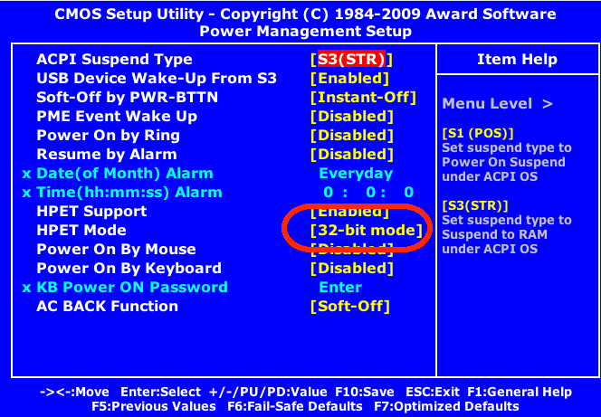

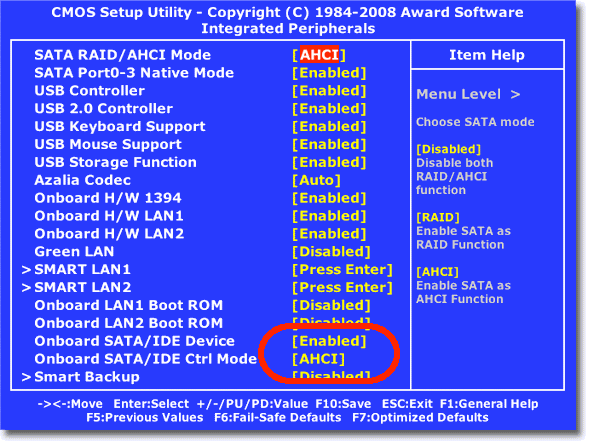

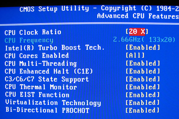

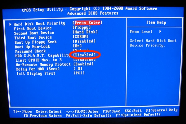

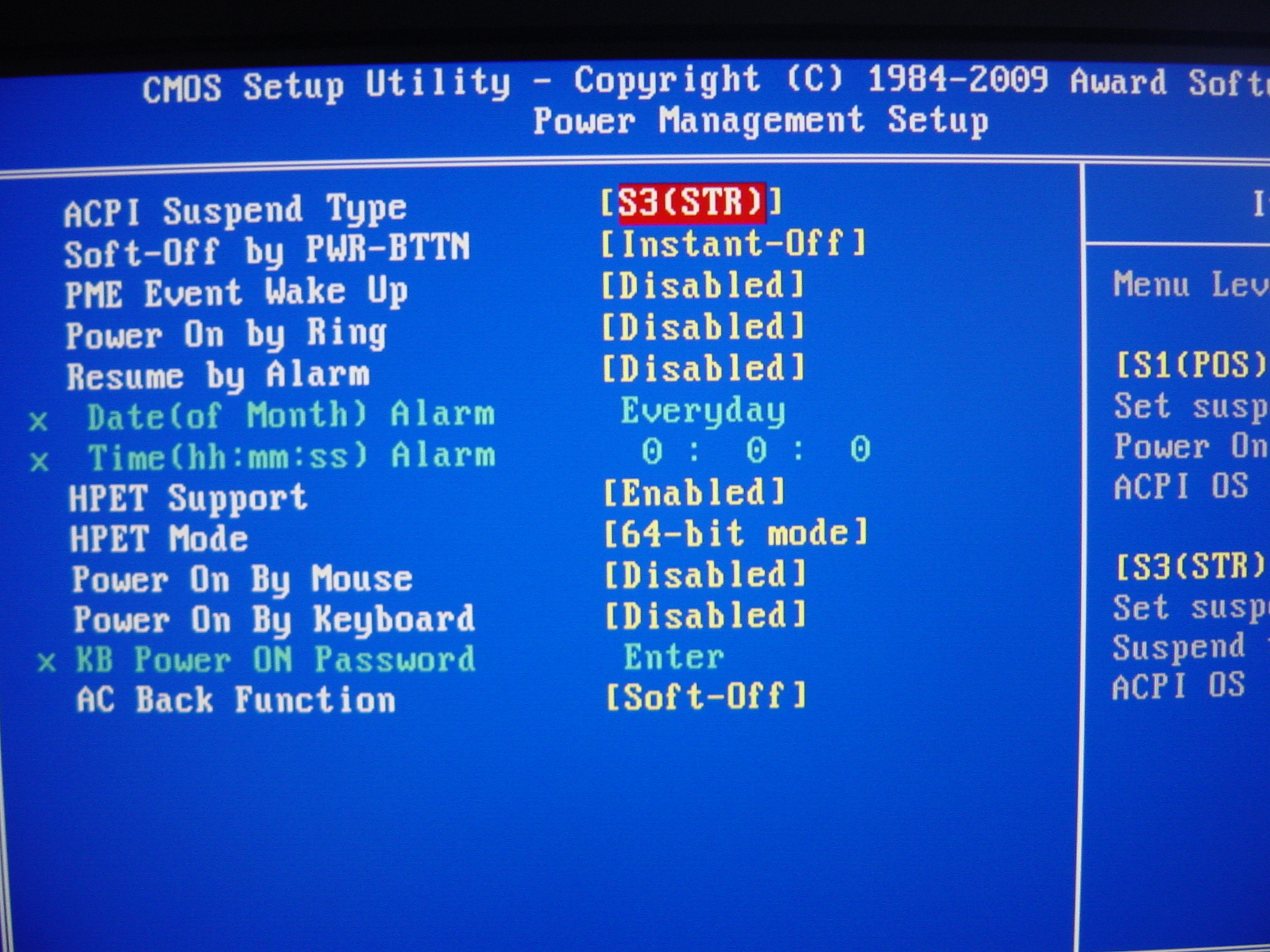

let's start with the bios setting's
1. disable sata ide (rest like on first pic)
2. cpu
3. enable hd smart (rest like on pic)
4. hpet set to 64-bit (rest like on pic)

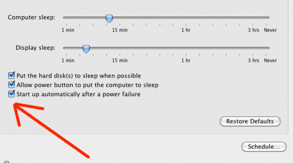

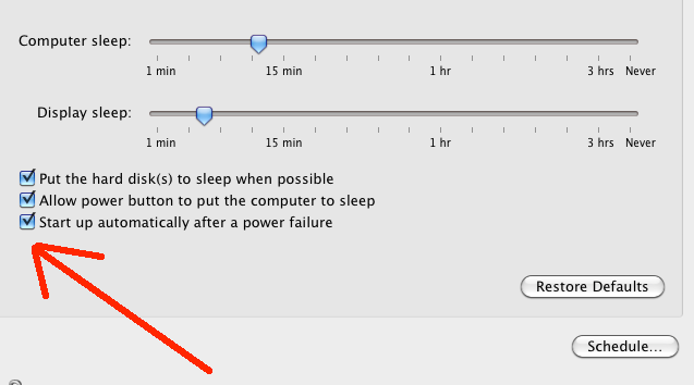

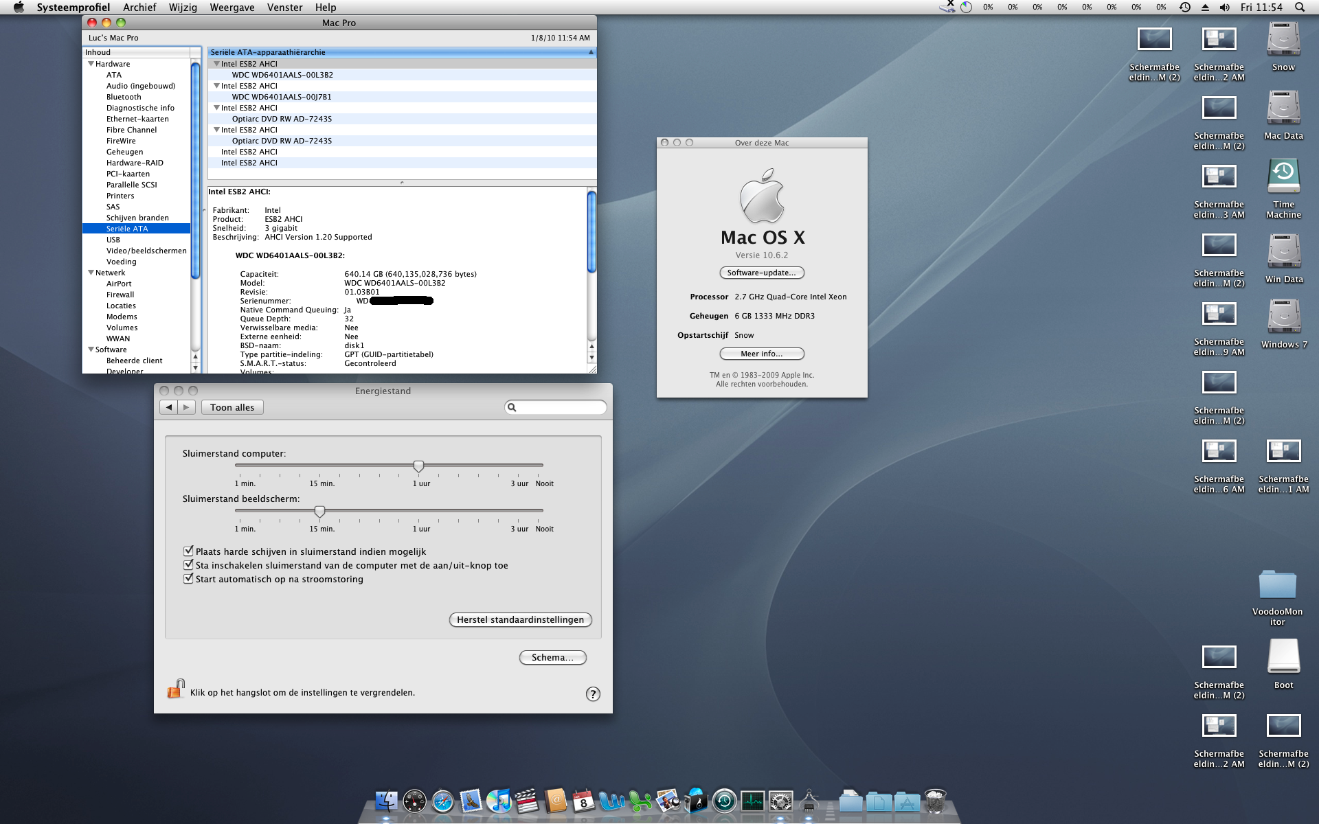

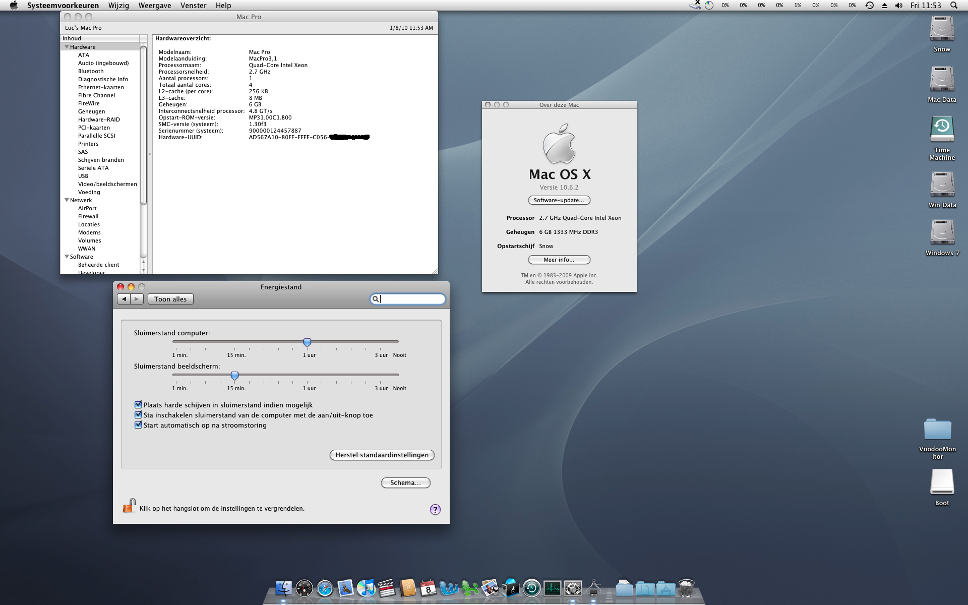

don't forget in system pref energy sett. see 5th picture

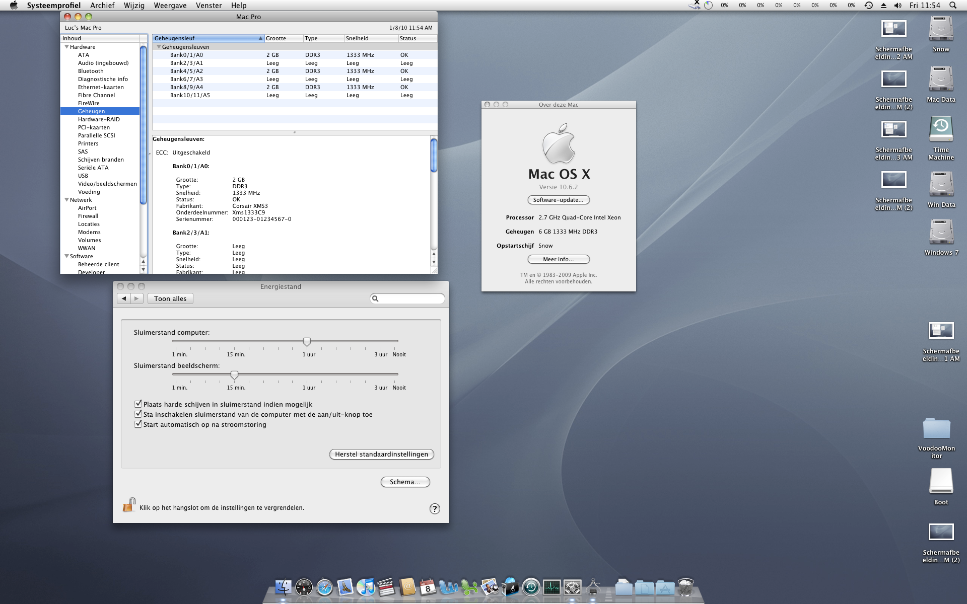

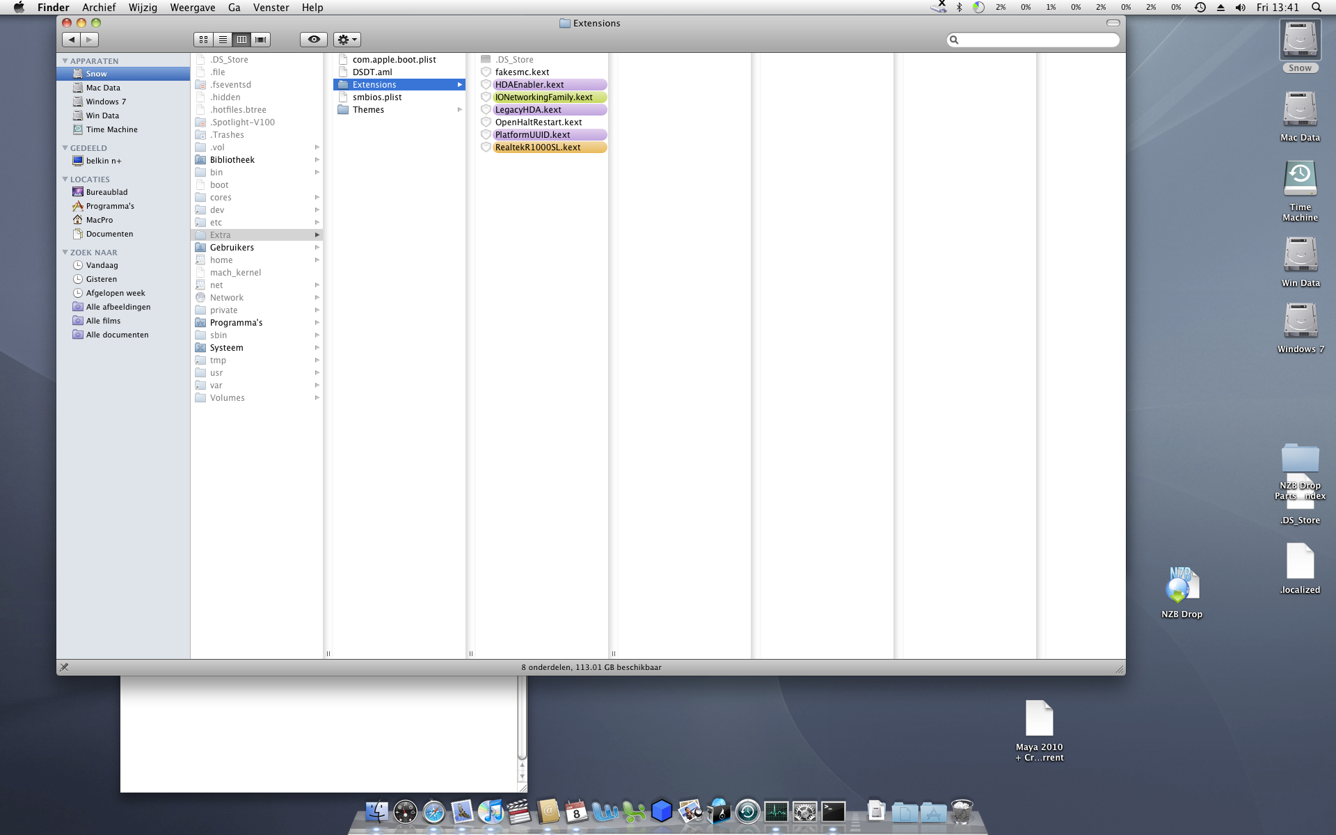

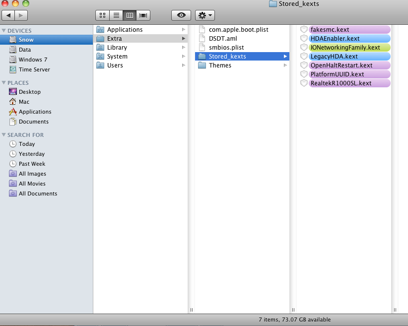

after install extra folder have look like the last pic
2. cpu
after install extra folder have look like the 5th picture
don't forget in system pref energy sett. see last pic

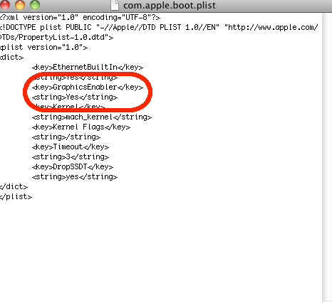

edit the smbios.plist for memory and cpu info
string for video it in the com.apple.boot.plist
<key>GraphicsEnabler</key>
<string>Yes</string>
you may also ad -v to com.apple.boot.plist to see the errors
<key>Kernel Flags</key>
<string>-v/string>

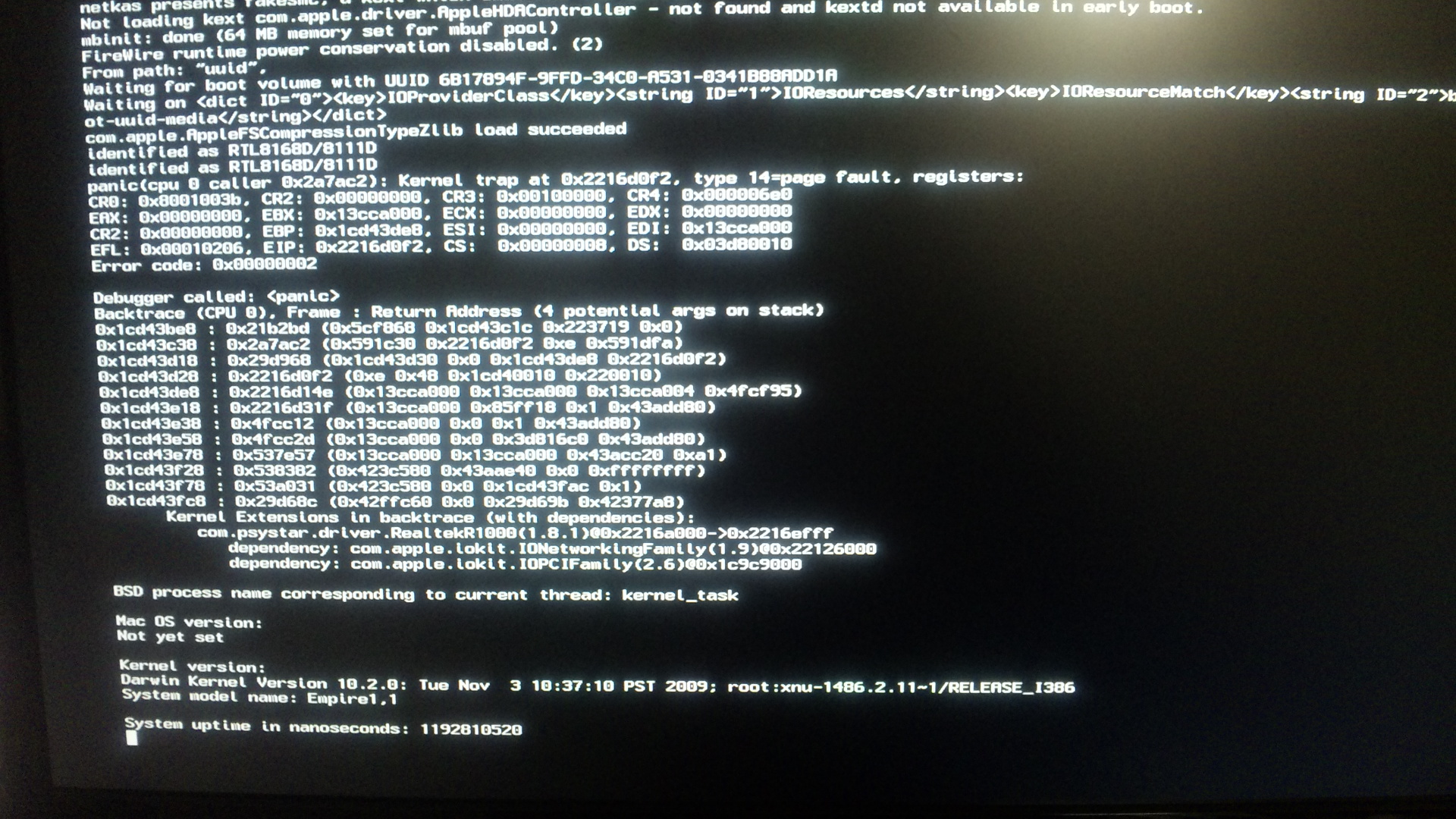

Hello, I'm Japanese trying to build my OSx86 machine.
My system configuration is exactly the same(GA-EX58-UT5, Core i7 920 6GB 1333Mhz memory and nVidia GF GTS 250.
I need help.
I tried the installer v3.2 and reboot my machine, but it doesn't work well.
Startup screen appears, but OS starting procedure doesn't go further.
What kind of trouble can you think of and what should I do to solve this problem?
Please tell me.
Thank you in advance.
P.S. I rebooted my system and took a screen shot.
It stopped at:
BSD process name corresponding to current thread: kernel_bask
Mac OS version:
Not yet set
Kernel version:
Darwin Kernel Version 10.2.0: Tue Nov 3 10:37:10 PST 2009; root:xnu-1486.2.11~1/RELEASE_I386
System uptime in nanoseconds: 1192810520

hi there,
can you test without the realtecr1000.kext and ionetworkingfamily.kext
also check bios setting's
T.
Looks like IOnetworking.kext is failing for 10.6.0

Unfortunately, I tried but my system still doesn't work well.
Kernel panic has stopped ,but after boot sequence is finished, the screen turns black.
It seems that the system lost connection with the screen.
(The screen alarms "No signal".)
Does someone know the cause of this problem and how to deal it?
I'm a bit loss what to do next.

it installs the bootloader and all necessary files to a partition
click on show package contents > resources > extra
T.

did you use any of these files?
smbios.plist
dsdt.aml
T
Yes, I use all of them.
Is there something to do with it?
Fineyoung.
well your video card should work native with pci-efi (booloader) and with
the same for your memory. check smbios.plist
maybe you did put your card and memory in different slots
will be at my friend this afternoon so more info later
T.
T.

I tried your new installer V3.3.
But unfortunately result was the same.
I can't get diaplay any other res than 1024x768(my display can show 1920x1080).
Here's my com.apple.Boot.plist:
<!DOCTYPE plist PUBLIC "-//Apple//DTD PLIST 1.0//EN" "http://www.apple.com/DTDs/PropertyList-1.0.dtd">'>http://www.apple.com/DTDs/PropertyList-1.0.dtd">
<plist version="1.0">
<dict>
<key>EthernetBuiltIn</key>
<key>Kernel</key>
<string>mach_kernel</string>
<string>-v/string>
<key>Timeout</key>
<string>3</string>
<key>DropSSDT</key>
<string>yes</string>
</dict>
</plist>
Also, here's my simbios.plist:
<dict>
<key>SMbiosversion</key>
<string>MP31.88Z.00C1.B00.0802091544</string>
<key>SMbusspeed</key>
<string>4800</string>
<key>SMcputype</key>
<string>1281</string>
<key>SMmanufacter</key>
<string>Apple Inc.</string>
<key>SMmemmanufacter</key>
<string>Corsair XMS3</string>
<key>SMmempart</key>
<string>Xms1333C9</string>
<key>SMmemserial_1</key>
<string>000123-01234567-0</string>
<key>SMmemserial_2</key>
<string>EMPTY</string>
<key>SMmemserial_3</key>
<string>000123-01234567-1</string>
<key>SMmemserial_4</key>
<key>SMmemserial_5</key>
<string>000123-01234567-2</string>
<key>SMmemserial_6</key>
<key>SMmemspeed</key>
<string>1333</string>
<key>SMmemtype</key>
<string>24</string>
<key>SMproductname</key>
<string>MacPro3,1</string>
<key>SMserial</key>
<string>900000124457887</string>
<key>SMsystemversion</key>
<string>1.0</string>
<key>SMUUID</key>
<string>Put UUID info Here</string>
</dict>
</plist>
Don't you have any suggestions?
Thank you anyway.
I'm so sorry for bothering you.
Fineyoung.
