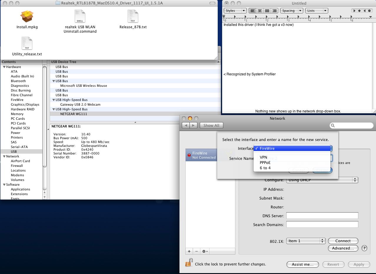

tainter Posted October 29, 2008 Share Posted October 29, 2008 I don't know if this is new info, but my current situation is shown in the attached picture. EDIT: Disregard the message in the picture. I checked with the Netgear website and I have the WG111v1! I've no clue where to go with this. Link to comment Share on other sites More sharing options...
geiman Posted October 31, 2008 Share Posted October 31, 2008 Don't know if this will help or not, but I use a Netgear wg111v2 as my primary network connection right now using drivers from here: http://www.realtek.com.tw/downloads/downlo...;Downloads=true Its under the L section This driver worked much better for me than the old one; the old driver constantly dropped connections or would not connect at all. This new one is much better. Link to comment Share on other sites More sharing options...
snifferdog Posted October 31, 2008 Share Posted October 31, 2008 I have the WG111v1! I've no clue where to go with this. Maybe buy another one. They are cheap enough. Sell the old one on eBay I am in the UK and I got mine from broadbandbuyer.co.uk, about 3 weeks ago. It cost me about £15. Link to comment Share on other sites More sharing options...

LOLRepair Posted January 10, 2009 Share Posted January 10, 2009 There are two different chipsets used on this dongle. One's the Realtek (as we all know works), and the other is the Sagem XG-703A. (Hurrah for taking things apart!) If you can't get the Realtek drivers to work, that may be the problem. As far as I've seen, they don't have Intel drivers out for the thing unless there's a prism54 driver for OS X. NETGEAR WG111: Version: 10.40 Manufacturer: GlobespanVirata ProductID: 0x4240 Serial Number: 3887-0000 Vendor ID: 0x0846 (Output from System Profiler, omitting Speed and Bus Power.) Link to comment Share on other sites More sharing options...
