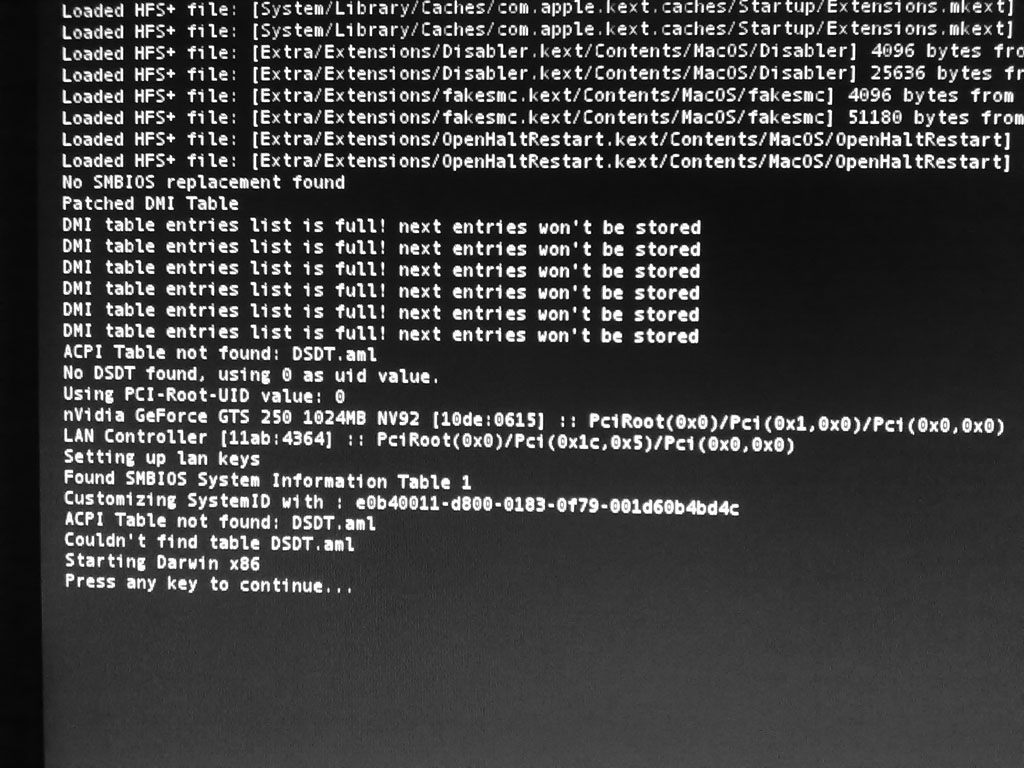

Not only that because getAddressOfSmbiosTable() is called three times here. Then DMI gets patched and some white garbage is moving from left to right over my screen before it reboots.
Looks like it is trying to patch it a few times in a row ;)

Attached my verbose mode booter output, there are 6x new repeating DMI related messages now.
So that it was ...
you have a bios that stores 68 tables and the limit was 64 ...
next version will handle that and the messages will disappear ;)

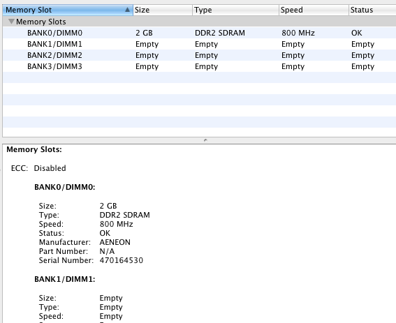

@rekursor latest build works, both DumpSPD and UseMemDetect functions does the job. :)
I noticed you moved stuff from prechameleon screen after OS is selected to sped up stuff :P
It does stall a bit on Smbios.plist but is better :(
Good job!

What is DumpSPD?
