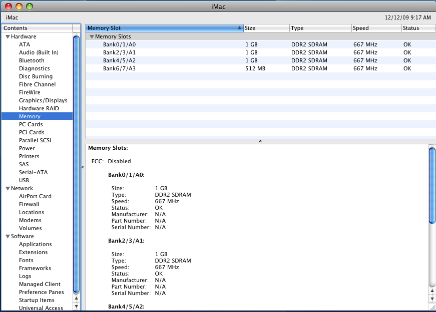

Konami® Posted December 12, 2009 Share Posted December 12, 2009 For the first time it recognizes the memory slots in system profile but with the wrong speed in 10.5.8, but at least is a great improvement over RC3 and PC-EFI 10.5 Link to comment Share on other sites More sharing options...
