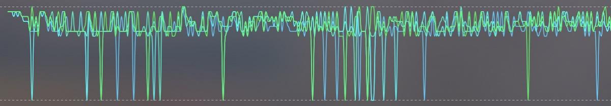

In Geekbench i get this in 32Bit:
I overclocked it to 4,13Gz, it Turbos to 4,39 and i get this:
Overclocked 64Bit Geekbench:

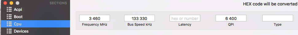

Under Cpu / QPI i entered 6.400 to get "Processor Interconnect Speed: 6.4 GT/s" showing right in SystemProfiler, just cosmetic

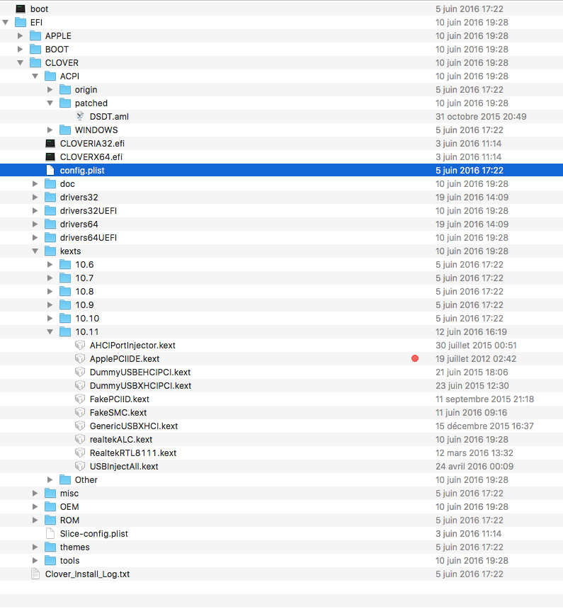

Here is my actual  EFI/CLOVER KEXTS: (OSX10.11.5 and 10.12 sierra)
Good luck

Are you using latest FakeSMC 6.20.1410 ?

Dont put , in your frequency's on CPU !  (Clover config.plist)
mine looks lke this

I have a GA-X58A-UD5 Rev 1.0 (BIOS f6) with an i7 930 and can't get it to shutdown correctly no matter what I try. I have Sierra running on it (although from boot to clover takes about 2min), would be great if the thing would shutdown normally?
I'm using the latest clover and have tried both the attached DSDT's with no luck.
Can anyone tell me where I'm going wrong?

please post your config from clover. Did you check "fix shutdown"?
Any particular reason why you are still on that old BIOS? Not sure if that has something to do with the shutdown problem - I was just noticing.
