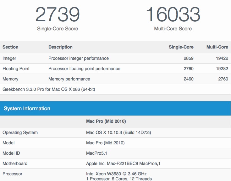

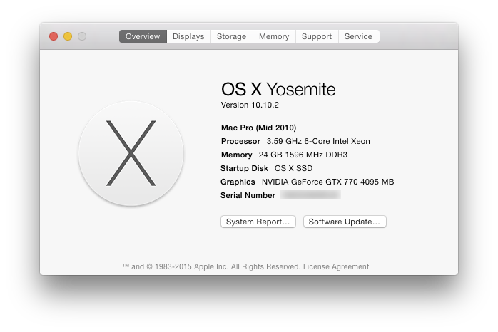

I did about the same yesterday ! (replaced i7 920 for a Xeon W3680.)
I'm using the dsdt  from dood v6. modified as of point 5. (for W3680)
With Geekbench 3.3 64bit I get a very low single core (2230) ? ( should be 2600) but a good multicore (16000)
I use Clover (r3185) for some time now but, so going to play around with Clover configurator to get it better on single core
Have a good day
