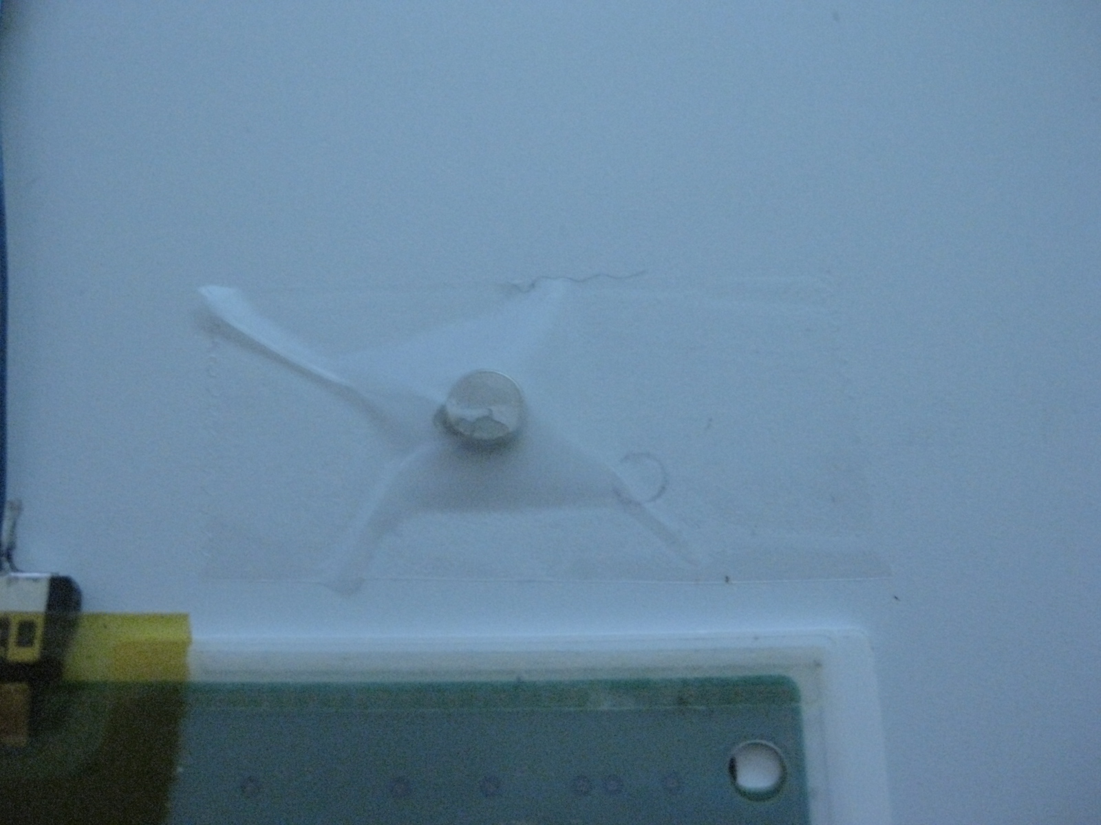

The Sleep mode in the Powerbook series is controlled by a reed switch which is actually located underneath the trackpad. In other model laptops they were located in other areas, but the 15" Powerbook has the switch underneath the trackpad. To get the sleep function working with the new top case (A1106 model required a different type of top case, as the trackpad and keyboard piggyback and work through a single small ribbon cable). The magnet taped behind the LCD needs to be moved over to the left and towards the back of the laptop just slightly, but to save you some stress, your mac has not developed a strange case of insomnia.
