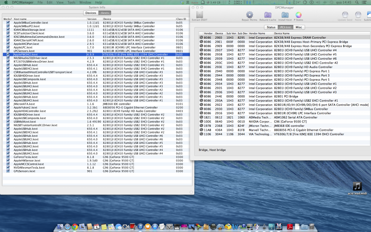

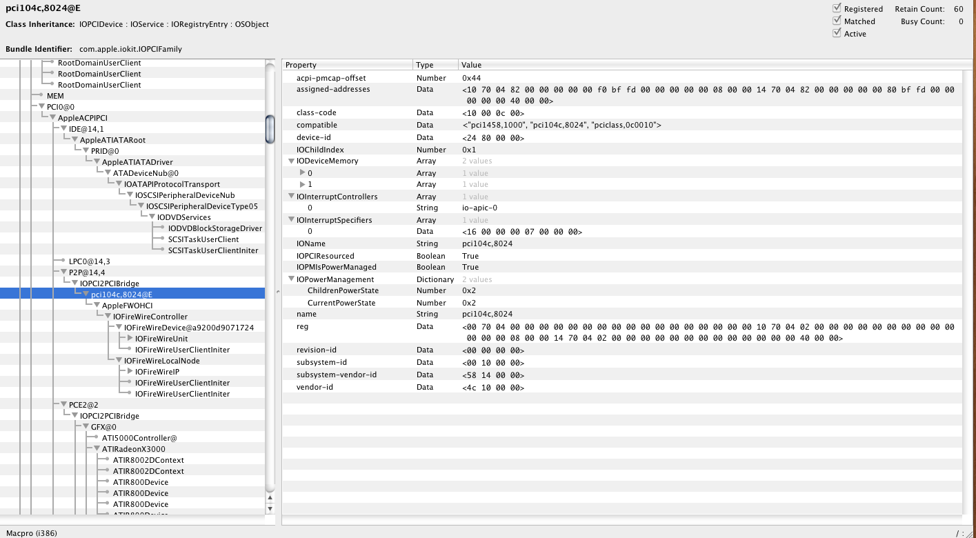

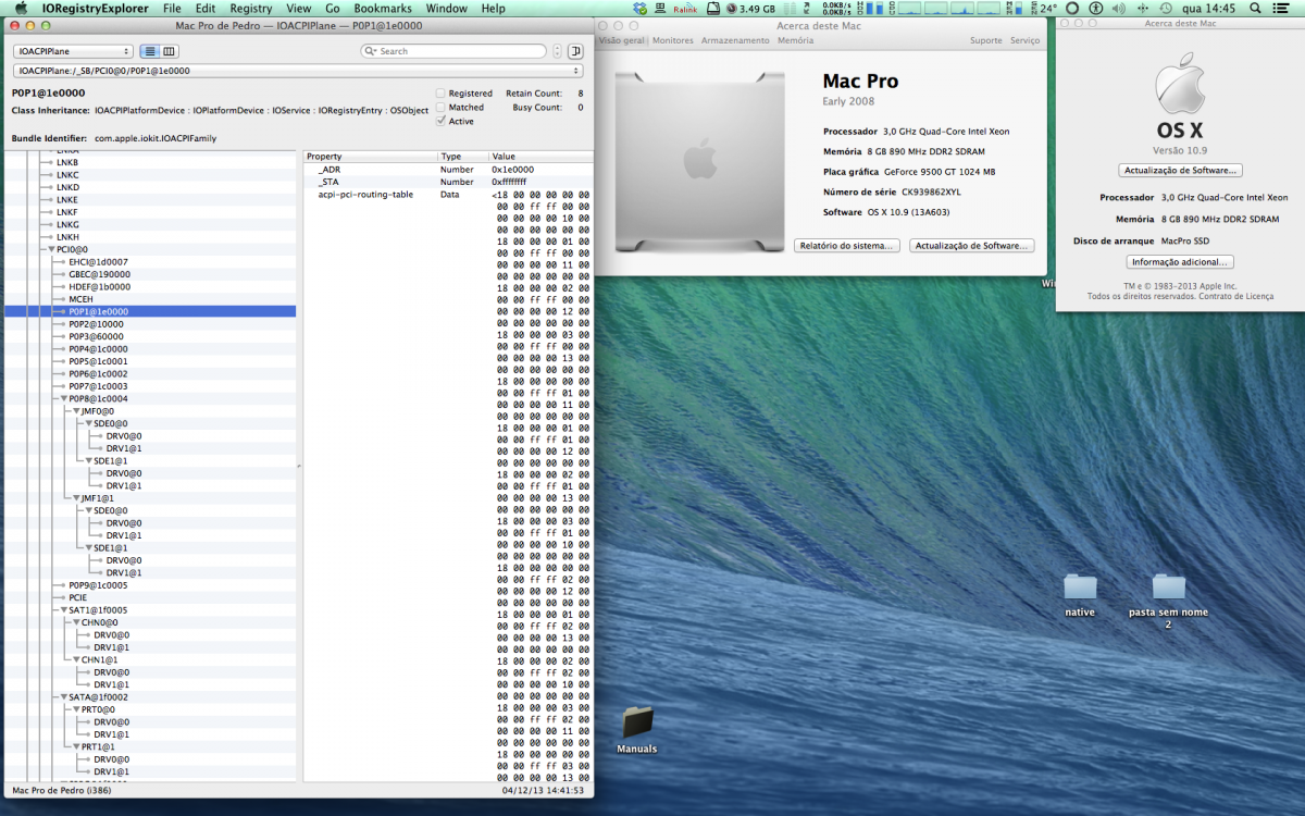

HI there people i have same problem here Firewire runtime power disable
My machine is Desktop pc _main board Asus P5E deluxe, Q660,DDR2 8 gbt (800mgz) GT9500, ASMedia AS1061, OCZ Vector 128, firewire pci card VT6306/7/8....
can anyone help me out where
Thanks
