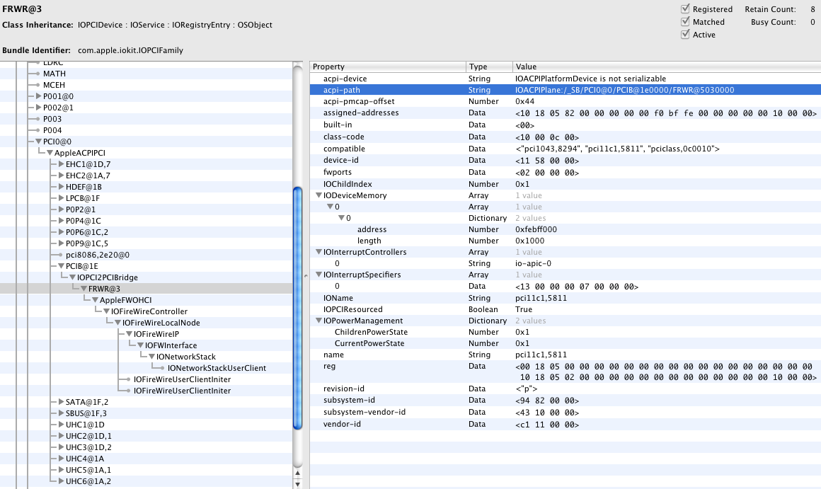

this is the config i actually can use to avoid sleep problem and firewire error at boot, if use _SUN i have this error in kernel log and a not complete stop (fan still on) but it can wake up ang it's still working:
kernel[0]: System sleep prevented by FRWR
kernel[0]: System Doze
Mate, I know for fact that adding a value to (_SUN) is to actually tell the mac/hack the PCI slot of the device... doesn't work for this firewire device, I am afraid. I only used it for the ethernet (GIGE) and graphics (GFX0) devices (PCI Slot 0x01 and 0x02, respectively). I was curious as to why you included it in the first place; glad to know you got it out! It seems you're giving your (_PRW) value in your firewire the callback to the mother device (PCIB) so I am happy this works for you!
Just to have it listed under PCI device in system profiler :D
For me now it works good only with some device like an external HD wallpowered, with camcorder or another HD 2,5" buspowered i need to make the sleep trick to use them.
I've noticed that when i have problem in mounting a device the:
Firewire Generation ID
in IOReg became -1
when all is ok it change every device connection.
Could this be related?

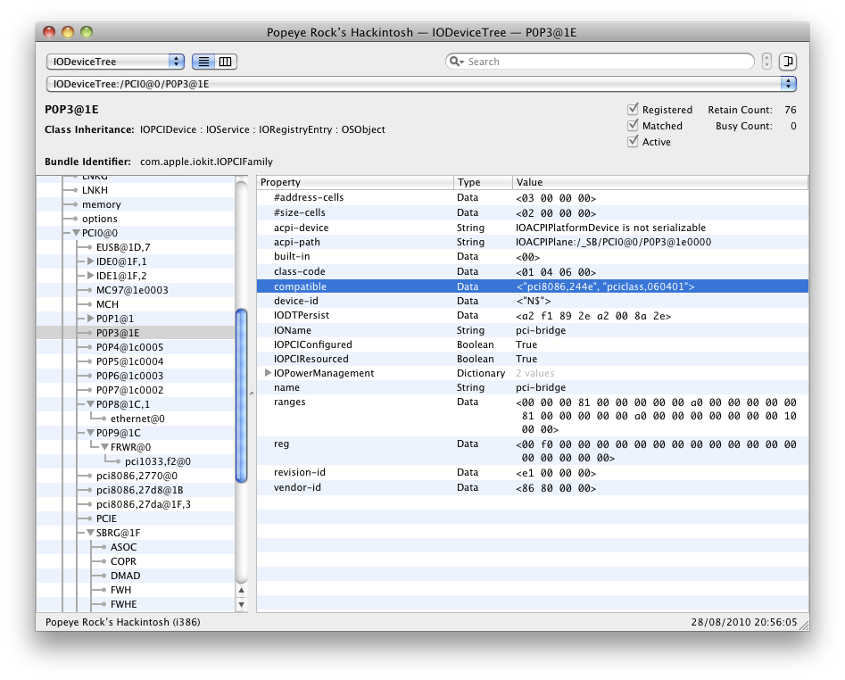

Use LSPCI to find the hardware address of the Firewire device, then locate that address in your DSDT - see post #31.
You might have to add it under the main PCI Bus device (PCIB) if there is no separate Firewire device in your DSDT already. This was also discussed earlier in the thread.

The Firewire device belongs to the PCI bridge:
00:1e.0 PCI bridge [0604]: Intel Corporation 82801 PCI Bridge [8086:244e] (rev e1)
You've placed it under P0P9 which (on your motherboard) is a PCI Express port, and you can clearly see that if you compare the address in DSDT with your LSPCI output.
DTGP is not a device, it's a "method". I don't know what it does, but it's used when adding new devices, or adding code to existing devices. It's present in DSDTs from real Macs but never on PCs. You put DTGP there yourself in the first place. If you have it in your DSDT then it needs to be there, you can't just go deleting random bits of code to get rid of error messages! If there's a problem with the code, go back to where you copied and pasted it from and recheck that it looks like it should.
Lol, nice. so I got it all wrong. My Firewire is PCI Express x1 card. That's why I put it under P0P9 device. Can you explain me why it belong to PCI Bridge? And how do I locate it in DSDT?
O and there wasn't DTGP method in my dsdt. I only paste code from 1st post and hope for magic.
Thanks anyway
You didn't say, so I assumed your Firewire controller was on-board.
This is the LSI Firewire controller on my ASUS P5Q-E board:
As you can see it's tucked in under the PCI Bridge.
An unmodified DSDT only has data for devices that are built in to the motherboard. Therefore all you will see is code for the expansion slots themselves, not for the expansion cards that are plugged into them. Make sure P0P9 is the correct slot - you can check this with ioregistryexplorer. I think there's also a switch you can use with LSPCI that makes it show the slot names but I can't remember what it is.
On my ASUS board P0P9 is home to an on-board PCI-E Marvell 88E8056 Ethernet Controller. I don't know if P0P9 is shared with a PCI-E slot though, I guess it could be.
Anyhow, if what you pasted had a DTGP caller at the end as in the examples I posted, then you must add the DTGP method to your DSDT.
There's nothing in it that you haven't seen if you have the last DSDT posted by Beerkex'd or Phoenix Wright.

                Device (FRWR)
                   Name (_ADR, 0x00030000)
                   Name (_GPE, 0x18)
                       Store (Package (0x02)
                               "fwports",
                               Buffer (0x04)
                                   0x02, 0x00, 0x00, 0x00
                           }, Local0)
                       MCDP (Arg2, RefOf (Local0))
                       Return (Local0)
It seem that you have implemented in you dsdt the good code to have firewire, my motherboard is quite the same than your for the firewire part so I only ask you if you can share this part of you dsdt.

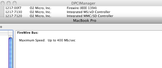

i don't care whether my firewire works, and i think eveything is ok, and i can see this message in kernel log
FireWire (OHCI) VendorID 1217 ID f7 built-in now active, GUID 00023f8cc940a9f6; max speed s400.
but the only problem is when after waking up my computer, there are too many errors in my kernel log as below.
--- last message repeated 5 times ---
