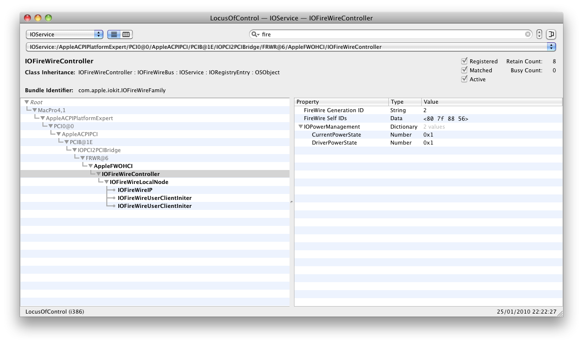

Prior to sleep this is what ioreg looks like

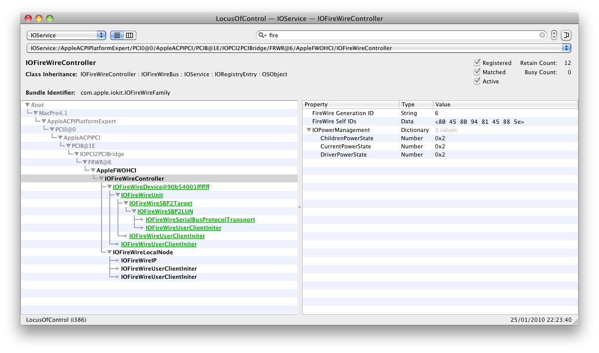

Then straight after sleep/wake turns green then black

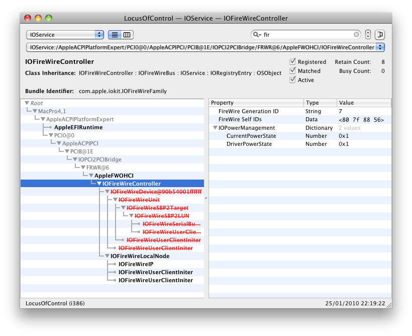

after powering scanner off then red strike through
steve

Guys I think I may have found a solution here... While studying the DSDT structure of the other devices like USB etc. I found there's an entry for (_PRW) parameter that's missing from the firewire device. Now just because it ain't there doesn't mean it's not needed. So here's my newly modified code that seems to be working, that I urge you to copy/paste/try and come back with results.
First of all, we need a new entry at the end of (_GPE) section, just for firewire (new method "_L1A"):
Method (_L1A, 0, NotSerialized)
   Notify (\_SB.PCI0.HUB0.FRWR, 0x00)
   Notify (\_SB.PWRB, 0x02)  // Added notification for power button
Just make sure your device description is correct e.g. for me the superset device owning firewire is HUB0, for you could be PCIB etc. The value is on purporse 0x00 despite for USBs being 0x02 (well, you can try and experiment and tell us your findings).
Now we need to add a new (_PRW) method in firewire device code, but be careful to keep the (_GPE) value we used before (will explain later):
      Device (FRWR)  // Added device for Texas Instruments TSB43AB22/A IEEE-1394A Controller [104c:8023]
            Name (_ADR, 0x060A0000)  // [b]My firewire address reported by 'lspci -n'[/b]
            Name (_GPE, 0x0B)        // [b]Callback to (_GPE) Method (_L0B) for device owning firewire (HUB0)[/b]
                  Store (Package (0x06)
                      "built-in",
                       Buffer (0x01)
                            Zero
                       "fwhub",
                       Buffer (0x04)
                            0x00, 0x00, 0x00, 0x00
                       "device-id",
                       Buffer (0x04)
                            0x23, 0x80, 0x00, 0x00  // [b]Board device ID is [8023] reported by 'lspci -n'[/b]
                  }, Local0)
                  Return (Local0)
[color="#0000FF"]
                   Return (Package (0x02)
                        0x1A,  // [b]Callback to new (_GPE) Method (_L1A)[/b]
                        0x05
              }[/color]
For the 'conservation' error to disappear from bootlogs, we need to make sure the Name (_GPE, 0x0B) entry points to the callback of the superset device owning firewire, not firewire itself (_L1A). In my case, for HUB0 device, the callback in my code points to _L0B, search for yours (e.g. PCIB device?) and just put/leave that value. Don't point this one to the new method _L1A.
The new (_PRW) method now should take care of any other calls for power management, just for the firewire itself, through our newly added method in (_GPE) section. Please try this, recompile your DSDT, reboot and let me/us know!
I really hope this will help. For me, I can report that when I shut down the hackintosh, the firewire drives now shut also... But if someone with better DSDT knowledge thinks this is a screw up, please post now!!! :censored2:
P.S. This code addition doesn't affect the system otherwise (e.g. speed-step etc.)
