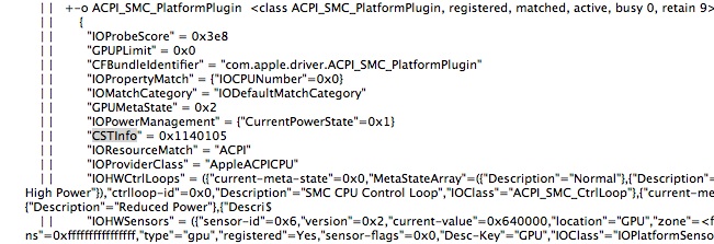

keeza Posted December 31, 2009 Share Posted December 31, 2009 Re: the cstate info can anyone verify the ioreg from a macpro3,1 - cstinfo value? I found this on the net, what is the relevance of this number I wonder... Link to comment Share on other sites More sharing options...
mm67 Posted December 31, 2009 Share Posted December 31, 2009 Re: the cstate info can anyone verify the ioreg from a macpro3,1 - cstinfo value? I found this on the net, what is the relevance of this number I wonder... That value changed with 10.6.2 kernel, at least iMac10,1 and iMac11,1 ioreg dumps have that new 0x1240105 value Link to comment Share on other sites More sharing options...
LocusOfControl Posted December 31, 2009 Share Posted December 31, 2009 I get the same 06a0. Interesting though, I tried using IO address of 416 and 0x03 0x96 0x64 and I lost CST info. What I would like to know is what does the number under cstinfo represent? Now I have 1240105 which I think most people have whereas before I had this value? EDIT: I do get cstinfo using the above values - 1240105 I have an EX58-UD5 (ICH10R) with bios f9m My idle (auto) sleep has always been regular as clockwork I get sudo setpci -s 0:1f.0 0xa0.w Password: 06e0 Currently I have ..., but I also get the same result with 0x16 , 0x3A (ICH10R) Device (LPCB) { Name (_ADR, 0x001F0000) Method (_DSM, 4, NotSerialized) { Store (Package (0x02) { "device-id", Buffer (0x04) { 0x18, 0x3A, 0x00, 0x00 } }, Local0) DTGP (Arg0, Arg1, Arg2, Arg3, RefOf (Local0)) Return (Local0) } OperationRegion (PREV, PCI_Config, 0x08, One) Scope (\) { Field (\_SB.PCI0.LPCB.PREV, ByteAcc, NoLock, Preserve) { REV0, 8 } } and AppleLPC runs on both occasions AppleLPC: Version: 1.4.9 Last Modified: 01/08/2009 06:57 Kind: Intel Architectures: i386, x86_64 64-Bit (Intel): Yes Location: /System/Library/Extensions/AppleLPC.kext Kext Version: 1.4.9 Load Address: 0xffffff7f80916000 Valid: Yes Authentic: Yes Dependencies: Satisfied Link to comment Share on other sites More sharing options...
