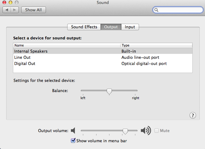

DSDT patched, AppleHDA kext replaced = Sound on speakers with Mavericks :D
Thanks guys.

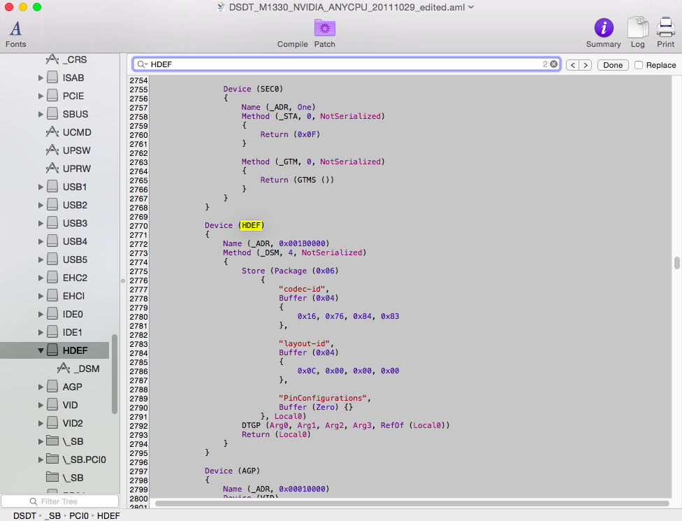

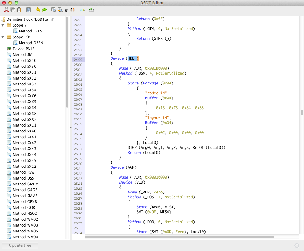

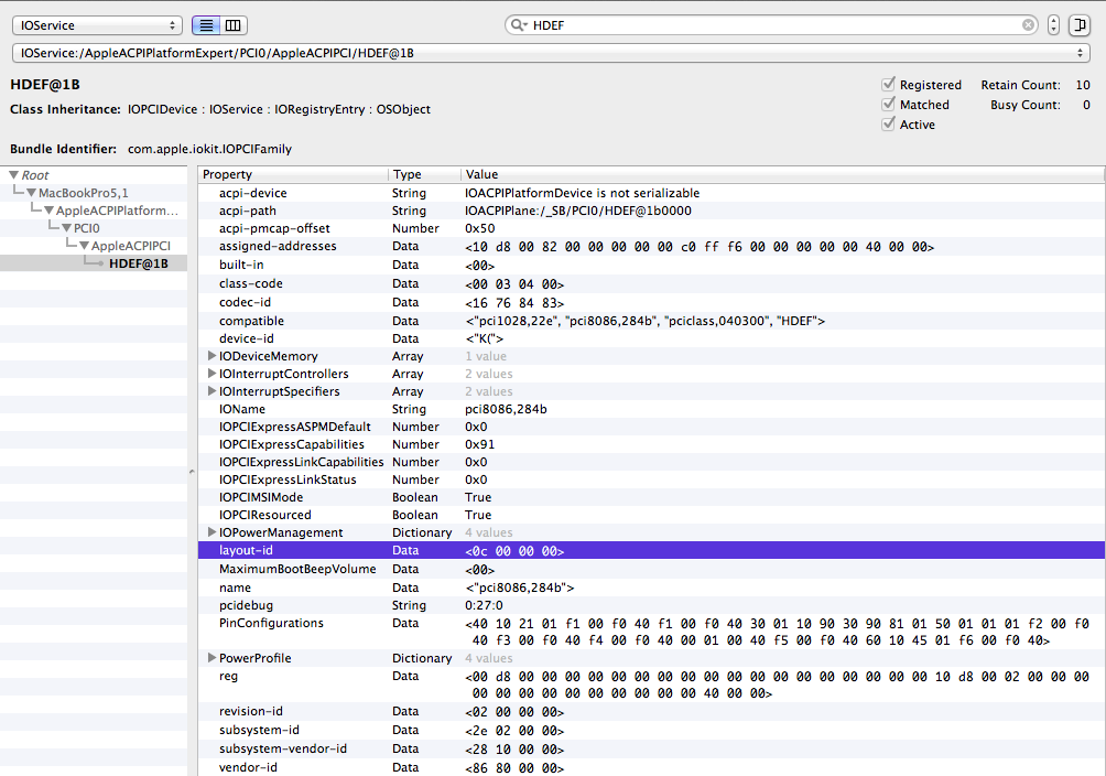

Wow! Thank you very much!
Anyway i am having troubles:
 - DSDT (10/29/2011) + AppleHDA (attached) + Removed all VoodooHDA and HDADisabler: No sounds devices detected.
Do I need to patch this DSDT(@immo's 10/29/2011)? I am trying to patch.. but i dont know how :S. I try to use chameleon wizzard
Perhaps, you would have more success with this latest iteration of the VoodooHDA.kext version 2.8.6:

There are four things that as far as I know cannot be corrected on M1330 with current knowledge:
1. Some revisions - sound from the speakers and internal mic. It happens to work on some M1330s including mine, which is why I'm pretty sure it's a hardware revision thing.
2. HDMI out - causes a crash (it used to work with much older versions of OS-X but with no sound). Reportedly it works if you connect it with an adapter to a DVI monitor, but I don't have one to test with.
3. Shutdown.
4. C-States.
Please correct me if I'm wrong!

I get G-States working with your DSDT and SMBIOS on mavericks. (NVIDIA 8400M GS). I didnt discover this, i read it from this thread for M1530 AGPM and i used it for M1330. (I dont remember the person who did it, but thx! :D ).
Here we go:
 - sudo nano /System/Library/Extensions/AppleGraphicsPowerManagement.kext/Contents/Info.plist
 - On section:
   <key>MacBookPro5,1</key>
   <dict>
   <key>IGPU</key>
   <dict>
 - Remove next line:
   <key>IGPU</key>
 - And add:
   <key>LogControl</key>
   <integer>0<integer>
   <key>Vendor10deDevice0427</key>
 - Result:
   <dict>
   <integer>0<integer>
   <dict>
 - Check what system you have, mine (smbios from immo) is MacBookPro5,1 (take care about MacBook or MacBookPro.. i get confused with this at first time)
 - If u wanna more output log for check, change 0 to 1
 - Check your Vendor 10de and Device 0427 of your GPU (this is from my M1330 Nvidia 8400M GS 128MB)
 - Save file , rebuild cache and fix permissions (every time u modify the file).
 - If all is ok you must see (with logcontrol set 0):
   sudo dmesg | grep AGPM
   [AGPM Controller] build GPUDict by Vendor10deDevice0427
If u activated 1 on LogControl, u will see more info on dmesg | grep AGPM, how the GPU change states. My frequency on my GPU are correct, only got 2 jump of Gstates (Core from 275 to 400, Memory 550 to 850).
I hope it works for u :)
Better to edit your DSDT with DSDT Editor or MacIASL than chameleon wizard.
The HDEF patch recommended by @bisk was slightly different to immo's so I have edited DSDT_M1330_NVIDIA_ANYCPU_20111029.aml and made changes to the HDEF section as shown below...

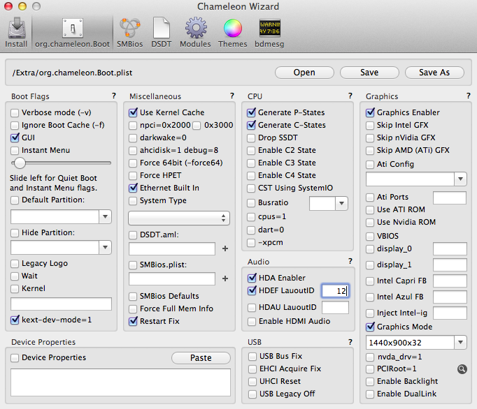

If the edited DSDT.aml (attached below) doesn't work, there are alternative methods of injecting Audio Layout ID:
  • install HDAEnabler.kext in S/L/E or
  • add bootloader injection of HDEF and layout-id 12 in your boot.plist for Chameleon/Clover
Check which kexts are loading by running the kextstat command in OSX terminal eg
kextstat | grep AppleHDA ---> see if AppleHDA.kext is loading
kextstat | grep -v com.apple ---> see which third party (non Apple) kexts are loading
Good Luck!

Some further suggestions
1.  Check your codec with "getdump" when VoodooHDA is loaded- do you get the same output as @VMonHeros & @bisk or @immo or something else altogether?  The patched AppleHDA with DSDT edit was reported as fixing sound through internal speakers on the XPSm1330 by @VMonHeros, @bisk & @macgirl.  Possibly you have a different version, in which case the provided AppleHDA.kext may not work?
2.  Check after you have installed the patched AppleHDA in S/L/E that it does infact load
3.  Make sure you use only ONE method to inject HDEF properties - EITHER DSDT or HDAEnabler or Bootloader plist.  If you use multiple methods at the same time, they may conflict.
4.  Check the HDEF section using the IORegistryExplorer.app to confirm that layout-id is set to 12 (0c in hex = 12 in decimal)
Eg
Edit 2 10/13/14
1.  getdump needs VoodooHDA loaded to dump codec data to a text file
2.  Your ioreg looks OK and your DSDT is injecting HDEF & layout-id 12 correctly - delete HDAEnabler kext from S/L/E (it is 32bit so not working in Mavericks anyway) and remove any layout-id injection from bootloader.plist
3.  Remove VoodooHDA & AppleHDADisabler from /S/L/E, then try reinstalling the patched AppleHDA.kext ver 1.7.4a1 with Kext Utility --->repair permissions, rebuild caches --->boot into Mavericks without caches (-v -f) and see if AppleHDA.kext is loaded, sound output shows in system preferences etc

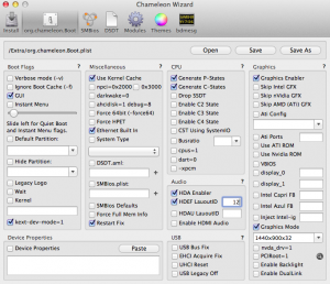

9.- Modify with Chameleon Wizzard the org.chameleon.Boot.plist, HDEF LauoutID =12
10.- Reboot
11.- No sound devide detected
Thank you anyway :)
