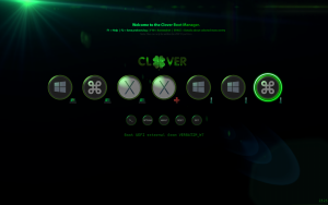

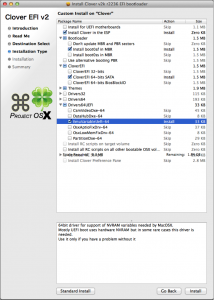

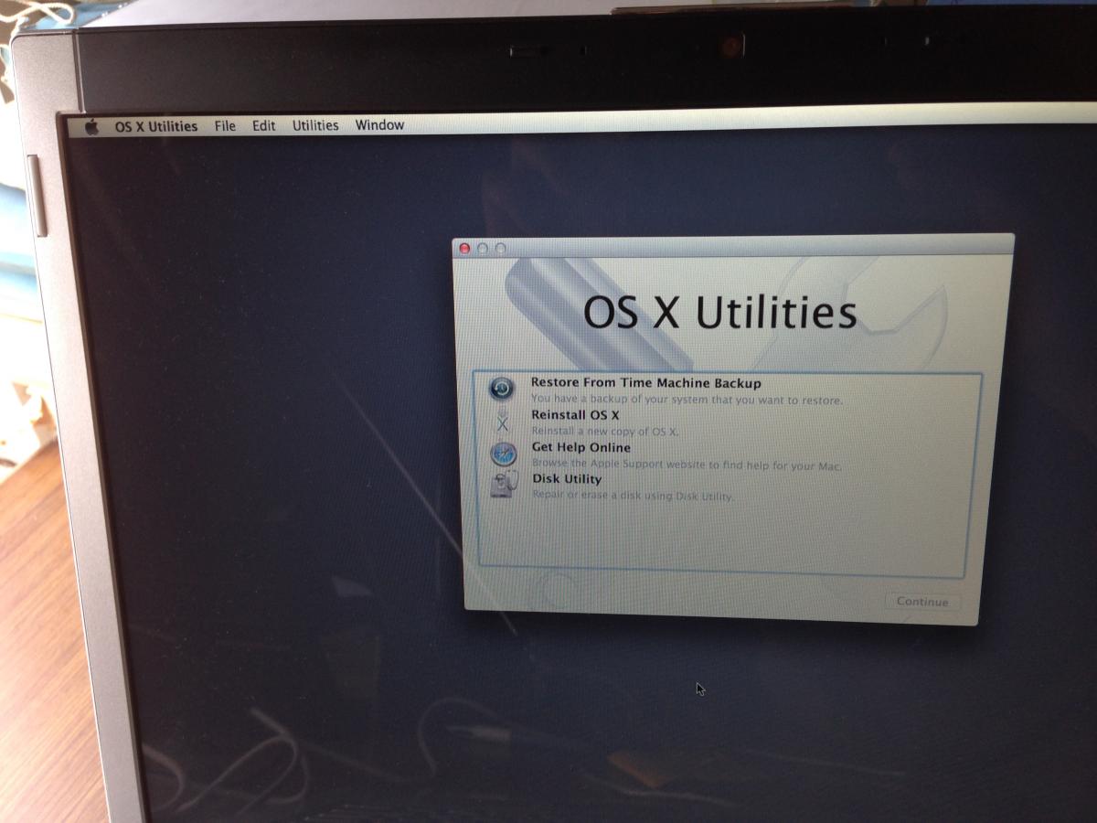

Yes, I can boot into the recovery partition of my XPSm1530 with Clover.  Download Clover here.

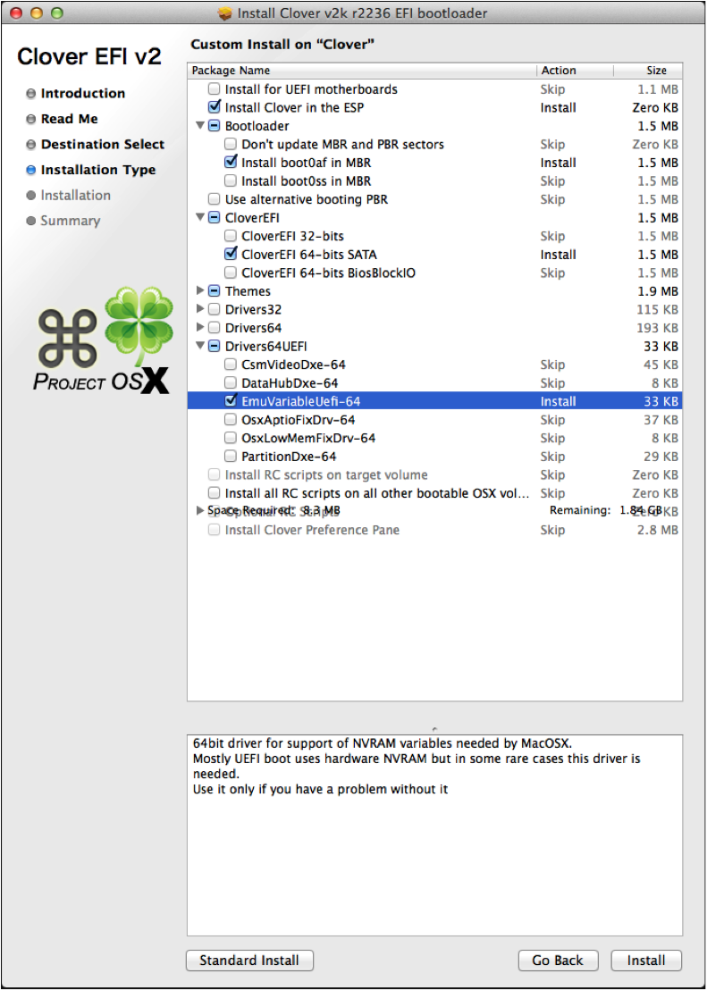

Installing Clover
I highly recommend going through batcOuntrY's guide for Clover setup on non UEFI machines.  I use the same install options as him including installing to the EFI partition.
I also recommend converting your drive to full GPT with gdisk for full functionality - Clover doesn't play well with hybrid mbr and legacy dual booting with Windows.  For those interested, attached are the files that I use to setup Clover on my XPSm1530:

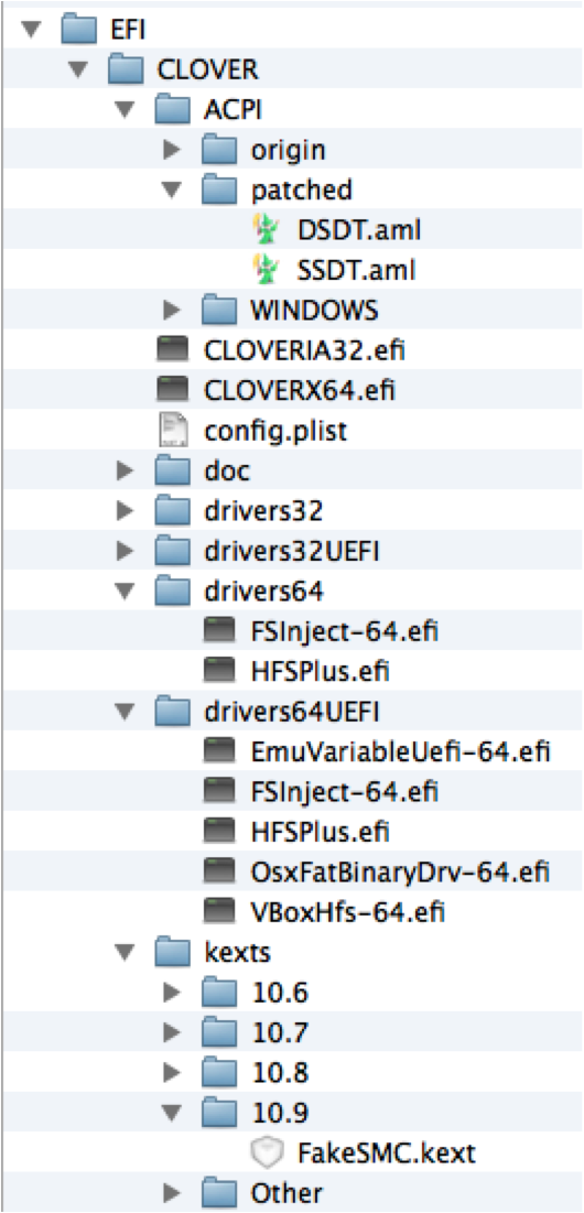

Clover files for XPSm1530.zip
config.plist--->put into EFI/CLOVER folder
DSDT.aml--->put into EFI/CLOVER/ACPI/patched
HFSPlus.efi--->put into EFI/CLOVER/drivers64 & EFI/CLOVER/drivers64UEFI
FakeSMC.kext--->put into EFI/CLOVER/kexts/Other with VoodooPS2Controller.kext & delete 10.6-10.9 folders*
* removing /EFI/kexts/<version> subfolders will result in injecting FakeSMC.kext from /EFI/kexts/Other for all OSX versions.
You can use Clover Configurator.app to configure your Clover config.plist. Please generate your own serial & MLB number with the app (click the magician's wand in the SMBIOS section, and append 6 digits to the serial to get the MLB number in Rt Variables tab).

Booting the recovery partition
Since it lacks a S/L/E folder, booting must use kernelcache and both BaseSystem.dmg and kernelcache in the RP have to be patched to include FakeSMC.kext (and VoodooPS2Controller.kext) -refer to posts by BlackOSX and Las_vegas.  Clover can do the patching automatically by injecting kexts from its kexts folder but the default behaviour of clover is to use kernelcache without injecting extra kexts so .....
For the recovery partition - set clover boot option WithKexts (kernelcache used and kexts injected into it)
For normal OSX partition with FakeSMC etc already in S/L/E try with
                                                                              - Default boot option (kc used, no extra kexts injected)
                                                                              - NoCaches and WithKexts (no kc, kexts injected - like chameleon -f, v)

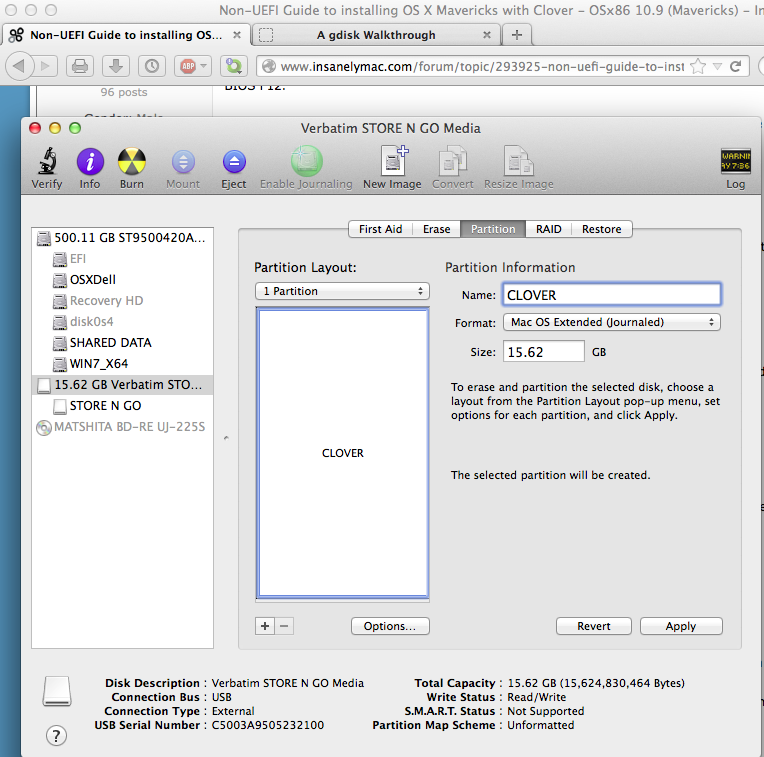

Hi DarwinX,
Thanks for the kind words but I definitely wouldn't rate myself as a Clover "expert", just a beginner learning the ropes :) .
I think the best approach initially would be to install Clover first on a fat32 USB and play around with it.  The number of options that Clover provides can be quite overwhelming, even for experienced hackintoshers (let alone for noobs) and it is probably wise to leave most settings on default if you don't fully understand what they do.  Thankfully, a lot of the options are the same or similar in Chameleon so you can safely set these eg Graphics Enabler/Graphics Injection=Yes, Set P & C states etc.
Once you are happy with the setup, it is then a simple matter to transfer your settings to the hard drive.  In your case, with multiple OSX installations, I would probably install to the EFI partition for convenience.
Good Luck!

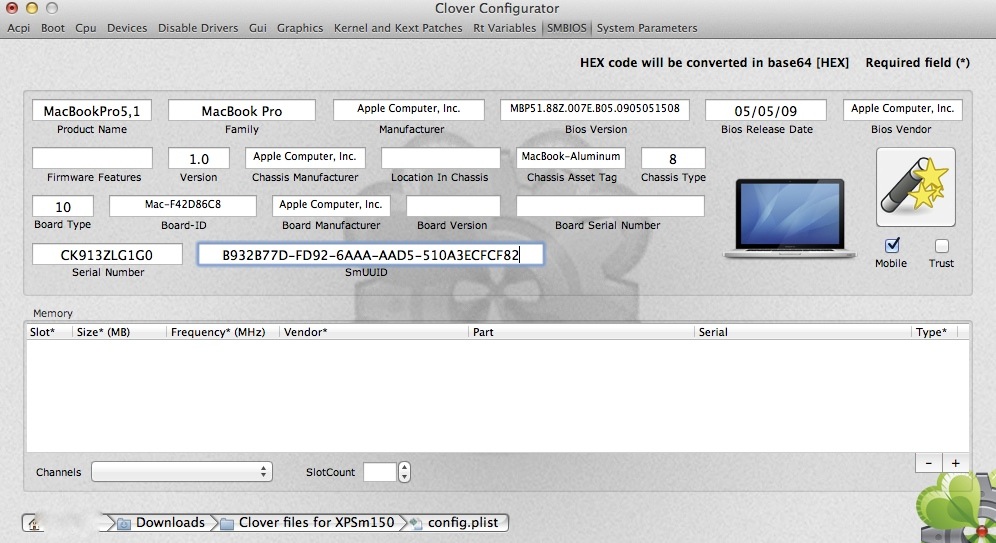

In summary,
1) Boot your OSX partition with Chameleon and use Clover Configurator to open Clover config.plist
2) Under the SMBIOS tab,
  • make sure that Serial Number and SmUUID fields are filled with the Serial Number (system) and Hardware UUID obtained when viewing "Hardware Overview".
  • Fill the field "Board Serial Number" with the same system serial number but append 6 extra digits (so have 17 characters in total).
3) Under the Rt Variables tab, fill the field "MLB" with the same number as the "Board Serial Number" (so have 17 characters in total).
4) Under System Parameters tab, tick "Inject System ID" and fill the Custom UUID field with Chameleon's system-id.  This is the same name given to the NVRAM file in /Extra ie nvram.xxxxxxxx-xxxx-xxxx-xxxx-xxxxxxxxxxxx.plist or as Dmazar said, type in terminal
ioreg -l -p IODeviceTree | grep \"system-id
5) Save Clover config.plist in EFI/CLOVER

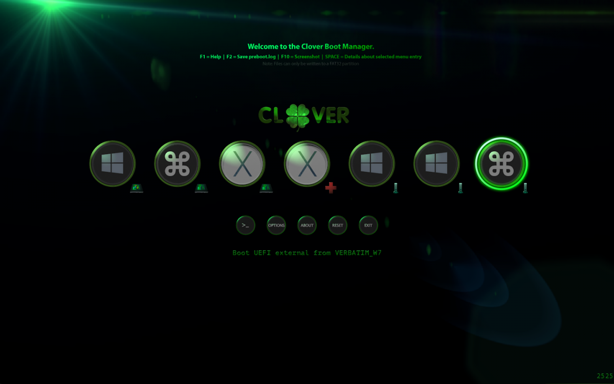

I can confirm that it is possible to install & boot UEFI Windows on our old BIOS based machines with Clover

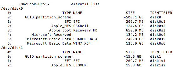

On a GUID partitioned external USB hard drive, I installed OSX first, then Windows Server 2012 (in "to go mode" following directions from this blog post), then the Clover bootloader into the EFI partition.  I can now dual boot OSX/Windows on the XPSm1530 through Clover (choose Microsoft boot menu and boot through bootmgrfw.efi).
Why boot this way?
Advantages: GPT/UEFI is the way of the future and you avoid the 4 partition/2TB limit of mbr/hybrid mbr - you can have multiple recovery partitions, OSX, Linux and Windows installations in a multiboot arrangement on the same drive.
Disadvantages: Some older disk partitioning/backup programs may only work with mbr.
Edit:  I finally took the plunge and converted the hybrid mbr on my main drive to full GPT and clean installed UEFI Windows 7_X64.
Summary of Steps Installing UEFI Windows 7 X64 on internal GPT HD
  1. Booted into OSX partition and used GDisk to delete the old Windows partition and convert the disk to pure GPT (by writing a protective mbr over the hybrid mbr).   Overview of GPT and man page of Gdisk.

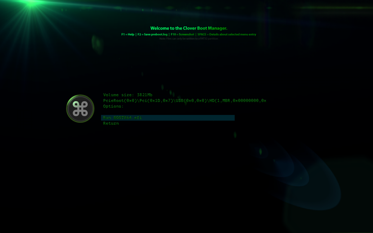

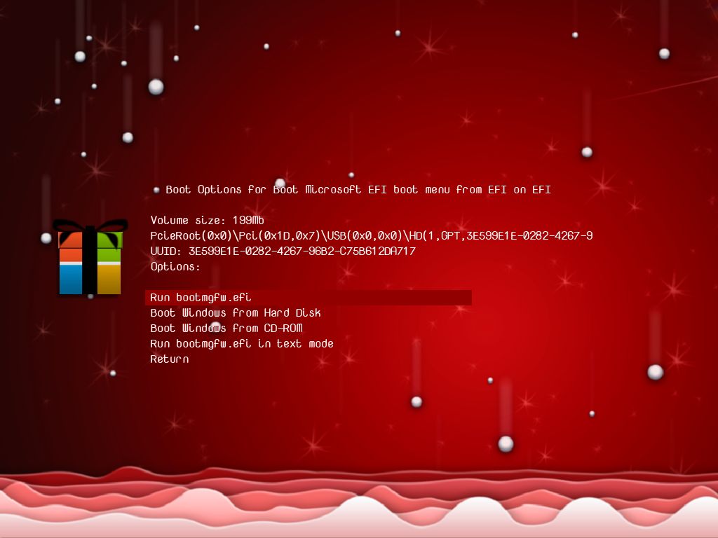

  2. Installed Clover into the EFI partition of the HD
  3. Booted the computer with Clover from the HD, then inserted Windows 7_X64 UEFI install USB
     4. Choose bootx64.efi from EFI boot menu of the install USB.  Follow the prompts to install UEFI Windows into the free
         space created by step 1
     5. After the installer has finished writing files to disk, it will automatically reboot--->remove install USB now
     6. Computer will boot into the Clover screen and there will now be an internal EFI menu to choose--->select to boot
         bootx64.efi.  Windows will now finalize settings and complete the install!

Now that I have clean installed Windows again, I thought I might take the opportunity to share some useful information and tips I've found for dual booting Windows and OSX.
I keep a fat32 "Shared Data" partition that contains my documents, pictures, music etc that can be accessed by both OSX and Windows.
You can install Apple's bootcamp HFS drivers in Windows by following the instructions in this guide.  They enable you to access your OSX partition in read only mode (so you can copy over important files to the Windows partition as backup for example).

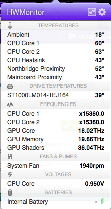

You are using the wrong FakeSMC hardware sensor branch. Delete your existing FakeSMC.kext by Kozlek as its hardware monitoring sensor plugins are not fully compatible with our hardware.
Use the following latest available FakeSMC.kext from Slice's branch along with the appropriate HWMonitor.app also by Slice which differs from Kozlek's HWMonitor.app.
DO NOT mix the kexts from those two independent branches and please DO NOT use Kozlek's branch at all.
Ok, so that was exactly the same sensor branch as I was using, but apparently I was using the wrong HWMonitor.app, so things weren't displaying correctly.  That's one problem fixed.  Thank you very much.
Now, for the second problem, which is that the temperatures are still too high.  Right now I'm sitting at 66C, and I'm hardly doing anything.

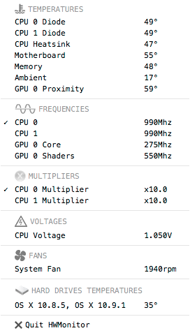

No problem. Your temperatures appear to be in the acceptable range. Look at mine:

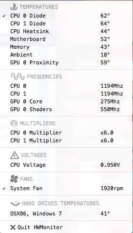

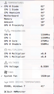

Hmmm,
I'm running the latest FakeSMC+HWMonitor 6.0.1057 on my XPS m1330 NVidia 8400M GS/128, m1330 X3100, and m1530 NVidia 8600M GT/256 and all seem to be showing reasonable HW readings.
My m1330 8400M GS does run too hot, 68-75, averaging 70ish but these XPS m1x30 notebooks are known for defective NVidia GPUs w/bad thermal cycling, massive recall and all that.
Is this not OK ?

Hmmm,
Is this not OK ?
attachicon.gifHWMonitor.tiff
Kozlek's branch lacks support for our LPC Super I/O chip (PC8739x), hence the missing temperature read outs with the Kozlek's version that you are currently using. The difference between branches is quite obvious as evidenced by the differing screen shots. You really don't need to reinvent anything here as everything has already been provided for your convenience.
You must simply utilize it.
Agreed, more readings is always better ;)  Certainly not inventing anything here ... just implementing the hard work of others in either case.  I was mainly just wanting to relay my experience that the newer FakeSMC/HWMonitor branch was NOT the cause of bad sensor readings for the OP.
Misinformation is always worse than no information, yeah ?
Our rigs do indeed run hot due to the defective (retarded?) video card cooling system design which is clearly unrelated to FakeSMC.
I was merely pointing out that it is illogical to utilize Kozlek's branch of FakeSMC on our systems as it lacks essential hardware support which translates to diminished sensor output.
Kozlek's active development, while laudable, is also largely irrelevant to our outdated hardware.
umm, yours are at least 12 degrees lower than mine.  Last time I showed you those, you said they were super hot.  Anyhow, mine doesn't seem to run so hot in Windows.  I also noticed that your frequency during what i assume is idle is a good bit lower than mine.  My frequency never drops below 1194 MHz (the x6.0 Multiplier); in fact it seems to always waffle between x6.0 and x9.0 or x10.0.  I thought there would be several different steps in between, and I would expect it to drop lower than x6.0 at some point.  Maybe my grasp of the concept is way off, but still, average temperatures of 64C seems kinda high, and it takes nothing for that temperature to soar up to 75-81C, just a game or anything involving video.  It just concerns me.  I thought that cleaning and reapplying thermal compound to the cooling system would make a difference, but it made very little difference.
