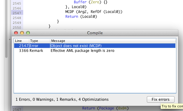

Something is missing in your patch because I got an error when compile my DSDT:
Because he use a MCDP method by masterchief, you probably use DTGP method, more common, simply rework that patch with DTGP method or add this at your dsdt near DTGP method
Method (MCDP, 2, NotSerialized)
If (LEqual (Arg0, Zero))
Store (Buffer (One)
0x03
}, Arg1)
But i don't see the need to use 2 similar method, btw they together will not cause any problem ;)
Because he use a MCDP method by masterchief, you probably use DTGP method, more common, simple, rework that patch with DTGP method or simply add this at your dsdt near DTGP method
Thanks :)
