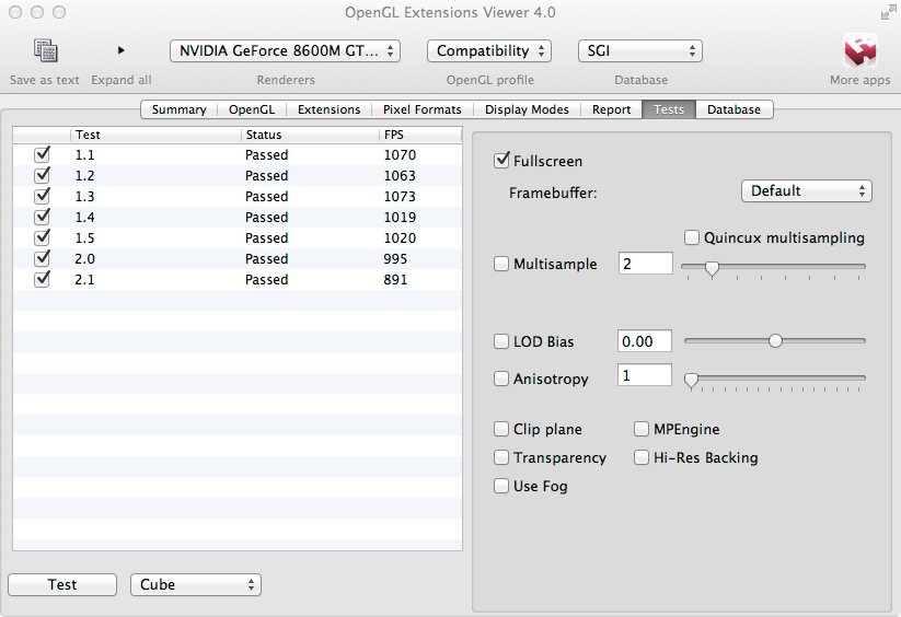

Maximus1, Lulighttec, try removing NVClockX. I suspect it's overclocking our GPUs and it's generating too much heat! I've done it on mine and my computer seems to be running much cooler. I can't tell you what the GPU temperature is because you lose GPU temperature monitoring without it, but just by touching it, it seems much cooler. Also, I could not play HD video on YouTube before without it getting super hot then shortly after super slow. It seems to be working fine now! I've also been playing a little Portal 2 and again just fine. It's worth a try.
Update:
After stressing it with Portal 2 for a while longer it has overheated and become slow again. Portal 2 becomes unplayable and no more HD or full screen YouTube videos. After letting it set for about 10-15 minutes I can do the YouTube videos again. I do suspect that it takes longer to overheat and cool down afterwards, so I still think it's worth a try. Like I said before, I couldn't watch HD YouTube videos full screen at all before.
Update:
