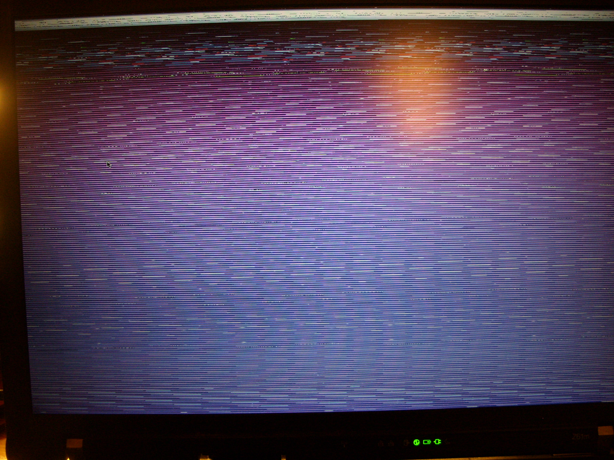

i reinstalled everything and customised info.plist using an edid i got from linux read-edid
i installed radeonhd.kext using kext helper
but it still doesnt work : i get random glitches and bugs on boot when display loads
Can you test this? Type below in a terminal window and check what happens:
sudo kextload /System/Library/Extensions/RadeonHD.kext
Since you already removed ATI*.kext, I just want to make sure what prevented RadeonHD from loading.
If that cmd loads RadeonHD.kext without problem, please paste your IOReg output in attachment or codebox.
i get this :
10RadeonDump is not compatible with its superclass, 9IOService superclass changed?
kextload: a link/load error occured for kernel extension /System/Library/Extensions/RadeonHD.kext
link/load failed for extension /System/Library/Extensions/RadeonHD.kext
(run kextload with -t for diagnostic output)
i boot in safe mode
thanks for your attention !

i get this :
i boot in safe mode
Obviously you installed a wrong version (10.6). Based on your previous post, you are using 10.5.8, you should install RadeonHD.kext for 10.5.

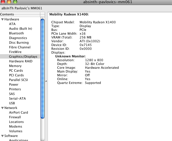

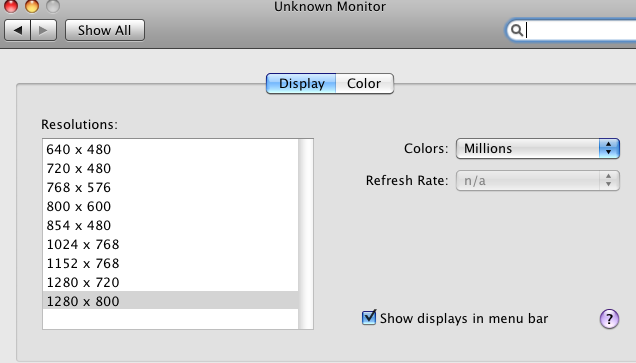

Hello dong, thanks a lot for this great kext. I really appreciate your work.
i have a slight problem...
I have a ATI Mobility Radeon x1400. I have QE/CI enabled with full 1280x800 resolution. I'm using your kext which is working fabulously except for one very annoying issue. When i go to hover over a text box where you enter text the cursor will disappear. This happens in dreamweaver which makes it extremely annoying when making websites... as i cant see the cursor to click. I have to guess where it is. It displays the cursor fine in text boxes in safari and textedit but the same thing happens in the search box in iTunes. I've noticed that if i disable hardware cursor then the issue is temporary fixed but it makes the mouse blink and sometimes disappear or leave tearing on the screen.
Just wondered if you know whats happening?

Guys I have a problem, all I did well but I have refresh rate! Do not know what the problem is, if anyone had a problem similar to! Thanks in advance!
P.S job well done thanks for the drivers!
dell inspiron 6400
From my understanding of the linux code, it says all LCD defaults to 60Hz and other refresh rate has no practical meaning. Thus I only added 60Hz resolutions.
Thanks dong but as soon as I add 60Hz to com.apple.Boot.plist will not boot Mac OS :-( Once again thank you
