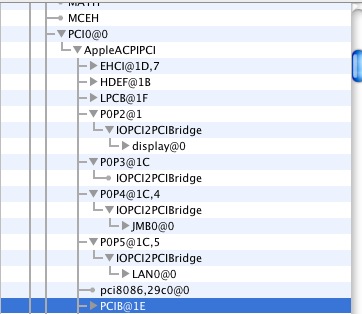

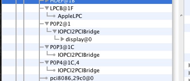

Is not exactly the case for me:
See P0P3; nothing is hooked there but still shows in the RegExplorer
and
P0P4 still there after disabling Jmicron controller, but P0P5 is gone (ethernet disabed)

Is not exactly the case for me: See P0P3; nothing is hooked there but still shows in the RegExplorer
That's the "PCI Express Port 1" which is a root domain controller. Look for PCITOPLevel in ioreg -l output. There's your answer (the other ports are linked to it).
and ... P0P4 still there after disabling Jmicron controller, but P0P5 is gone (ethernet disabed)

And P0P4 should not be visible when the Jmicron controller is disabled in the BIOS. However, you may have forced a connection from your DSDT. And you could check this by looking at the ioreg output, because it should not be there without anything connected to it. Or there's something else active. Just to give you some ideas.

Here we go, Gigabyte's DSDT based on your (Master Chief) DSDT research.
My board is EP45-UD3LR (ICH10R).
Should be useful for all Gigabyte boards, IMO.
Good work stickpin. Your mobo and mine (GA-EP45-DS3L) are almost identical and your DSDT converted from Masterchief's is further advanced than my own. I will have a look through it, thanks. When I report back, I will do so in the Gigabyte DSDT fix thread. Regards :(
