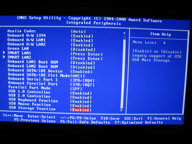

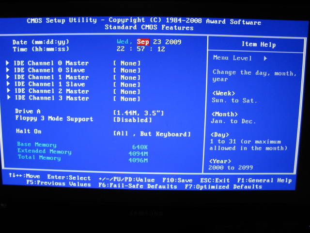

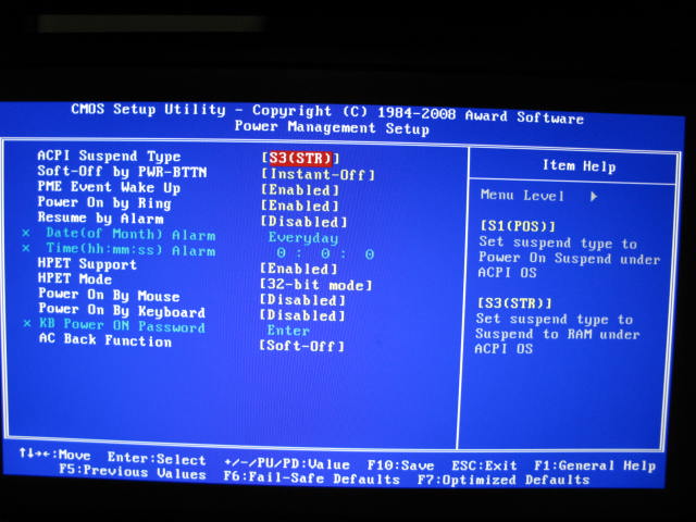

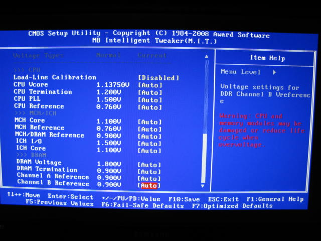

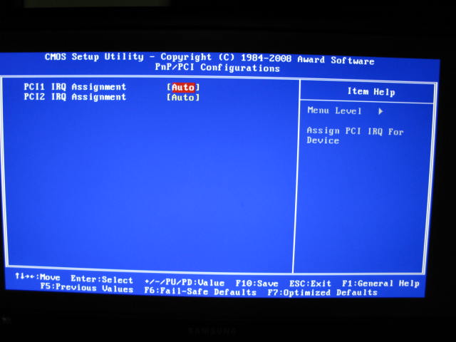

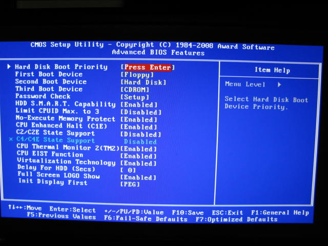

Hi all,
I desperately need some help and would some kind expert/soul/person please help me!!!!! Or can anyone direct me to any email or forum or anywhere to ask for help?
Ok here's my stats first.
intel core 2 quad 2.83 ghz 9550
Gigabyte EP45-UD3P Mainboard
XTREEM Dark DDR1066 (2X2GB) DDR2
Western digital 1TB Green SATA2 HDD
EVGA 896 MB GTX 260 SC PCI-E
+ some Extra LAN Card
I have been religiously trying to build a hackintosh with snow leopard from the lifehacker guide. See http://lifehacker.co...acking-required

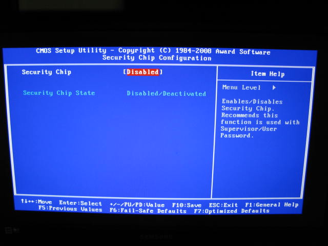

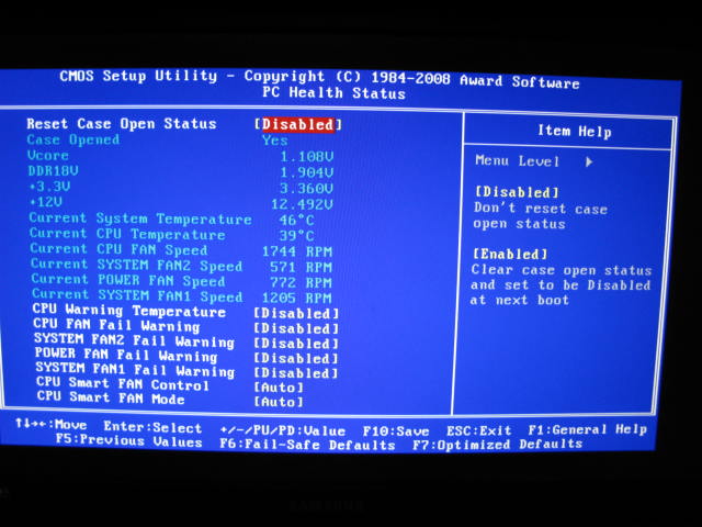

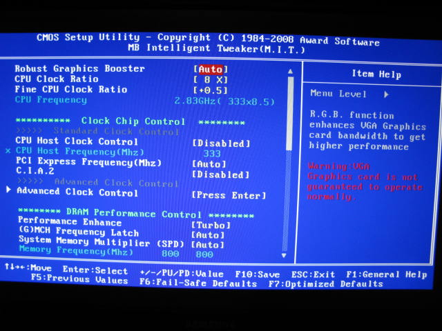

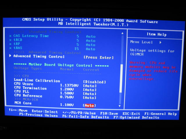

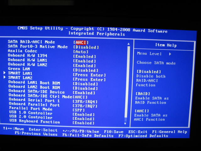

Anyway, I have come to the point where I have gotten to the installation screen, partitioned the hard drive, installed snow leopard and then restarted the whole system. That's where the problem came in. It is now stuck at verifying DMI pool data. Some kind soul told me that it is a bios problem and I have attached screenshots of my bios for verification. (all very small file size) Can someone please tell me what I have done wrong. It seemed like I almost finished and just a hurdle to overcome. I have never done this before and will be willing to read any step by step guide. Please direct me to more places where i can get help if u know any.
A million thank yous to any who can help me solve this. Thanks

You tried disabling the floppy drive? I also don't have the serial or parallel ports enabled. The LH method should work for you. What brand USB flash drive do you have?
Also, the onboard lan with the UD3P using the LH method worked fine for me, try removing your lan card.
cheers

I'd rather you post this inside my thread than PM me (so others can find it easier), but I had this problem ages ago with Leopard.  All I had to do was make sure that IDE was set to AHCI, and the JMicron IDE Controller was set to AHCI Mode.

IDE you mean, onbard sata/ide ctrl mode, if that is the case then i have changed it to AHCI. I can't find out where the Jmicron IDE controller is at under my bios. Sorry a newbie, so i haven't changed that. I restarted it and it still doesn't read from my hard drive when selected as to boot from there.
ok here's the thing. I've tried installing the snow leopard and when it asks me to restart I actually come back to the actual installation screen again, according to lifehacker that shouldn't happen. So I tweaked my bios to boot from my hard drive and now encountering the verifying DMI pool data error. Can anyone please help me solve it, which part of my bios am i doing wrong?

Hi Builder. Hope this should solve the problem.
1] Try setting your CPU Clock Ratio to Auto or to the Maximum of it's value so that it matches the Default Clock Speed.
Meaning if it is C2D 2.93 GHz, making it 11 x 266MHz FSB. Hence, then Keep the Ratio Multiplier @ 11.
2] Try keeping all Voltages settings to manual. BY referring the CPU box.
3] If you are not using floppy drives or other redundant older devices like Serial and Parallel port, please Disable them in the BIOS, immediately.
4] Disable Virtualization Technology! Immediately!
5] If you have HPET Mode = 64 bit, then set it to 64 Bit.
6] Disable CPU Smart FAN Control, and CPU Smart FAN Mode, First!
