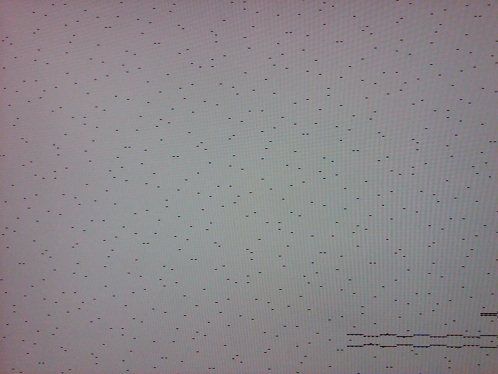

dshade69 Posted September 13, 2009 Share Posted September 13, 2009 I have managed to get SL installed on my system installing it from 10.5.8 onto a new drive. Though I did everything correctly as far as I know it hasn't been the model of stability. I am still working on building a USB installer, but no matter what I do and no matter whose instructions I follow I run into the same thing. I get as far as the apple screen and then the screen fills up with grey & black lines and I have to reboot. So far I have tried lifehacker's walkthrough, snow's, and the bit at the end of d00m42's. My hardware: Intel Core2 Q9400 Gigabyte GA-EP45-UD3R 4xOCZ Platinum DDR2 1066 2GB Radeon 4850 Edit: I've attached a screenshot of the screen that I get, sorry for the poor quality but its a phone camera. Link to comment Share on other sites More sharing options...

dshade69 Posted September 14, 2009 Author Share Posted September 14, 2009 No luck, no matter how I slice it, I end up with the same screen in the end. I did notice that I wasn't getting 32bit mode so I tried arch=i386 -legacy and that gave me 32bit but still had the same issues. Unfortunately even in verbose mode I can't see what is causing the issue...everything looks fine then the screen goes corrupt. Link to comment Share on other sites More sharing options...

dshade69 Posted September 16, 2009 Author Share Posted September 16, 2009 Well I may have found my problem. I recently removed 2 sticks of OCZ memory and sent them back RMA because they were going bad. At the time I tested all my memory and the other 2 sticks were fine. I have been noticing a bit of instability in 10.5.8 so checked it again and I have another stick going bad. I imagine that is what is causing my SL USB install issues...probably because of the RAM drives it sets up during the install. I am removing that stick and rebuilding my installer and will try again. Link to comment Share on other sites More sharing options...
