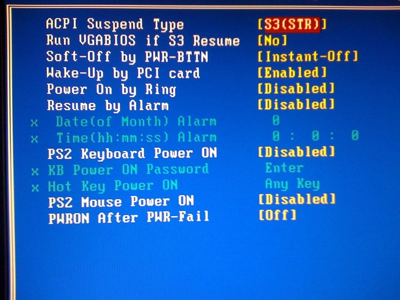

- boot and press the [DELETE] key on boot to get to your BIOS, goto power management and set "Run VGABIOS if S3 Resume" to "NO", f10 save, system wil reboot
- press [ESC] to get the boot menu, and boot onto your USB drive

what did you do to get sleep even if it not perfect yet ... bios, dsdt ?
mine will just seem to shut down (MB lights are on, but fan, hd and power light are off) and "never" wake up (I just hold the power button for 10 sec, release and press it again and it will boot)
I don't have much time now (homework), I'll try later
but maybe you can try :
Attached File  SleepEnabler.kext.zip   24.05KB   33 downloads
and bios sttings right below the S3 option...
#20
