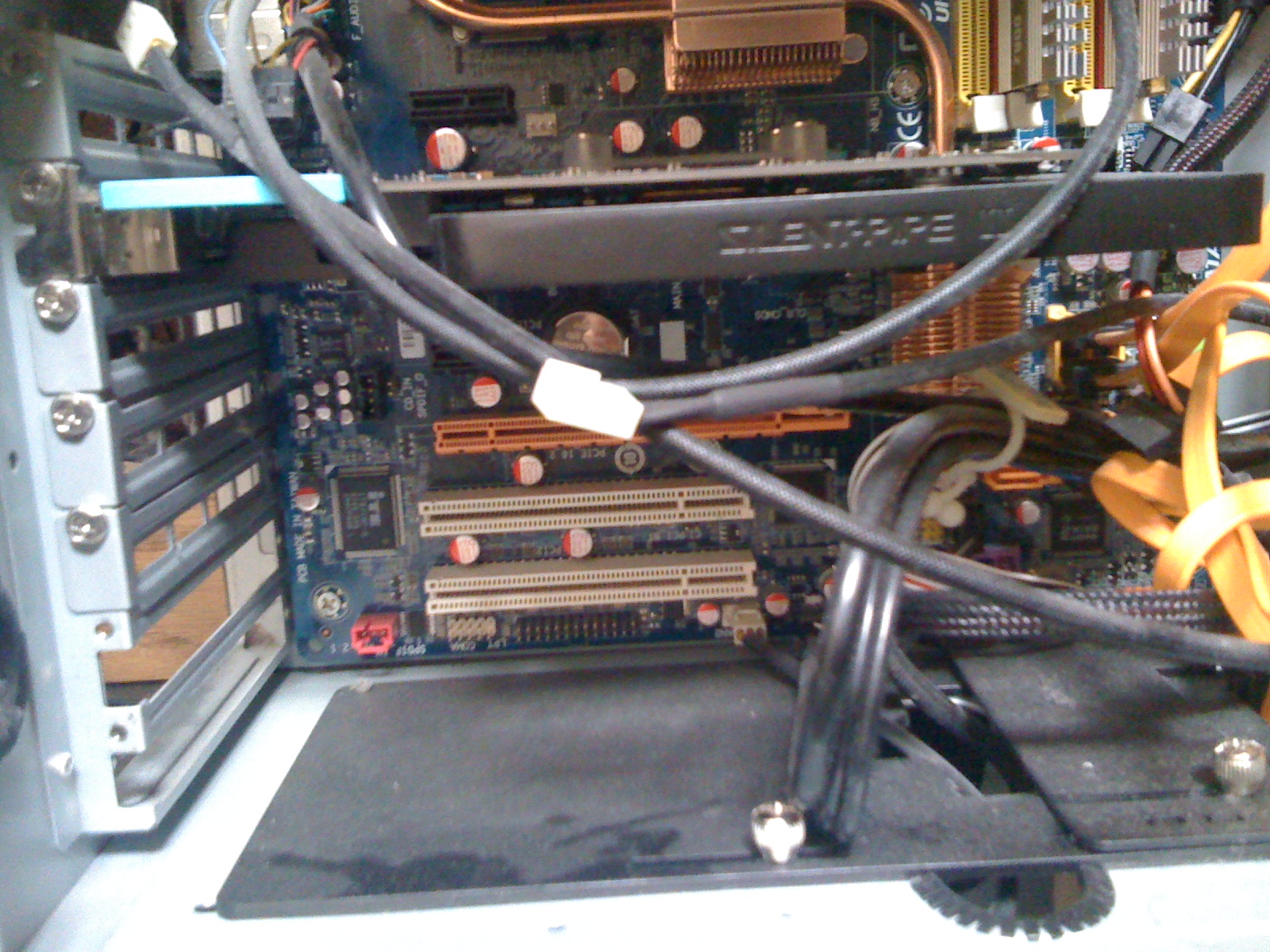

Then unless the PCIe graphic card, there's absolutely nothing on PCI ports :

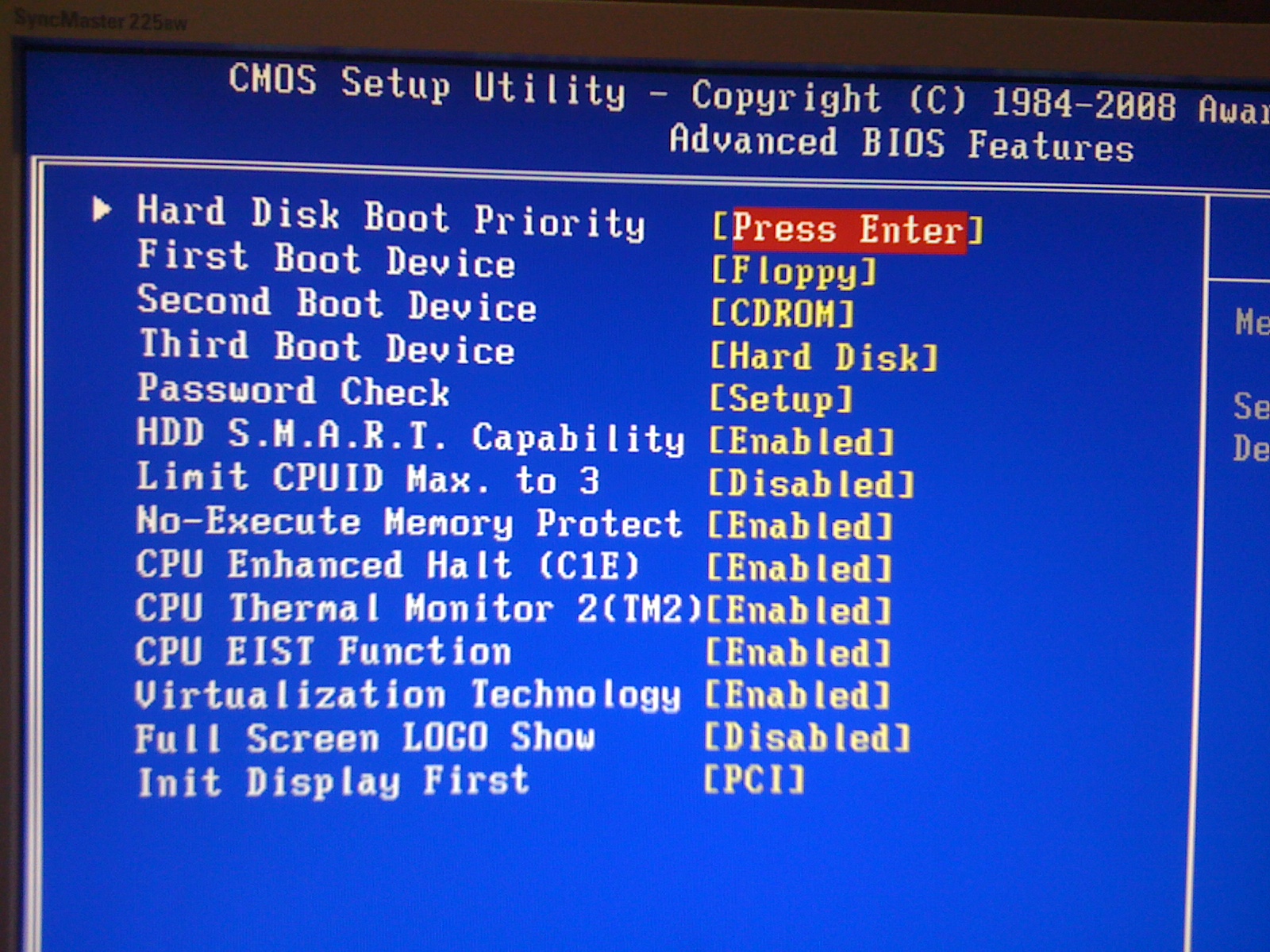

here are my BIOS settings which are stricktly the same as on the link from your guide :

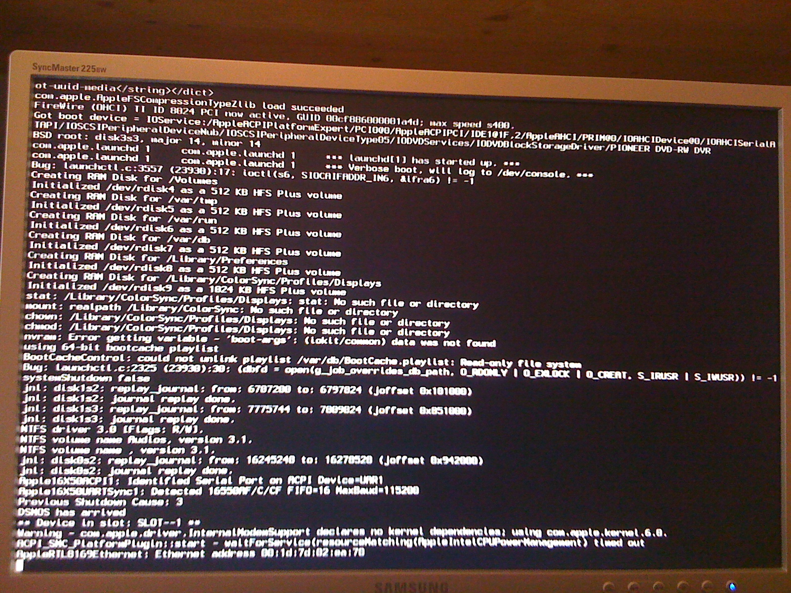

and voilà where I stop :
I really don't get what my problem is since all you guys seems succesfull :(

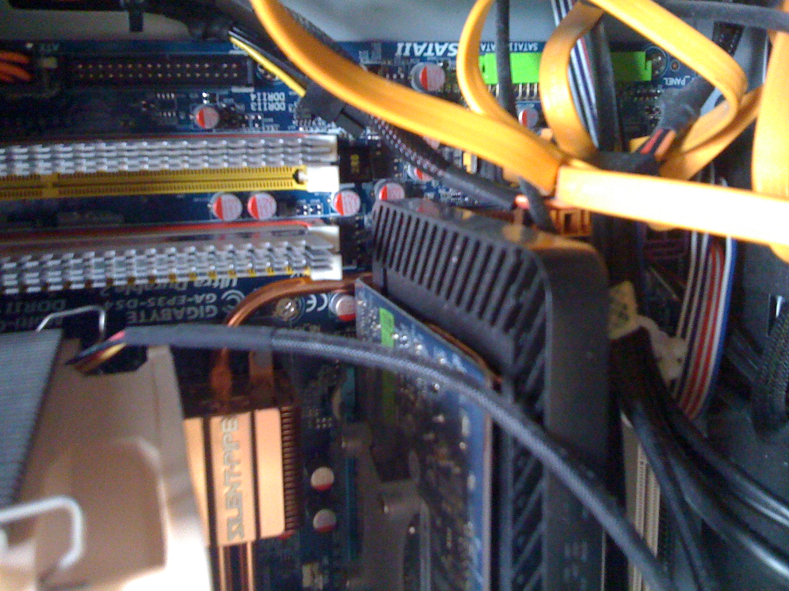

First it is a EP-35-DS4 :

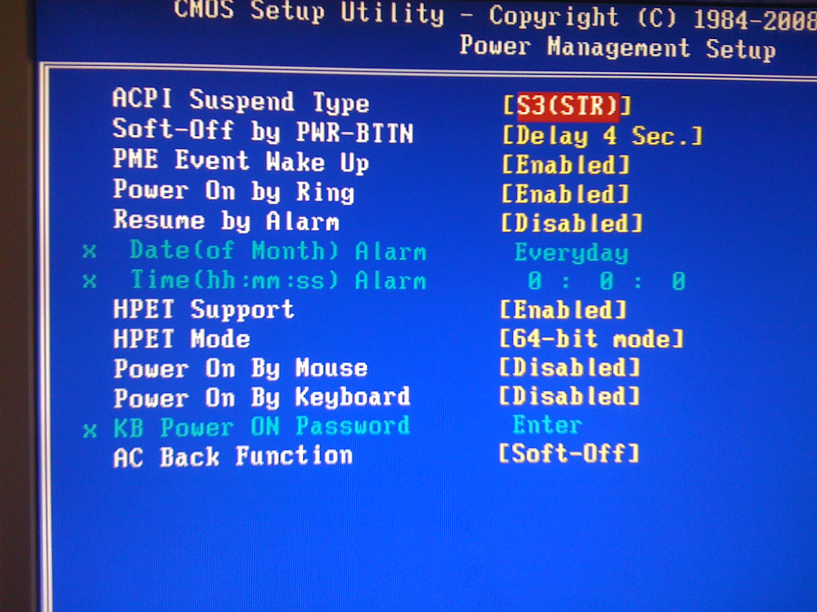

EDIT: One thing I should mention is SLEEP with S3. It does go to Sleep, and Does wake up, but once it wakes up, it locks up within seconds. No biggie though, i never got sleep working in 10.5 either (so I just set it to S1 state)

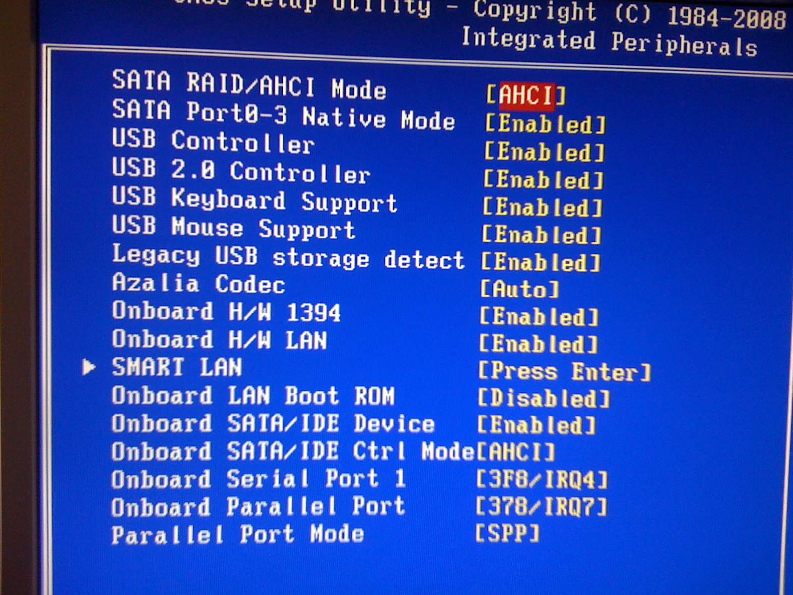

Do you have AHCI enabled in bios?
I remember mine would reboot repeatedly. I think it finally worked once I enabled AHCI!
Try that dude...should work.
Yeah, man, you're right! That worked, and I can now boot with the first CD as well. But there's another problem, which I think is something with the BIOS again. When I try to load the Retail DVD I get this error:
