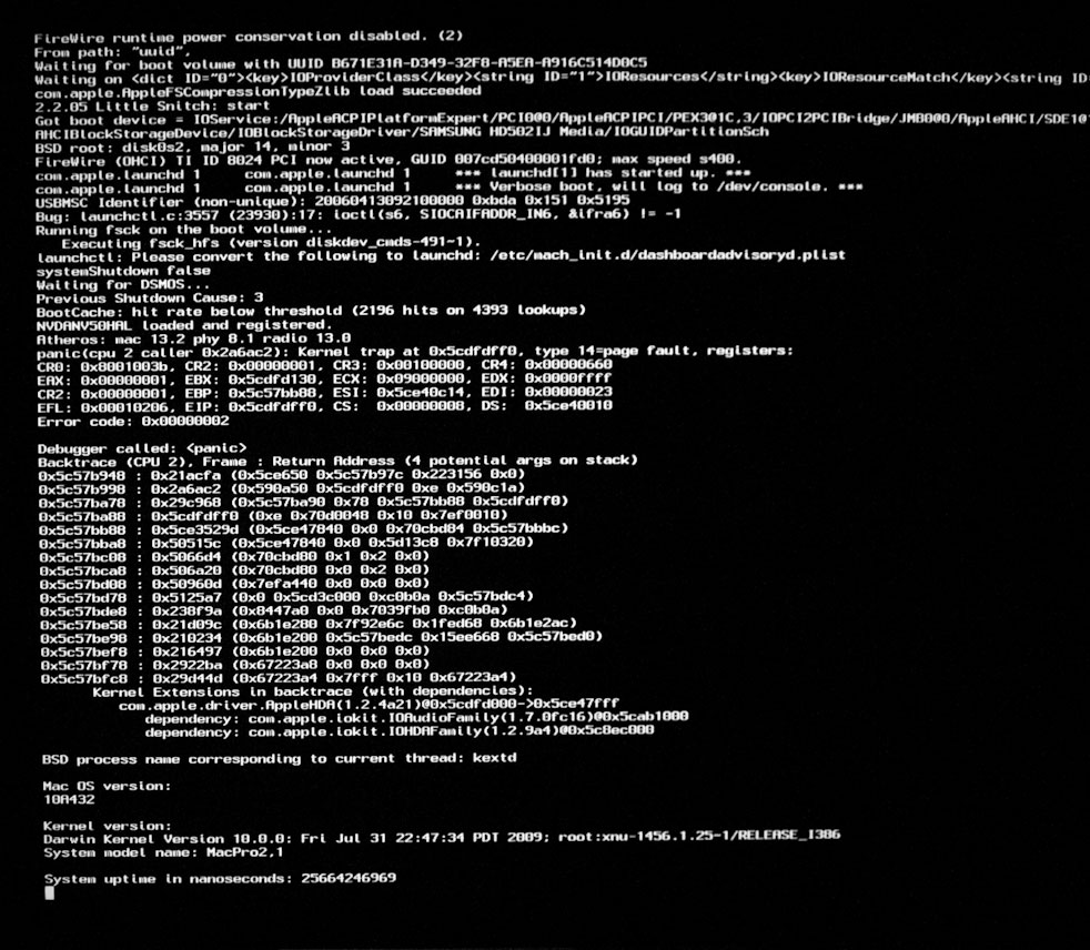

commonhh Posted December 15, 2009 Share Posted December 15, 2009 Looks like it is VoodooHDA that has some trouble, how about removing that temporarily and see what happens then Link to comment Share on other sites More sharing options...
mm67 Posted December 15, 2009 Share Posted December 15, 2009 Ok, try disabling Azalia codec from bios setup. Link to comment Share on other sites More sharing options...
commonhh Posted December 15, 2009 Share Posted December 15, 2009 Ok, try disabling Azalia codec from bios setup. yeahhhhhhhhhhhhhhh i can see airport, but cannot find any wlan-networks UPDATE writing write now in airport THANKS !!!!!!!! Link to comment Share on other sites More sharing options...
mm67 Posted December 15, 2009 Share Posted December 15, 2009 yeahhhhhhhhhhhhhhh i can see airport, but cannot find any wlan-networks UPDATE writing write now in airport THANKS !!!!!!!! You should be able to have both audio and wlan working at same time, you might want to try putting wlan card to another pci slot and see it that helps. Link to comment Share on other sites More sharing options...
commonhh Posted December 15, 2009 Share Posted December 15, 2009 You should be able to have both audio and wlan working at same time, you might want to try putting wlan card to another pci slot and see it that helps. ok i installed voodoo and not a alc889a kext do you use a alc889a kext or how did you solve your sound-onboard Link to comment Share on other sites More sharing options...
mm67 Posted December 15, 2009 Share Posted December 15, 2009 oki installed voodoo and not a alc889a kext do you use a alc889a kext or how did you solve your sound-onboard I prefer to use usb audio, but it is possible to use onboard audio also. I managed to do that by using LegacyHDA.kext or by changing layout-id of HDEF to 66. That way you don't need to use any extra kext files. Link to comment Share on other sites More sharing options...
commonhh Posted December 15, 2009 Share Posted December 15, 2009 I prefer to use usb audio, but it is possible to use onboard audio also. I managed to do that by using LegacyHDA.kext or by changing layout-id of HDEF to 66. That way you don't need to use any extra kext files. I'll try this tomorrow thanks Link to comment Share on other sites More sharing options...
