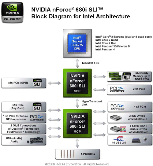

The freezing issue relates to the Southbridge 680i MCP chipset, which simultaneously controls all the I/O devices such as USB, SATA and PATA (driven by the AppleNForceATA.kext), as well as Firewire......
Hence, your Firewire audio issues.......maybe additional cooling of the Southbridge chipset would help........that is why I am suggesting you do not use Firewire for audio.......your choice however.....you can also try the MeDevil / aryajuanda AppleNForceATA.kext.....see post #1 Part K Item 4........ :(

about the firewire. its more of a cost issue in why im using it. my sound from the 410 is having no effect with osx thats y i thought it wasnt the firewire making it freeze.
but as it to do with the Southbridge 680i MCP chipset, i would get hte same with usb right?
i only ask as im using midi and phono out/inputs so i ideally need it to work. but i understand now that as its to do with my chipset. im kinda screwed.
but will try your suggestions i.e MeDevil / aryajuanda AppleNForceATA.kext and cooling as i know they will be 100% helpfull.
