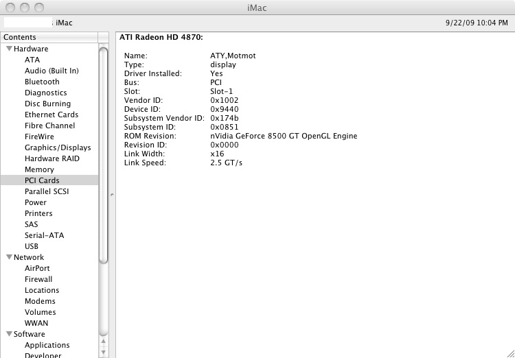

wenfengli Posted September 23, 2009 Share Posted September 23, 2009 I don't know what happened, but it shows a 8500 GT OpenGL engine on my HD4870. Does anyone else have this problem? Link to comment Share on other sites More sharing options...
