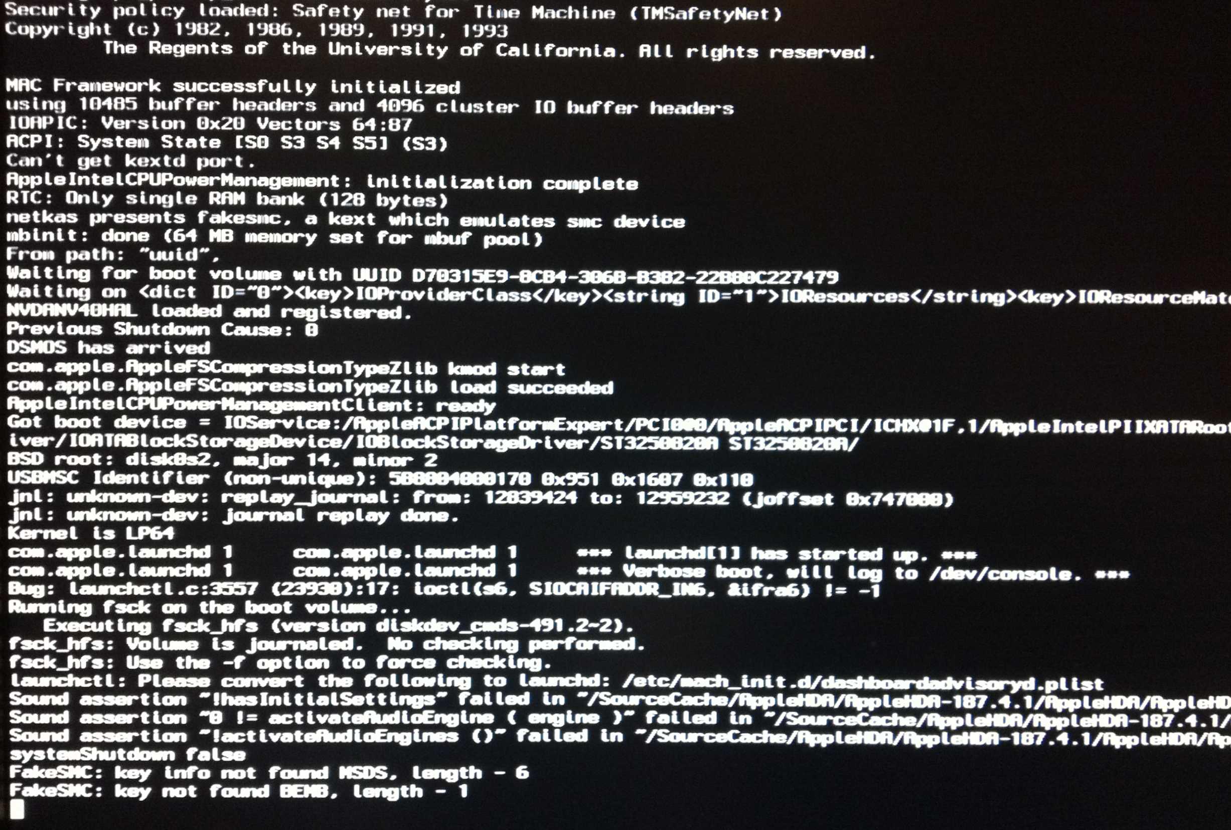

I had this almost done. I was able to boot into SL 10.6.4 on the target Hard Drive using the USB memory stick as a boot loader. I got to the step where I installed Ridgline's post installer and it killed the install. The target hard drive boots, and goes through the apple screen with the spinning circle, goes briefly through a black screen, but ends up hung on a blue screen at the end.
Any way to fix this?

Here is a screen capture. This is the last thing that happens before the blue screen of death. :)
Could this be related to the fact that my HD is IDE rather than SATA?

Looks like you are using 64-bit kernel with Geforce 7 series card, I do think that combination is not possible.

try setting everything in 32bit and check from there
dl this :
http://www.ahatfullofsky.comuv.com/English...ms/SMS/SMS.html
set up 32 bit, reboot verbose, look if it goes through
if not check if you are dvi connected (vga or dp is tricky) and use a nvinjector that's correct for your card (nvenabler)
you might also activate the 7600 thru OSX86 tools i gues it's possible
is this still doesn't work you might try a sata drive indeed (ahci)
are check another best-working graphic like the nvidia 9500GT or 8400GS

There is no need to change graphics cards or reinstall, just boot with 32-bit kernel using arch=i386.

I will, thanks. How/where do I enter "arch=i386"?

You enter it at the same place where you entered -v to boot in verbose mode.

Ok, in that case at the same time you see that menu, just start typing.
OK, when the menu came up I just typed
arch=i386<enter>
Nothing showed on the screen when I did this and the result was the same: blue screen of death. My guess is that the command was not accepted at that location, but I cannot be sure.
Well, I'll be damned. The second time it worked. Maybe a typo.
Is there a way to make that setting permanent without entering it every time?
arch=i386<enter>
Add it to com.apple.Boot.plist. Here is mine:

This is what you need:
<key>Kernel Flags</key>
<string>arch=i386</string>

THANKS A LOT! That worked perfectly. I take it that when I want to go back to 64 bit, I can just remove that string?
