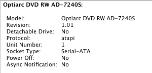

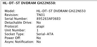

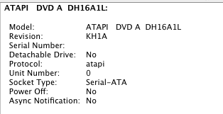

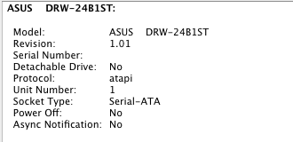

hawaii50 Posted June 6, 2010 Share Posted June 6, 2010 Ridgeline: Here are two more DVD drives. First one is an LG, the second is an ASUS. Both will prevent sleep unless there is a DVD in the drive. h50 Link to comment Share on other sites More sharing options...
