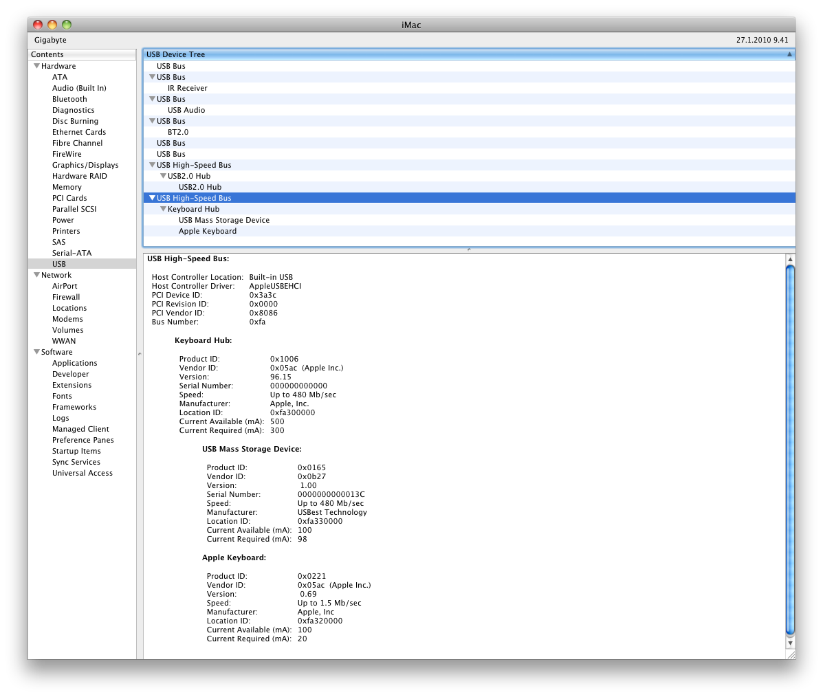

So I updated my DSDT for the newest one. It did not resolved my sleep issues. It even failed with my first attempt. Second time it was OK. Do you think it may be SpeedStep thing related ? If I understand it correctly if I use dsdt without speedstep I need to use NullCPUPowerManagement and SleepEnabler ?
And you noted that it should increase USB power. I was kinda hoping that I could use that Apple keyboard I have with stuff like USB thumb drive, but it still just reports low power :)

Yes, if you don't add your CPU data to the DSDT for stepping, then you might want to add NullCPUPowerManagement and SleepEnabler kexts back in to E/E/. Same as the default install explained in the PDF guide.
As for the USB power increase, it's probably easier if I point you to this post and ask you to read on. Look for mm67's posts.

EDIT: Well sudo setpci -s 0:1a.7 0x52.w reports for me C9C2 as it should, so I don't know why that does not work :(

EDIT: Well sudo setpci -s 0:1a.7 0x52.w reports for me C9C2 as it should, so I don't know why that does not work :hysterical:
Hopefully mm67 can lend a hand with your power issue?
My aluminium keyboard says it's capable of feeding 100 mA, that seems to be enough for some usb sticks, but most of mine won't work with so little power. I think that this has nothing to do with onboard usb power capabilities, if you look at my screenshot it says that keyboard only needs 300 mA, but it is connected to a port capable of 500 mA. Maybe someone has a similar keyboard connected to a real Mac and can verify same thing happening there also.
