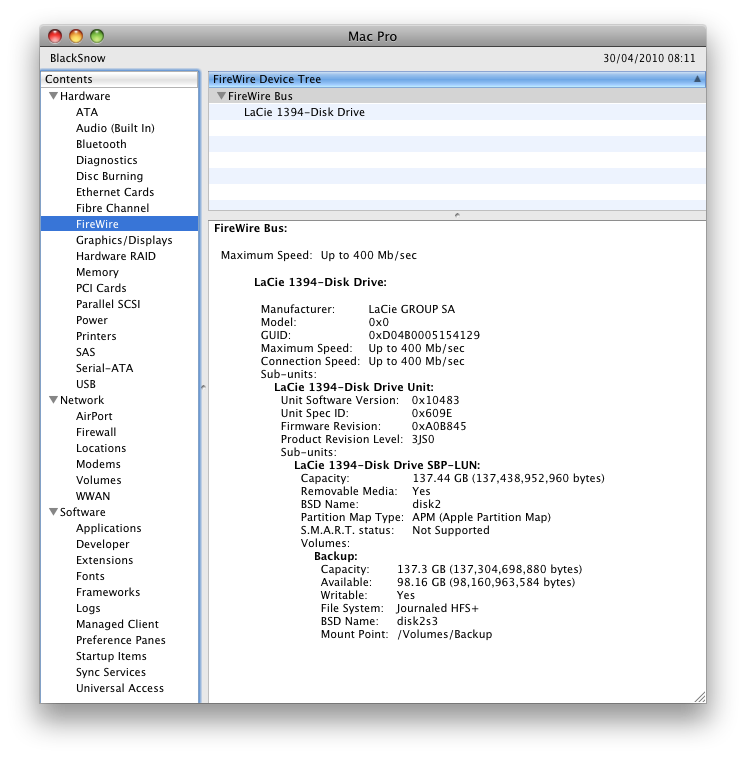

Hi all. I've followed this guide and have a 10.6.2 Mac using DSDT on the GA-EP45-DS3L. I used to have my firewire card work under 10.5.7 but haven't tried it since updating to 10.6 a while ago. It is not working now and system profiler says No Firewire ports were found. Is there a kext I need or is there a BIOS setting to change to allow for it. The two PCI slots are filled. The farthest one from the CPU has a network card. The closer one to the CPU is the firewire card. The card I am using is: hxxp://www.amazon.com/Syba-SD-VIA-FW1E1H-FireWire-9-pin-Header/dp/B00076QVM8 and again this exact computer had firewire working under 10.5.7. I would greatly appreciate any advice as I want to capture the school musical video. Chameleon Extra folder is com.apple.Boot.plist, dsdt.aml, SMBIOS.plist. The Extensions folder has fakesmc.kext, LegacyHDA.kext, NullCPUPowerManagement.kext, OpenHaltRestart.kext, OrangeIconFix.kext, OSXRestart.kext, SleepEnabler.kext.
Thank you very much in advance for any and all assistance.
Maybe just try your firewire card in the slot that your Network card is in?
I have an old Adaptec Firewire card in my hack and it works just great.
