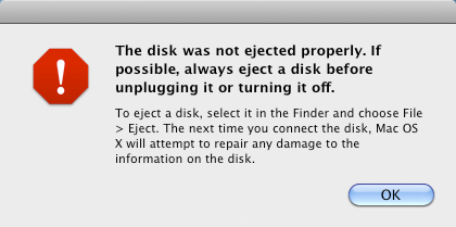

EDIT: I have done a couple of quick tests with the new DSDT.
When I put my machine to sleep, regardless of whether the 'Start up automatically after a power failure' is ticked or not, it will wake when I remove my iPhone or USB stick. I don't experience any wake-sleep loop.
If I remove my USB stick, when the system wakes up I receive the following error..
which is normal as that happens when removing the same USB stick without ejecting it.
There is no error when removing my iphone as it's designed to be unplugged without ejecting it.

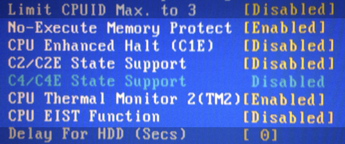

There have been some interesting developments in the FormerlyKnownAs' Speedstep thread lately and at the moment I have disabled some features in my BIOS. See attached pic.
Note: This is only for people who...
• have added P & C-states to their DSDT's for speedstep
• don't run Windows on their hacks
• haven't overclocked their systems.
Now it's turned out that the CPU EIST function can be turned off, as doing so will not allow SSDT tables to be loaded, which will result in a cleaner system. I then went on to disable C2/C2E and C4/C4E State Support with no adverse affects.
For more info you will need to read above and below my post to get an idea of what it's all about.
My CPU DSDT section is just like yours. I only changed the P-states settings for my Q9505.
I run Windows in a VMWare Fusion virtual machine.
I have no overclock.
Do you think I can disable those BIOS settings safely?
Yes, it should be okay to try.
