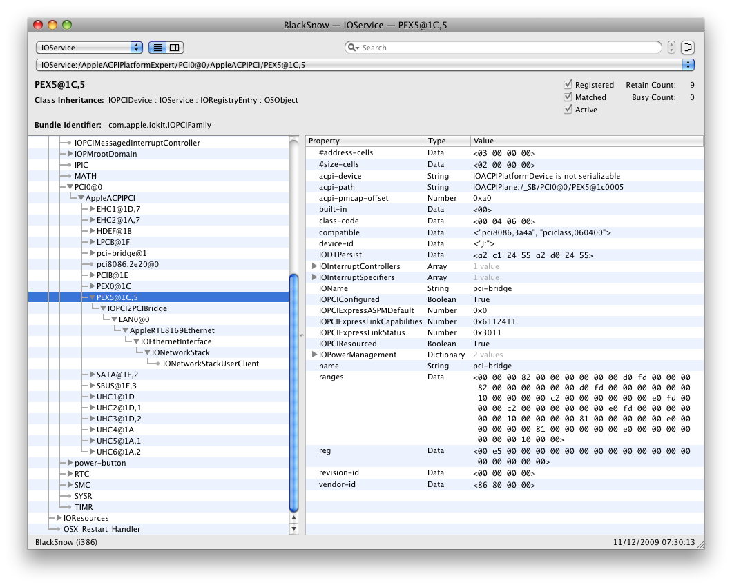

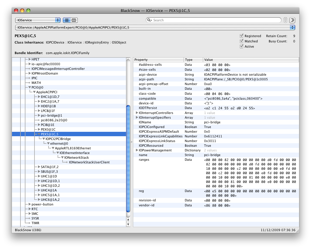

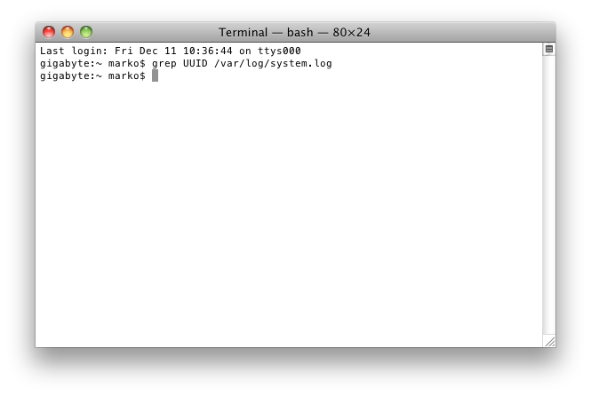

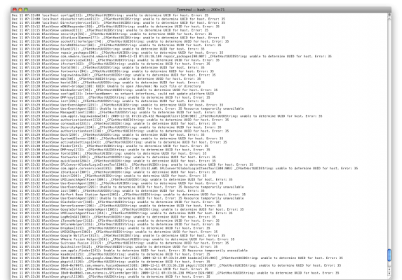

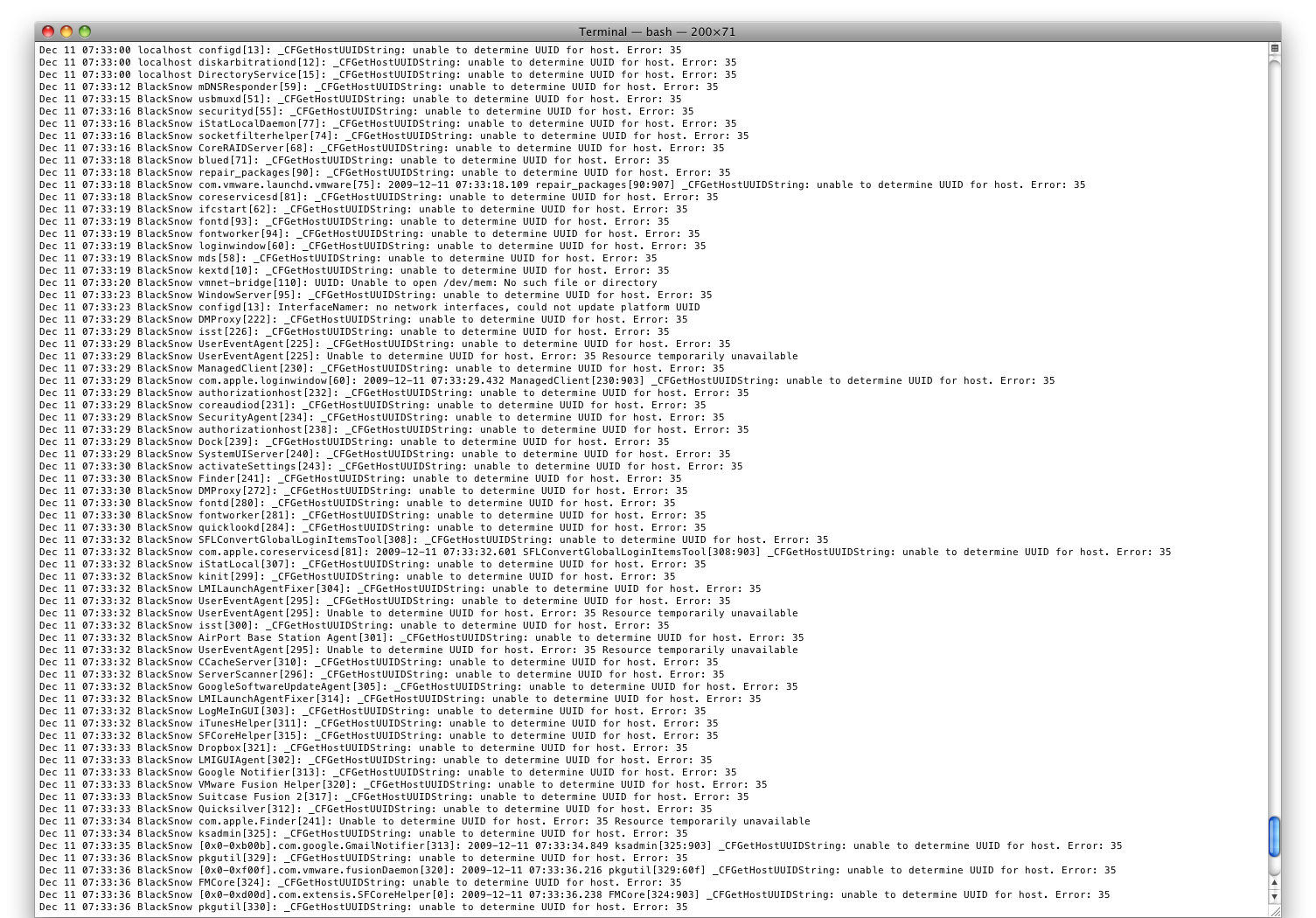

Thanks Thiago. I have tried the DSDT with the Device (LAN0) as you supplied. I did these tests using the original PC-EFI v10.5 and removed PlatformUUID.kext from /E/E and removed the SMUUID key/string from SMBIOS.plist.
I can confirm it removes lot of errors but not all of them on my system, and yes, LAN0@0 now appears in IORegistryExplorer rather than ethernet@0. I have attached some screengrabs....
First, IORegistryExplorer with and without the LAN0 device in DSDT.
Second, the result of grep UUID /var/log/system.log in Terminal with and without the LAN0 device in DSDT.

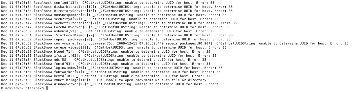

New Chameleon rc4 seems to have same UUID patch as that modified PC EFI version, no need to use UUID strings anywhere.
My list of UUID errors, which is kind of short ;)
My list of UUID errors, which is kind of short :(
