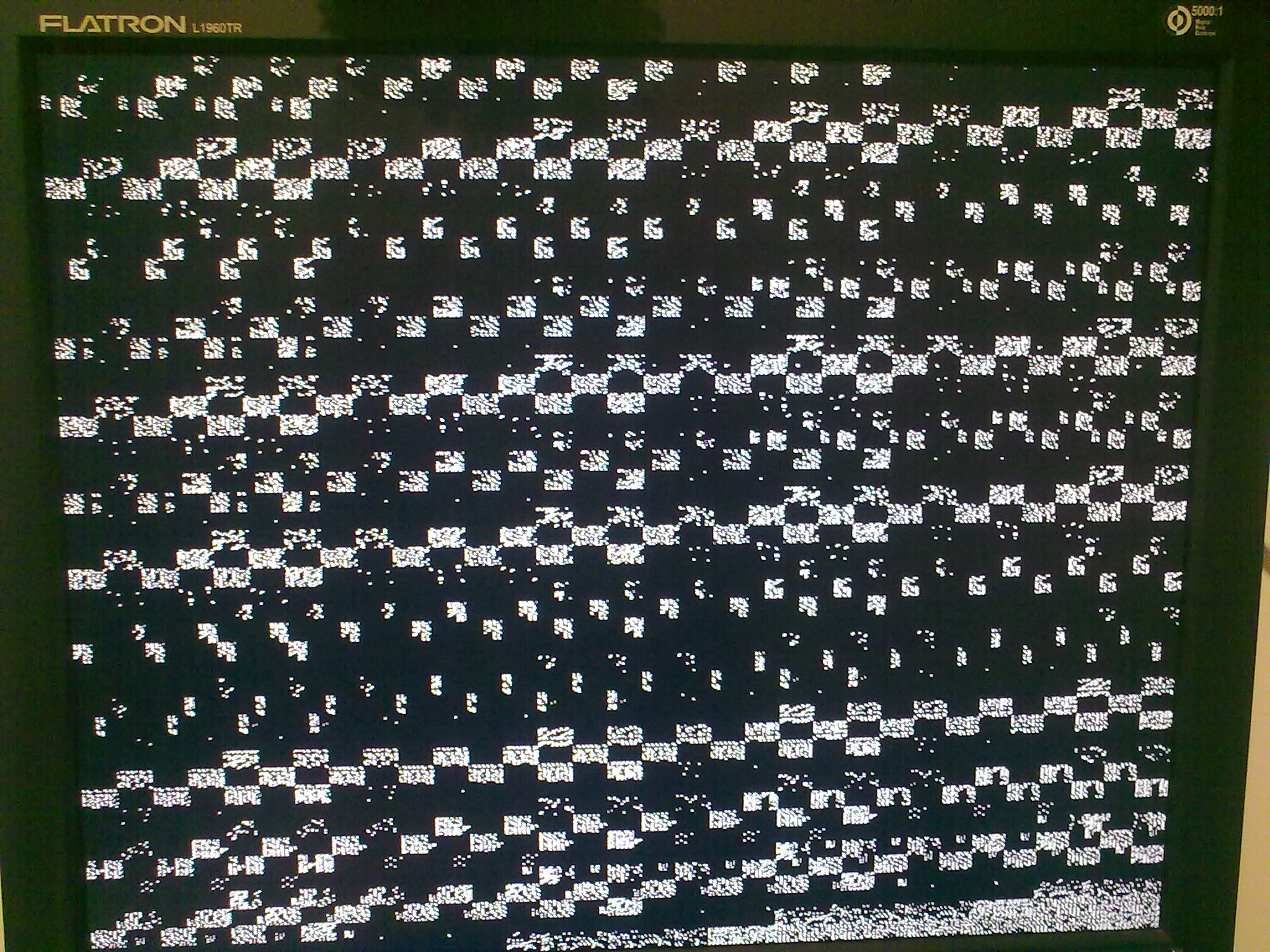

I've tried to install sl 10A432 on my gigabyte ep43-ds3l, ati 4300HD, E5200.
I had the NO HPETS error but i got passed it with some kext I've found HPETS something.
Now when my system loads up this is the screen i see after booting (screenshot attached)
http://i818.photobucket.com/albums/zz103/a...19112009014.jpg
with the -v -x32 debug=0x100.
Pls help me :rolleyes:, i want to use the retail version,
Thx

Hi All,
Pls help me :), i want to use the retail version,
Thx
It might be an issue with your ATI Video card. Have a read of this page on Netkas' site to see if it helps.

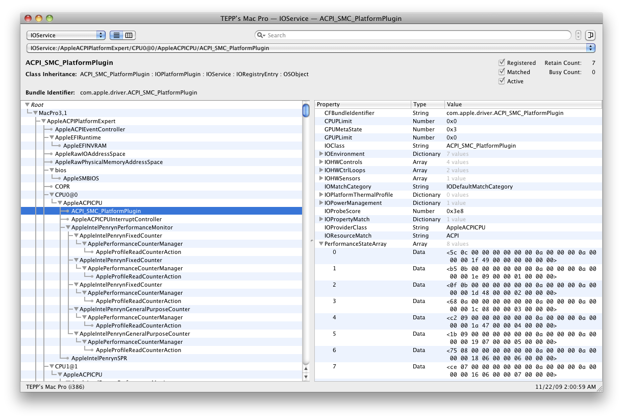

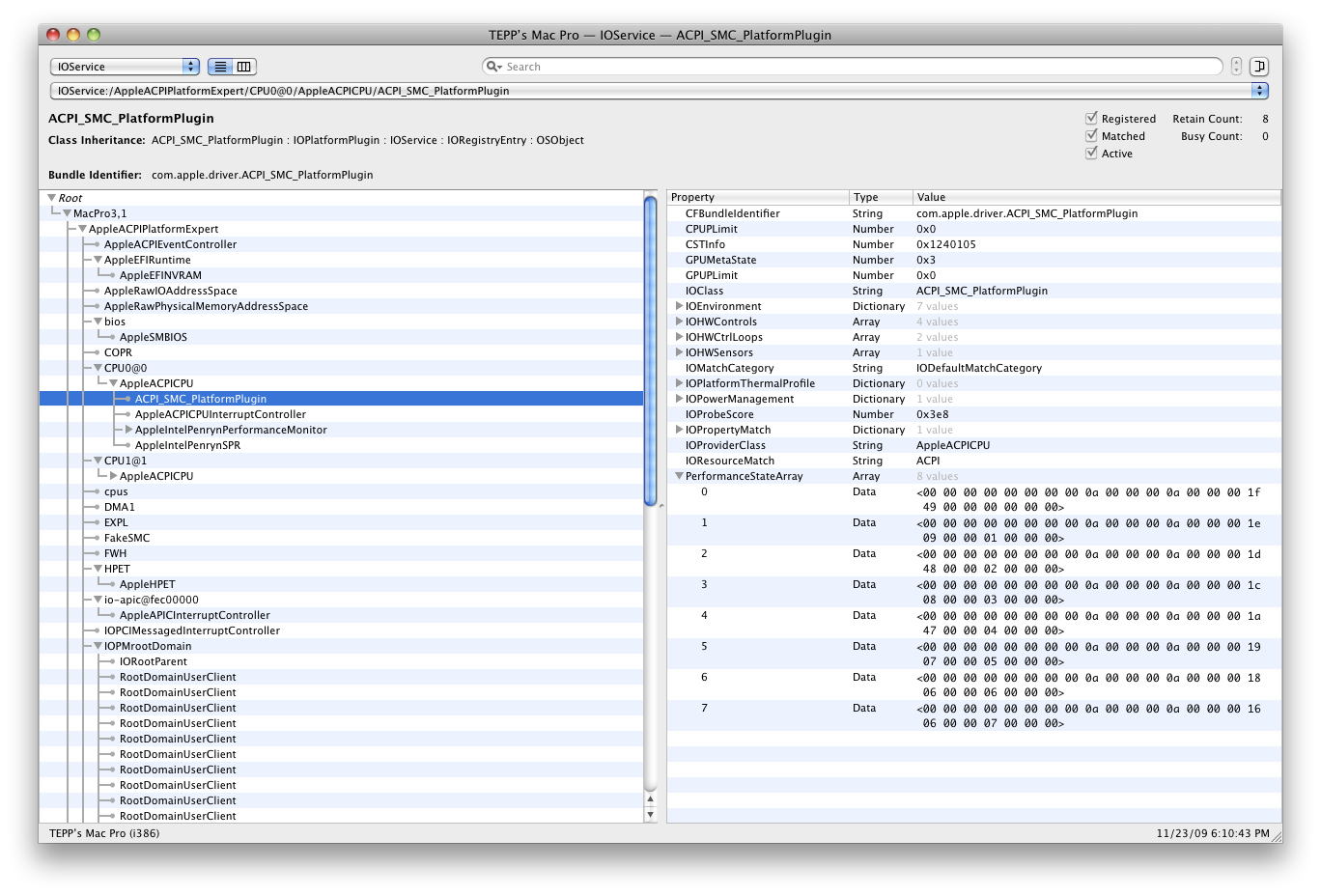

Hi blackosx,
I would like to report my DSDT w/ Vanilla SpeedStep+GFX+SATAfix+USBfix+HDEF+CMOSreset along your guide as results below:-
1) No Need NullCPUPowermanagement.kext and SleepEnable.Kext any more I have tested on SL 10.6 the Auto Sleep is OK, Waking up by Mouse/Keboard are OK, and Manual Sleep can Waking up only by press PW button. ( but 10.5 Auto Sleep and waking by mouse and Keyboard, Manual Sleep same with the previous time couldn't work )
2) In my IORegistryExplorer was not shown the CST info like yours, I didn't understand here pic as attachment.
3)Fixing Error at boot as below:
SMCACPI_SMC_PLATFOMPLUGIN:: START_waitingforservice(resourceMatching(appleIntelCPUPowerManagement) timed out
My question in item2 How to do?
But anyway I would try to find out all rest issue later.
Many thanks

Well done TEPP..
All I can tell you is what I have done for my system and you're right, the CSTinfo doesn't show in your IORegistryExplorer. Maybe double check your _CST entries your DSDT to make sure there's no obvious errors. If you can't see anything wrong then maybe have a read of FormerlyKnownAs' thread to find an answer?
For sleep. maybe there's a subtle difference between our motherboards. Have you applied the USB fixes by MasterChief from the Gigabtye DSDT fix thread?
Well done TEPP..
Remember the LPC, this is an ICH10R board.

TEPP: Can you please upload your dsdt file to any webserver (rapidshare etc.). I have the "same" MB (P45-UD3LR) and i have problem with define LPCB. Thanx for your help.
I can tell you after I added some part of Device ID of (PX40) due to our Mobo is UD3R (ICH10R) which is 3a16 with part as below:
Device (PX40)
			Name (_ADR, 0x001F0000)
				Store (Package (0x02)
						"device-id",
						Buffer (0x04)
							0x18, 0x3A, 0x00, 0x00
					}, Local0)
				Return (Local0)
			OperationRegion (PREV, PCI_Config, 0x08, One)
			Scope (\)
				Field (\_SB.PCI0.PX40.PREV, ByteAcc, NoLock, Preserve)
					REV0,   8
			OperationRegion (PIRQ, PCI_Config, 0x60, 0x04)
			Scope (\)
// remainder removed
I will get AppleLPC and ICST info was displayed in IOReg but Manual Sleep gone, so I switch to get out above part and then my Manual Sleep come again.
My Opinion at this moment I prefer to use only P-State, it can make my system run without NullCPUPowerManagement.kext and SleepEnabler.kext, but for Auto/Manual Sleep are OK for me is better because our goal is make our pc as close as real mac as possible.
You can read more at : FormerlyKnownAS's Thread
See my current DSDT as attachment:
DSDT_PX40_V1.1.dsl.zip

EP45-UD3L
C2D e7500 2930 mhz
when AppleCPUPowerManagement.kext load geekbench score just 2512
if AppleCPUPowerManagement.kext donot load geekbench score 4500
seems PState just 50% load..???
