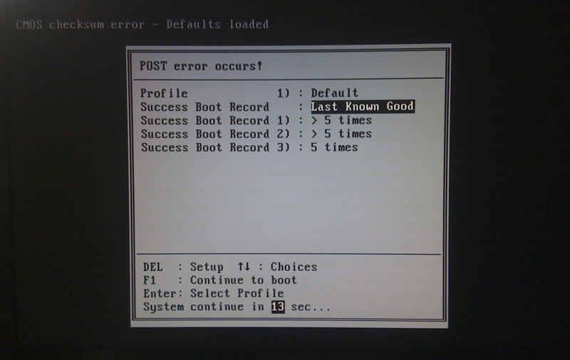

Advance notice for anyone who is wanting to use 10.6 when it's released.
SnowLeopard has introduced an annoying bug which will reset your computers’ CMOS everytime you use it. Stellarolla found a fix for this by editing the RTC section of the patched DSDT.aml. So If you have a DSDT.aml already then you are going to need to add this fix which I have explained in my thread ‘Using DSDT with the GA-EP45-DS3L’ which you will find at http://www.insanelymac.com/forum/index.php?showtopic=177497
If you don’t already have a DSDT.aml for your system them I suggest you read the above mentioned guide and build yourself one and include the CMOS reset fix.
This will save you messing around when you come to install. :P
EDIT: I have attached a photo of the CMOS Reset error given by the BIOS.
