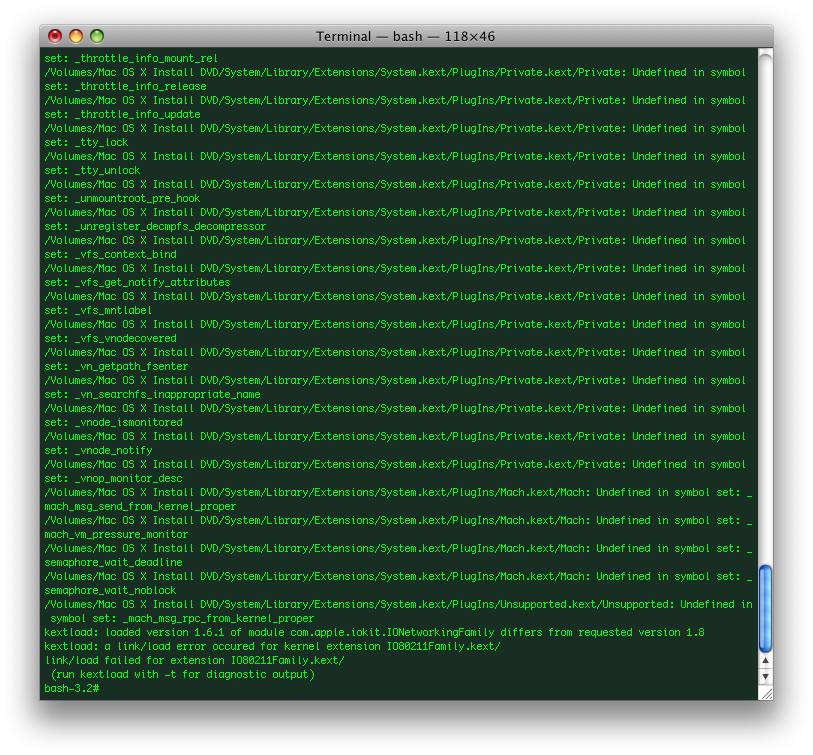

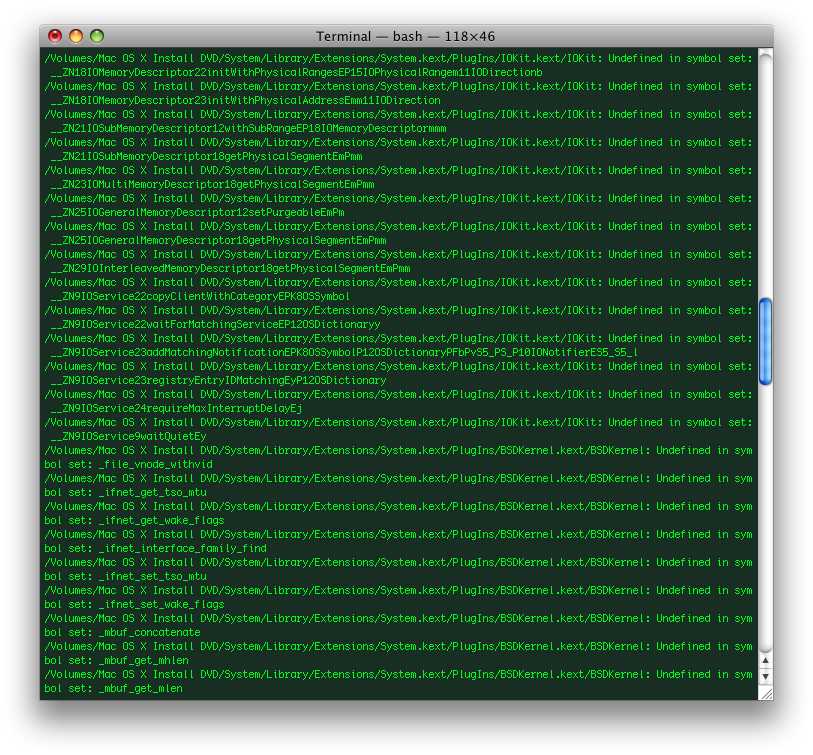

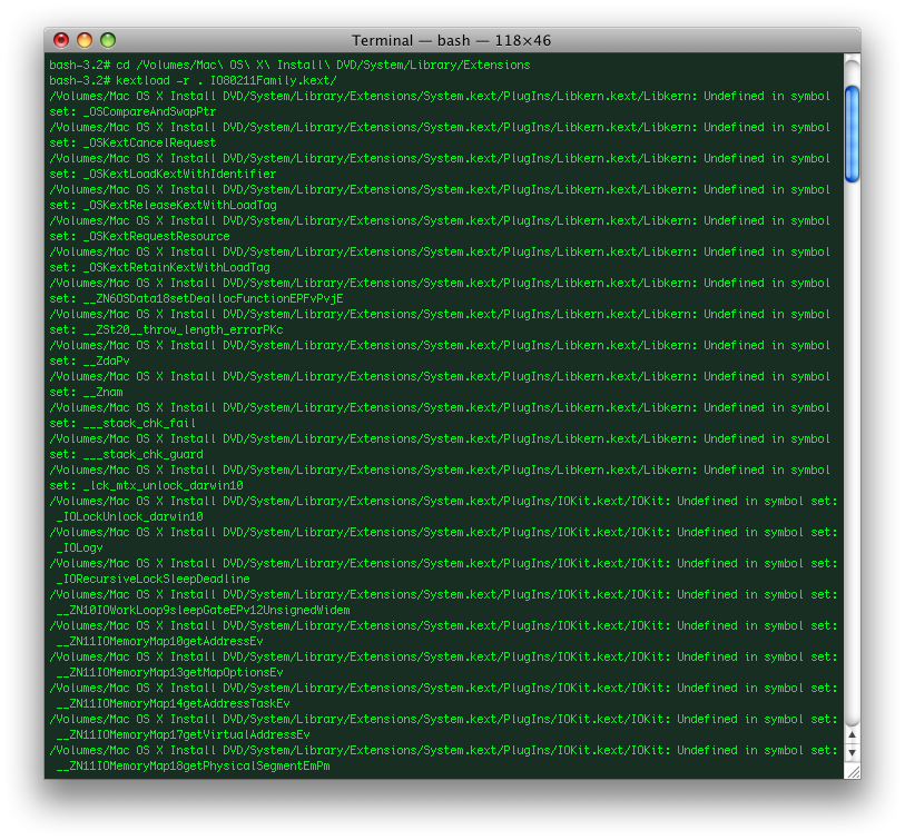

Looks like you will have to install the entirety of the Snow Leopard alpha, or wait until the final release. I tried loading the Atheros kext with /Volumes/Mac OS X Install DVD/System/Library/ set as a secondary repository for kexts, and it resolved the dependencies but none of the modules loaded due to missing kernel stuff. If you want to do this for yourself to see the errors in case you can figure something out (I doubt it) or are just curious, then do the following in a terminal.
sudo -s
cd /Volumes/Mac\ OS\ X\ Install\ DVD/System/Library/Extensions
kextload -r . IO80211Family.kext
I wish this method would work, but it looks like nothing will short of a full install of Snow Leopard. I might try doing that, but it is iffy since alpha software tends to be alpha for a reason. lol Cheers.

Test what exactly? Unless you know some sort of fancy trick, the kexts are not going to load into a Leopard kernel. Cheers.

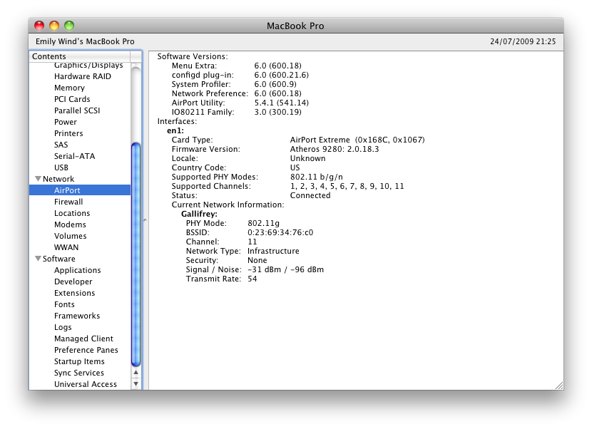

I would just like to confirm that my AR9280 does indeed work in Snow Leopard, although seemingly only in 32bit mode (with Snow Leopard 10a380 anyway). I attached a screenshot showing it working, and I will post my experiences with Snow Leopard in general as time moves on. Cheers.
